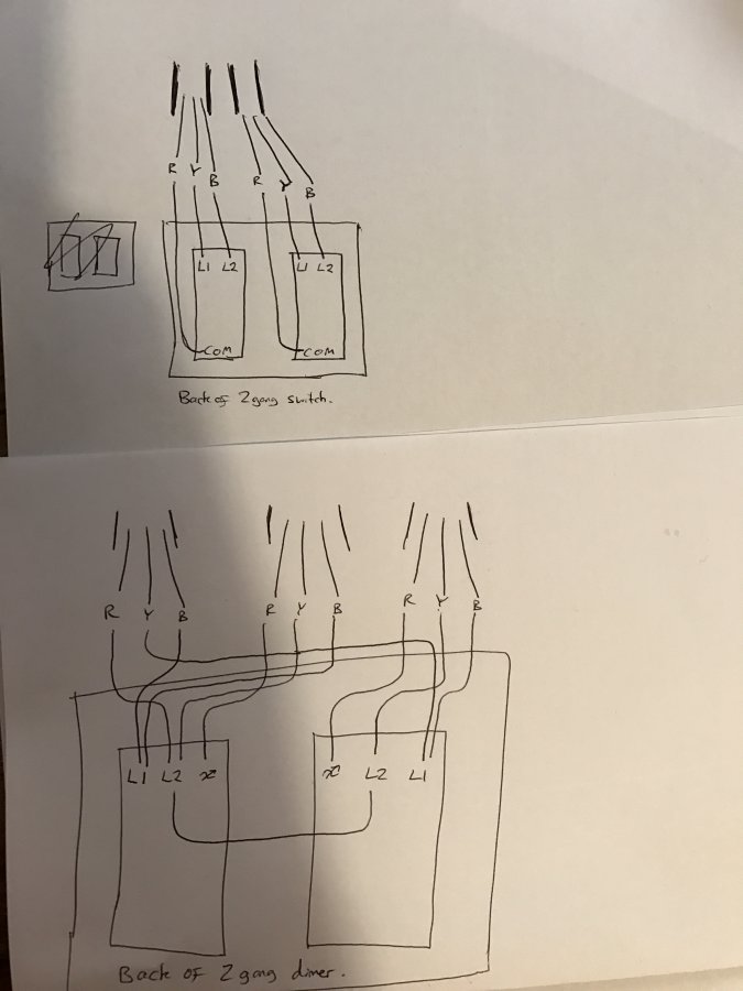

I have a two gang two way dimmer switch and two gang two way switch.
They are used to control 8 lights (4 each).
They are currently wired as shown above.
The lights operated by the left gang of the switch and the left gang of the dimmer work fine but I can't get the other 4 lights to work.
Any help or advice would be great!
Did they work before as some point? If so it is most likely the right dimmer is faulty, those MEM dimmers are very poor quality and don't last long, it looks like the other one has been replaced at some point. What lights are the dimmers controlling, it needs to be compatible with the dimmer. You should be able to swap the faulty module easily, but whatever you do, don't mix up the wiring. You must also not fit metal switch plates as your cables have all the earth conductors cut out.
Hi thanks for your reply. Yep they were both working fine a few weeks ago then I went to change the switches to new ones and couldn't get it working. I then put back in the old switches but must haven't wired them incorrectly! So I'm sure it's just a case of getting them correctly wired again!
Your diagrams "look" alright so, if dimmer is not faulty, then it can only be assumed that one of the conductors is not connecting properly or is broken.
As above your diagram would appear to work. If I was there it would be straightforward to test, but for now there are some quick checks that can be made.

If that is all good, at the dimmer switch, the side that is not working, mark the yellow wire from terminal L1 with some tape or similar so you don't forget it. Disconnect this marked yellow wire and connect it in with the 2 wires in L2, tighten terminals L1 and L2. Switch the electricity back on, the lights that didn't work before should now be on permanently. If they are on, then either the dimmer is faulty or the switch at the other end.

Thanks for the advice. I have done that and the lights that previously did not work now remain on permanently. I can use the dimmer and the switch for the other set of four lights, but oddly I need to use the right switch now to turn them on/off instead of the left switch.
So this confirms both the switches work fine at that end. I also changed some wired to confirm that both dimmers also work so I'm sure it's just maybe one or two cables that are incorrect.
