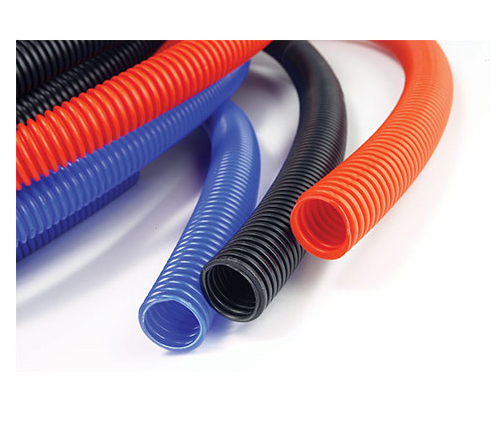

Yes, it is, when the pipe ends are not able to move a few millimetres to allow the pipe to expand an contract the strain on joints can over time create leaks. For example elbows at the end of long straight runs with the vertical pipes held rigidly by the screed will not allow for expansion and contraction.
Where did you google that nonsense from, Bernie?
