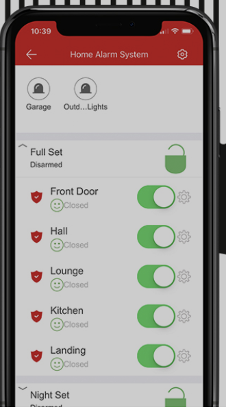

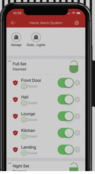

Hi,
When I look at screenshots of ProControl+ on the Pyronix website it looks like you can disable individual inputs via the app.
However this option is not available to me on my iPhone.
Is it possible ? and if so how do I setup my system to enable it ?
Simon
if the zone is omittable then it should be possible to omit the zone in the app.
So firstly check the zone is omittable, then check on how to omit zones using the app.
Like secure I am said they need to be set as omittable out the box they are not, you need to go into change inputs then its in attributes.
