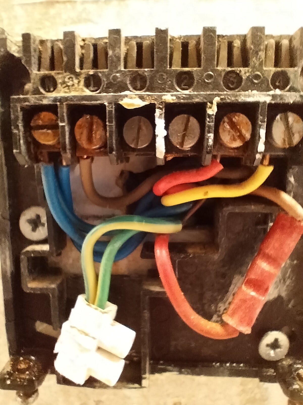

As the mains power had been cut, the 3 port valve was sat in the HW mode. I set a demand temperature for the CH and the port only moved to mid way, circulating both CH and HW.
One thing to note is that the wiring in the programmer backplate is missing wires on 1 and 2, also, there is a looped and joined wire within it...
I seem to remember being told that you can't have CH on without HW.
Therefore, I've reset it back to gravity which prevents my noted issue and left it in manual mode on. I like the ability to for the CH to kick in during colder mornings but the HW kicks in too, which is more than the colder mornings. Hope this makes sense.
It's possible the 3 port valve has been wired incorrectly (if you've never had the full functionality of the system). Pics of the wiring centre (isolate before removing cover) might be helpful also
Thanks for the replies, I will try and post a photo of the airing cupboard later. For info, the pump is in the boiler, the original was removed from the airing cupboard when the Remeha Avanta was installed.
I've attached the programmer backplate which needed to be swapped as water ingress had rusted the screws, I ensured it was wired the same.

You say it has a 3-port valve?
Some programmers have a switch or wiring option for "gravity or fully pumped."
I wonder if yours has mistakenly been left on "gravity"
BTW if you are replacing the programmer, you may find it helpful to run all the wrong into a "wiring centre"
Makes it easier to see and check how it's done, and you can test across the terminals to see what's on.

From what I gather reading your posts you have a pumped system that you have incorrectly configured as a gravity system to get around an issue. I think you should configure the system correctly and then investigate where the issue is.
You won't be able to have CH on on it's own on a Y plan system without a wire from terminal 1 connected to the grey wire on the 3 port valve!

As Johnmdc states, I don't have a wire on terminal 1, therefore I will abandon this and just leave it in manual on for both HW and CH and look into it when I need to replace the boiler and will probably end up with a combi as there's only two of us, we don't use the bath and have an electric shower.
