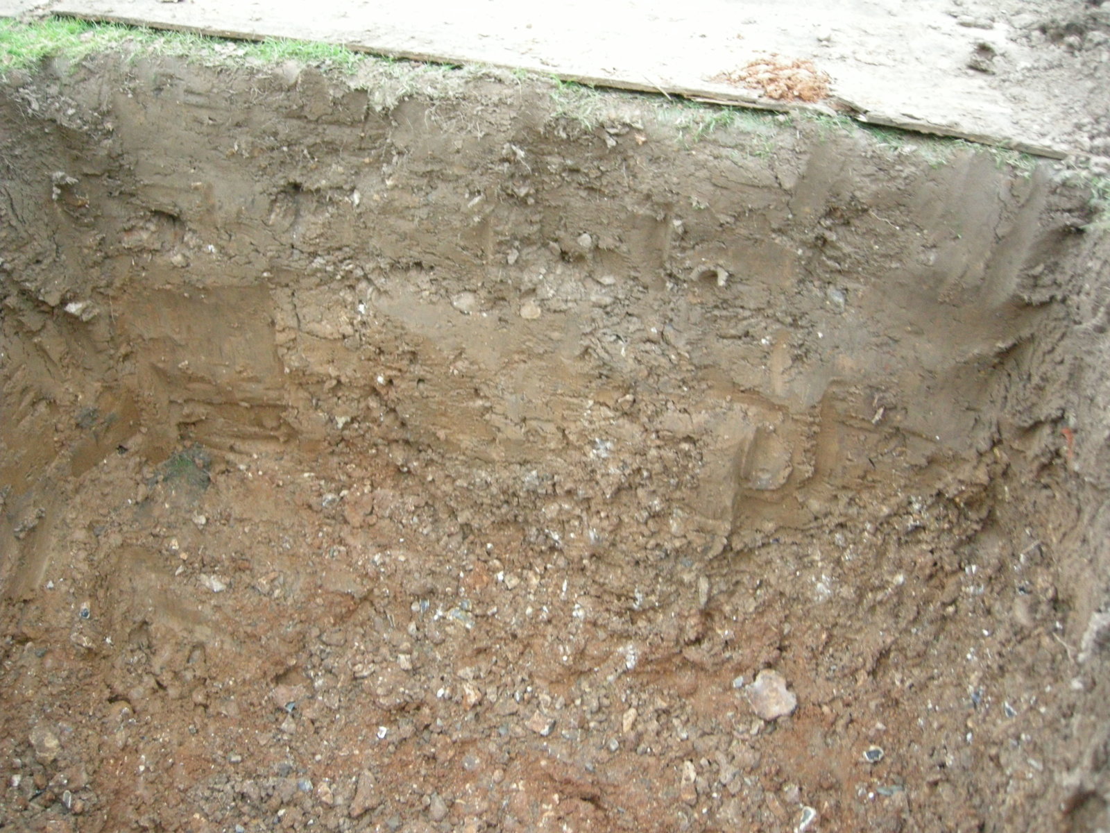

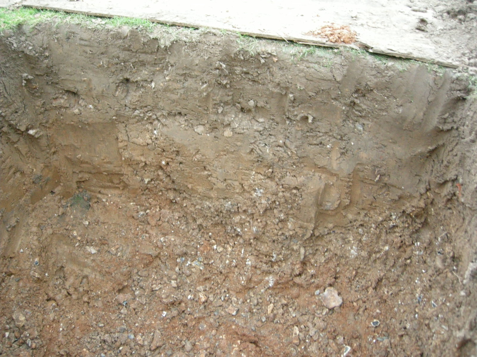

Just out interest people, does the soil composition in the attached photo look like the type of soil that would promote draining through it or prevent draining through it?

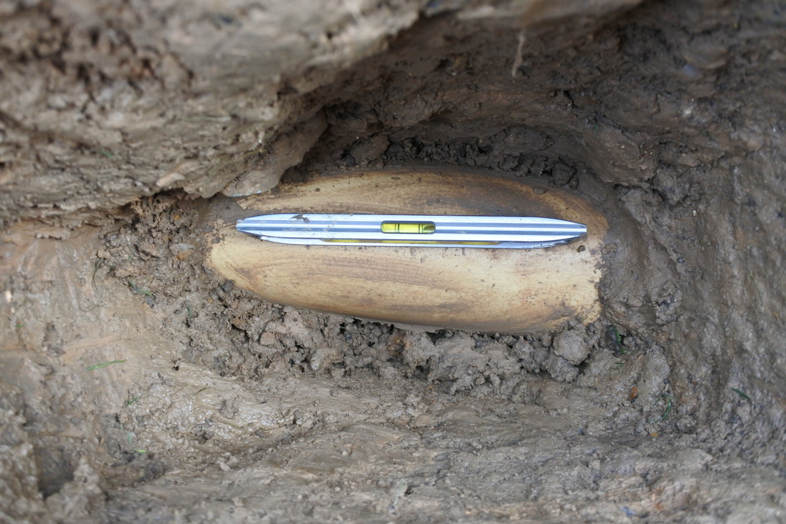

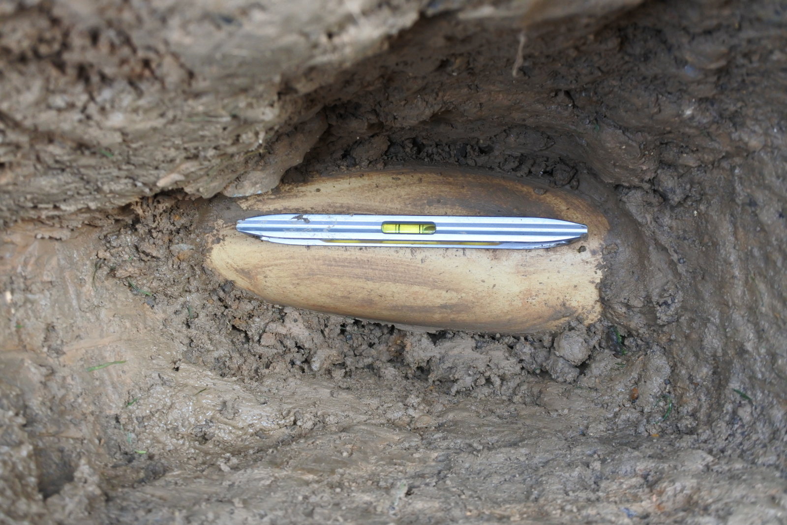

Today I started prodding my garden with a steel pole to try to identifiy any underground pipework. I identified what I believed to be pipework (which ran from the gutter downpipe to the position of the soakaway shown on my house plans) got a spade out and dug down into the grass. At around 16 inches under the grass I found a pipe that I have shown in the attached photo. It was difficult to measure but it seemed to be around 120mm in diameter and was made of a material which was not plastic but sort of beige in colour. Importantly, its gradient fell when travelling from the gutter downpipe to the area where I believe the soakaway to be.
When I alllowed water to flow down the gutter downpipe (which goes into the soakaway) I could not hear water passing through the underground pipe but when the downpipe started to fill up or back up with water the earth surrounding the underground pipe gradually started to seep out water.
I would appreciate thoughts on whether this appears to be a soakaway pipe. There is nothing on site to suggest it isn't. The gas and electric services are not thought to be in this area, nor is the cold water feed

Its a clay 110mm pipe which was used for rainwater and foul pipe runs.
You could try a percolation test to see if your soil is porous.
If the water is backing up its likely the pipe and or the soakaway is silted up.

That looks very much like the clay 'Hepsleve' pipe of that era, so I would hazard a guess you have found the rainwater drain. Plastic underground drainage was still in it's infancy I think in the 60's, clayware would have been more commonly used. Given this pipe was/is for rainwater drainage, there would have been no requirement for it to be trapped at the bottom of the downpipe, most likely the downpipe goes into a 4" clayware bend, before continuing across your garden to the soakaway.
To determine if the ground is suitable for a soakaway, carry out a percolation test as described. https://www.wte-ltd.co.uk/percolation_test.html
