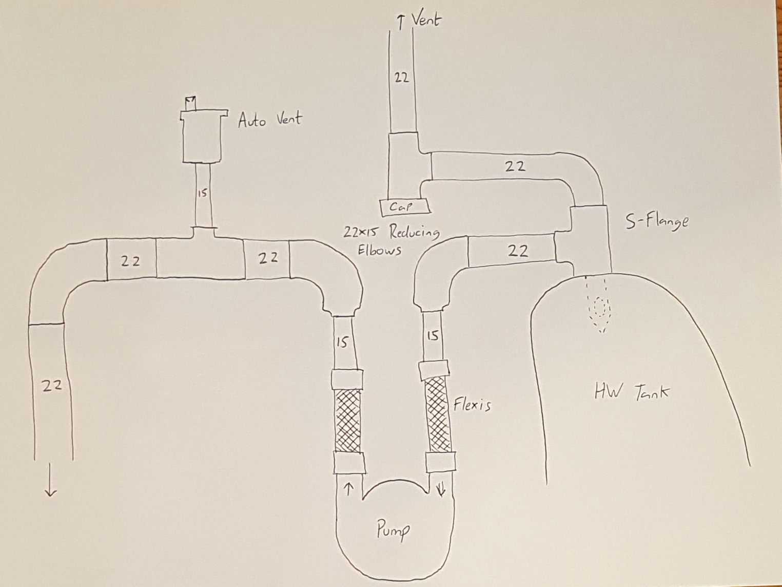

First let me set the scene. Large bungalow with a standard gravity fed HW system heated by an oil fired boiler. Mains water pressure into the property is excellent, and both showers are electric units fed straight off the mains.
The problem being poor flow rate on every hot water outlet. Kitchen sink closes to the HW tank gives out 3.3L/min, and old washing machine outlet at ankle level in the garage manages 5L/min. Bathtub tap is 4L/min which means it never gets used. Mixer taps on the sinks are a nightmare to use due to the imbalance of pressure, and the cold can easily backflow down the hot pipes away from the taps.
CW tank head height is about 4m from floor level and feeds the HW tank through a 22mm pipe (which from what I've head is smaller than recommended, but I'm not prepared to doss about changing it). Visible outlet pipework is 22mm too, I'm not sure where abouts under the floor boards it steps down.
So the plan involves fitting a Salamander CT55+ pump on the outlet of the HW tank to feed the kitchen sink, two bathroom sinks, and a single bathtub. So I'm here for a quick sanity check that this is the right solution, and I'm going about it in the right way.
So as shown in my doodle, fit an S-Flange to the tank, disconnect and cap off the current outlet pipe leaving just the vent, reduce the 22mm outlet of the S-flange to 15mm to accept the flexis that come with the pump, increase the pipe back up to 22mm after the pump, reconnect to the outlet pipe running off to the taps, and tee an auto vent on the bend.

Is there anything I'm overlooking or missing?
Also I'm aware that the "15mm" flexis that come with the pump will have a tiny bore. If I were to preemptively bin the warranty card, what would be the downside of running 15mm plastic pipe straight to the pump? (obviously straight and strain relieved) I could easily live with increased noise if it had a noticeably better flow rate.

yup +1, looks ok and would also recommend the ST pump but the salamander will be fine I'm sure.
Are you taking the hot water distribution pipe up higher than the HW cylinder and then back down hence the Auto Air Vent (aav)? I would be careful using an aav though, auto air vents have a habit of leaking longer term and can cause the pump to pulse, I'd just use a manual air vent and it should only need to be used for the commissioning.
Bin the AAV...if the pipeworks going up and over stick a manual vent on...aavs alway leak.
Regenerative (peripheral) pumps are better if you're just going to lash up the install...they cope better with air ingress than a centrifugal pump.
I'm no fan of Salamander...the impellers are not re-enforced and will melt with an immersion heater stat/cylinder stat failure.
Impeller pick up on the casing...
Thanks all. Point taken about the AAV, will pop a manual on instead.
The immersion heater on the tank isn't connected at the moment, so I'm not too worried about things getting too hot :)
