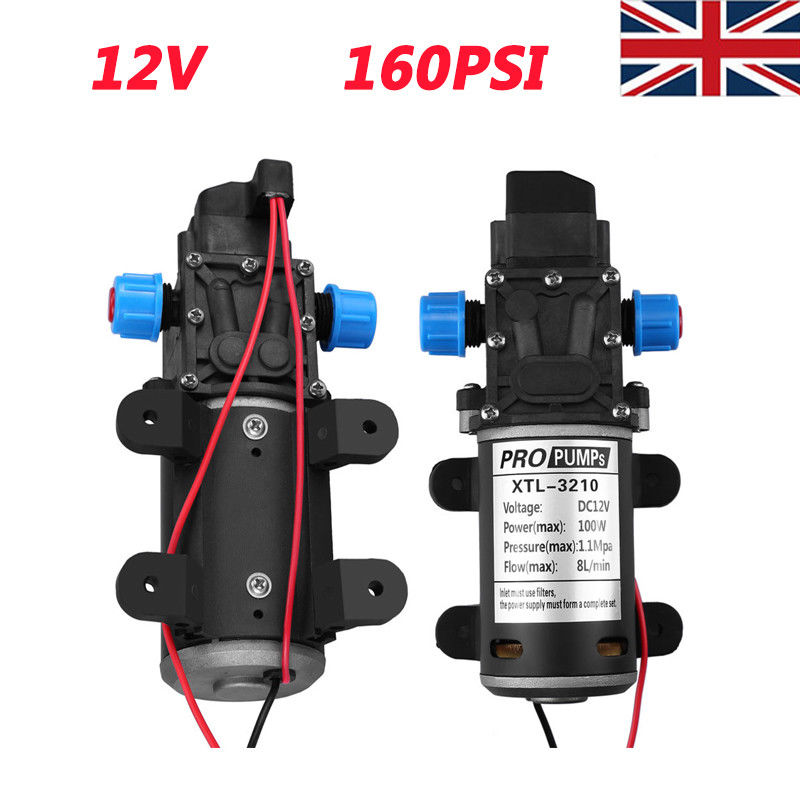

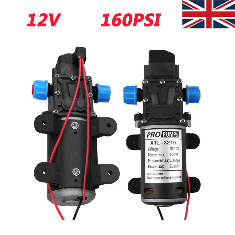

Hi all,
So, basically I have a h/w combi cylinder that isn't giving me quite enough flow in my flat and I want to put a pump in. Bath takes an hour to fill (electric shower is used instead) even the kitchen sink and the basin give 2 l/m which is just useless. I've been thinking about pumps and obviously I know 'you can't pump a combi cylinder' as it runs dry.
However, I had a thought yesterday. On our boat and also in my converted van I use 12v pumps that pump around 6 l/m. I thought could I apply this in my flat? My combi tank has a 15 litre cold tank and recovers at around 7/8 l/m with the kitchen cold tap on full and closer to 10 with no taps open, therefore in theory tank will never run dry..

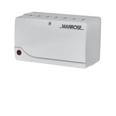

Next issue is going from 12v to 240 mains.. I have some 12v transformers knocking around from installing 12v extractors in bathrooms so I figured I could wire it through this. I've searched lots of forums to find any info on this. What I'm basically hoping someone can help me with is a, has anyone tried this and did it work? and b, in terms of regulations am I in serious breach electrically or with water regs? Or is this something that would be acceptable just very uncommon?
I've attached a picture of the pump and also the transformer I would like to use. Any advice or knowledge would be greatly appreciated
They can be pumped, but only at a very low flow rate.
The 12V pump will not work with a fan transformer, the pump in the picture is 100W, so would need at least 8 amps. Fans are typically around 20W, or less than 2 amps.
This transformer: https://www.tlc-direct.co.uk/Products/LTWP100.html may just about do.
However with the cost of that and the pump probably better to just fit a cheapo mains voltage shower pump with flow restrictors on the outlet to limit the flow to less than the refill rate. Obviously any warranty won't apply, but the same applies to the 12V one.
As above, you can install a standard mains shower pump, use it to pump both the hot and cold feeds from the combi cylinder. BES (BES.co.uk) do a range of full bore 15mm isolators that take flow restrictors, so if your refill rate for your combi tank is 8 litre/minute then you can safely install 4 or 6 litre/minute flow limiters to hot and cold low pressure supplies (i.e. the outlets from the pump) with little risk of the header tank running dry.
Can you accommodate a pump running when someone flushes a toilet at 1am? That's the downside of pumping the hot and cold.
