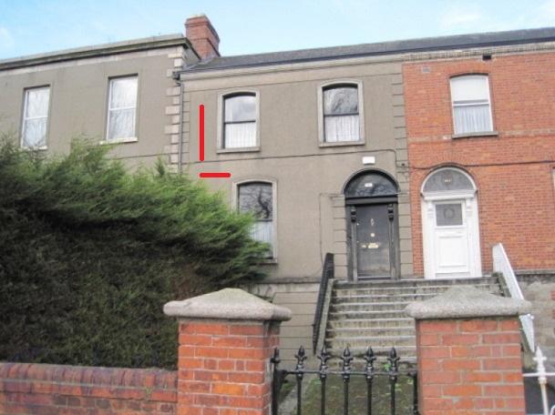

At the moment the original sash windows are installed and there is no central heating system bar a few electrical storage heaters. What are the experience's in keeping these houses at a comfortable temperature?
I note some cracking in the outside render shown by the red lines in the attached picture. Obviously we would have this assessed by a surveyor but how does one know what is serious when taking a first look?

The thng about Victorian housing is they were built before building regs and so there is no set standard fr how a house should be built.
some of the common issues I have come across are:
Timber elements in external walls may have moved / be rotten this can include timber lintols and joist ends.
Has the roof been upgraded? Chances are your roof is a cold roof pop your head up there and make sure there is felt in place and make sure its not damaged.
Gutters, Often the victorian terrace will have a timber gutter that will rot over time causing damp internally, these arent the most expensive things to replace nore are they hard to maintain but worth checking.
Owning an older house does mean that when it comes to improving the insualtion it may require you to bear in mind that the structure will need to breathe and so fixing shees of kingspan to your walls is going to cause you some issues later down the line.
But the biggest thing I would be on the look out for is Previous DIY... what have the previous owners done to the property over the past 150 Years? dodgy wiring, millions of holes drilled through the external walls in stupid places?
Chances are when your going round for every bit of dodgy work you see there will be 20 you dont see...
But provided you look after the house in a way that is sympathetic to the way it was originally built you`ll have a good solid home.
