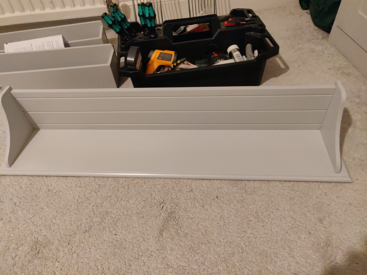

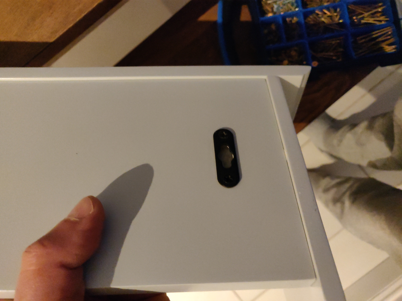

Hi
I have some shelves to put up, that haven't come with any fittings/screws etc or fitting instructions.
Here is a picture of one end. The other end has the same thing.
How would I put this up? The wall is in the bedroom and it's an exterior wall - brick.
I have a variety of screws and plugs, but are brackets required, and if so, what type?
Thanks.
From what I can see there, you’ll need a spirit level to get the shelf completely horizontal, and get someone to mark through those elongated holes with a pencil. Then drill 6mm holes with a masonry bit and hammer drill, insert a 6mm plastic plug and screw the things up.
Give us a shot of the complete unit though first!

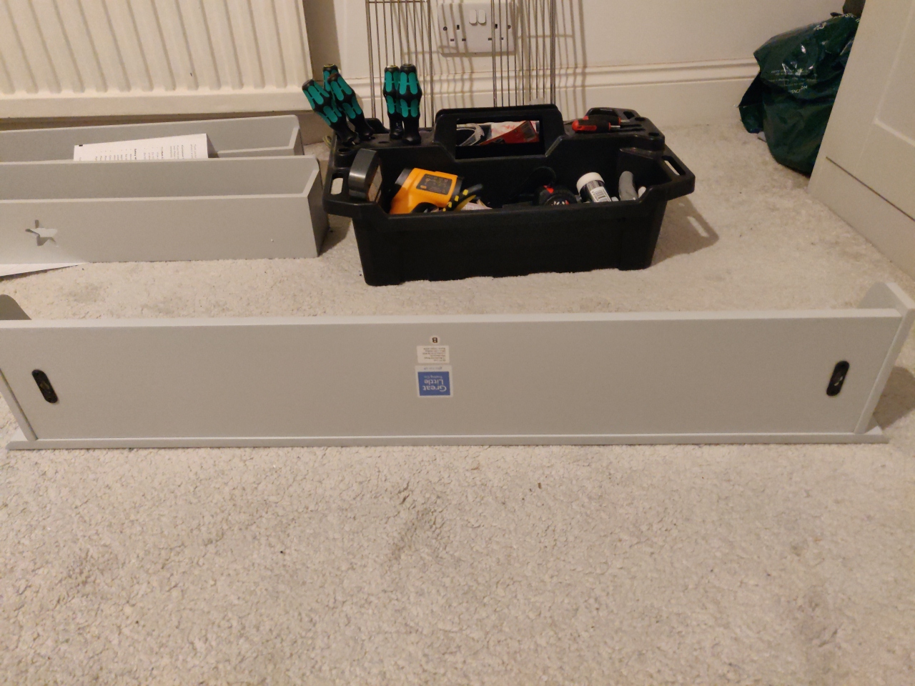

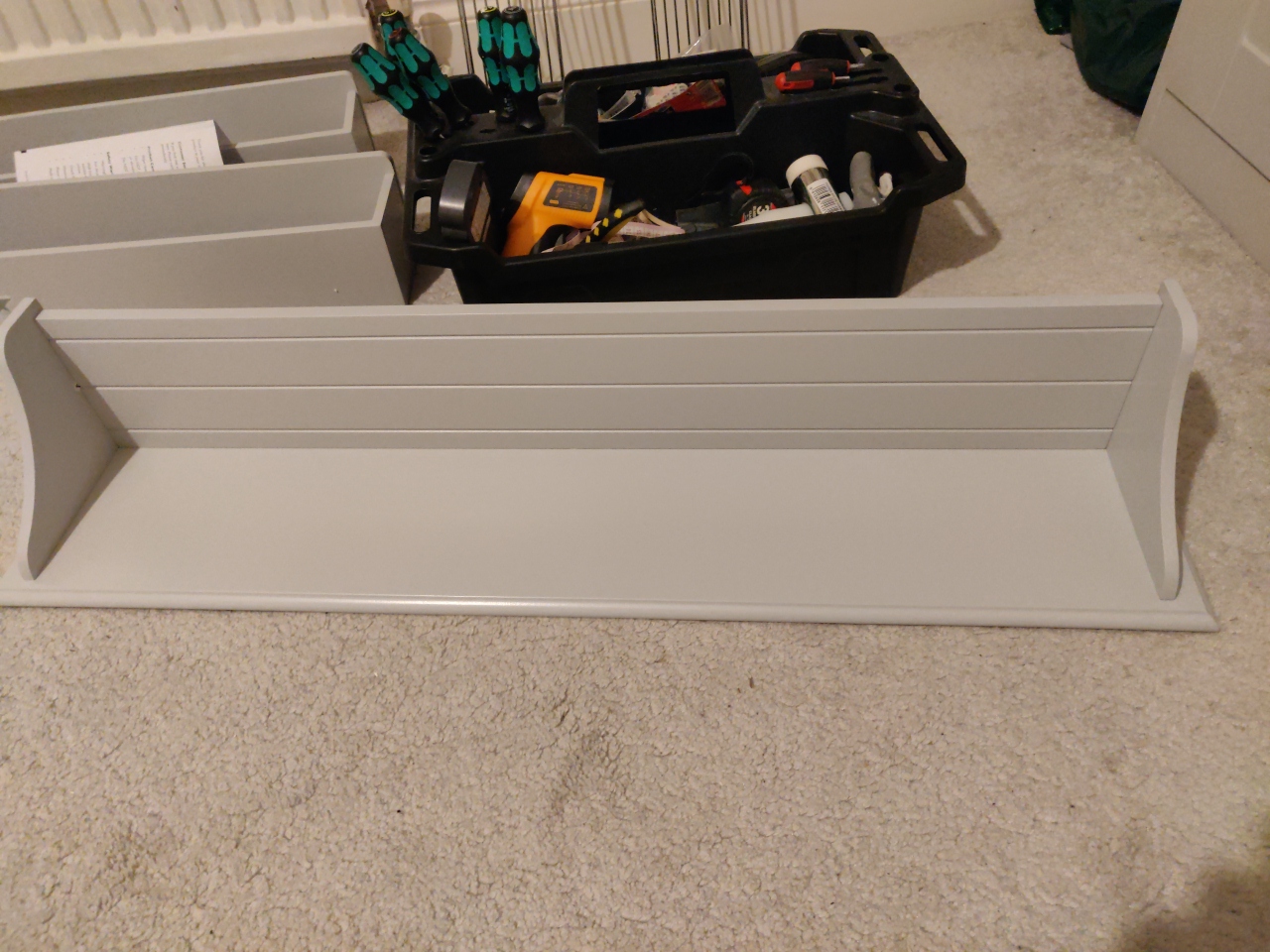

Thanks John, much appreciated. Here are photos of the front and the back of the shelf. The pencil and drilling parts are no problem, but I'm failing to grasp how the shelf attaches to the wall!
Hard to see on the picture but those black items on the back should have a slot that terminates in a hole.
You could drill and screw into the wall, both holes level.
The holes would be spaced exactly the same distance apart as the slots
Then offer up the shelf so the hole allows the screwhead to enter and slide the shelf down.

Thanks Tigercubrider. That's what I thought initially. Essentially the shelf would be resting on the screwhead. It just doesn't feel like the most secure way. Maybe it is though.

Those black plastic inserts have a keyhole type of slot, so a screw either passes right through or you ‘hook it on ‘.
John :)
John :)
They are keyholes, so the OP will need to ensure the screw heads will fit in the hole, yet be big enough in the slot. The distance between the fixings will need to be drilled very accurately too - it's also bound to be a lot of fun hooking the shelf onto the screw heads.
