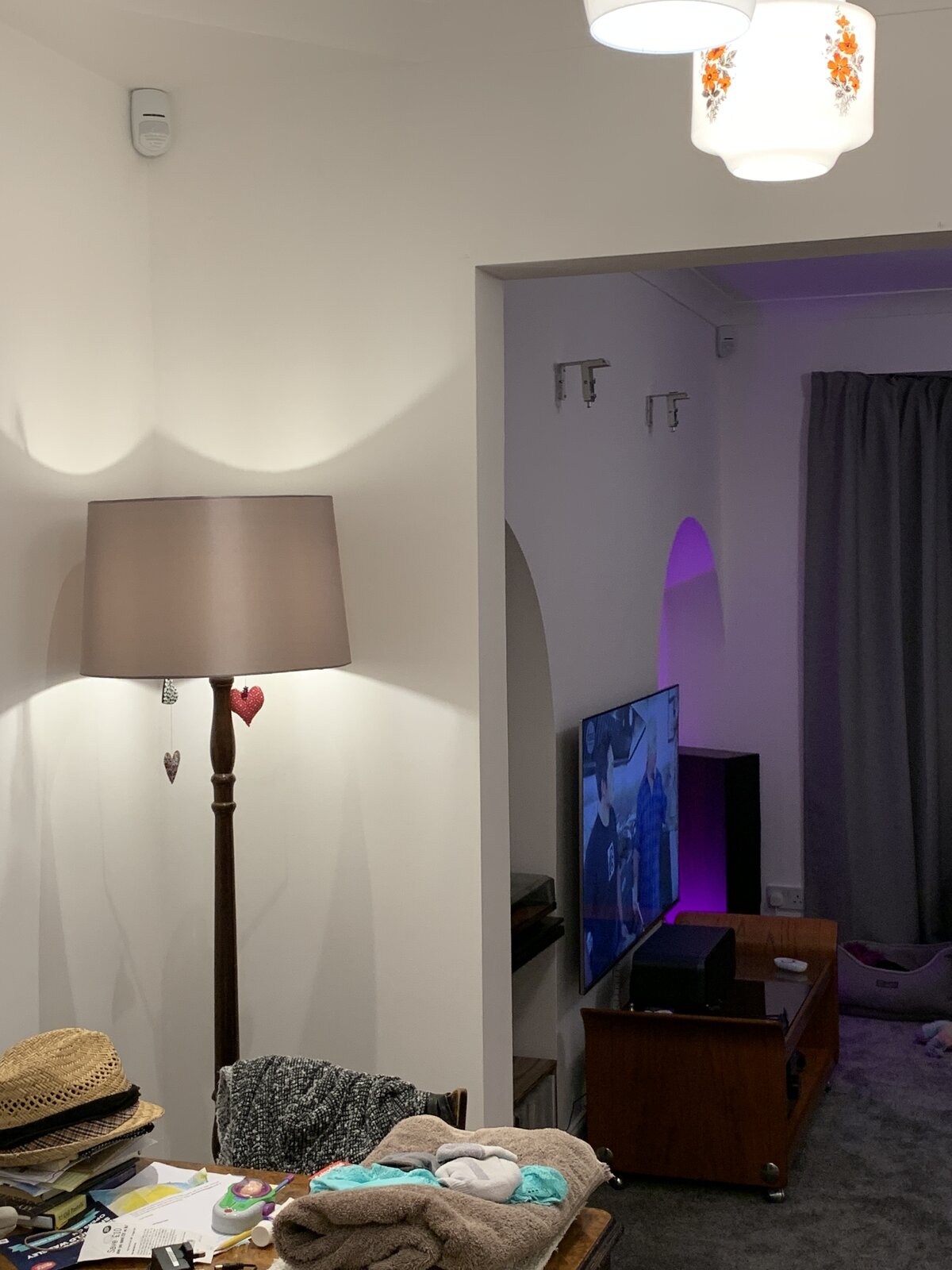

Pic 1 is Living room

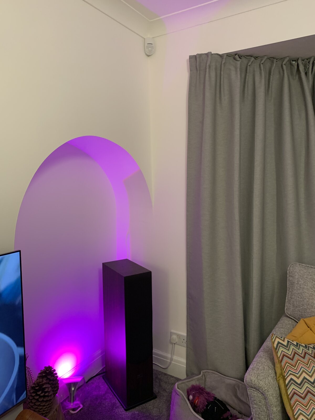

Pic 2 is dining room with living room in the background

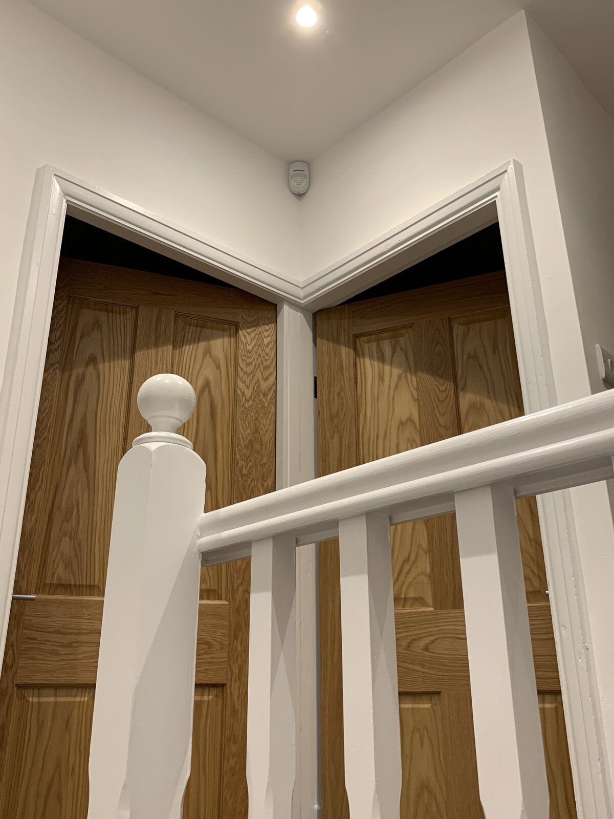

Pic 3 is top of the stairs

First thing ....do you have pets ? .....if not remove the pet filters ....
Second thing ....walk test are you putting the panel in walk test or are you just walking around looking for the led to light up ?
Hi
We do have a small dog but she's in the extension if we go out, we have a glass door between the dining room and extension, if I took the pet filter off is it possible it could trigger?
Did walk test in engineers mode and got my other half to walk around, 1 out of 3 triggered, living room one but only when she went into the dining room.
Presume the pet filter is the slotted bit of white plastic?
UPDATE
Pet filters off and PIRs seems to be working as expected, will see what happens when I go out later!

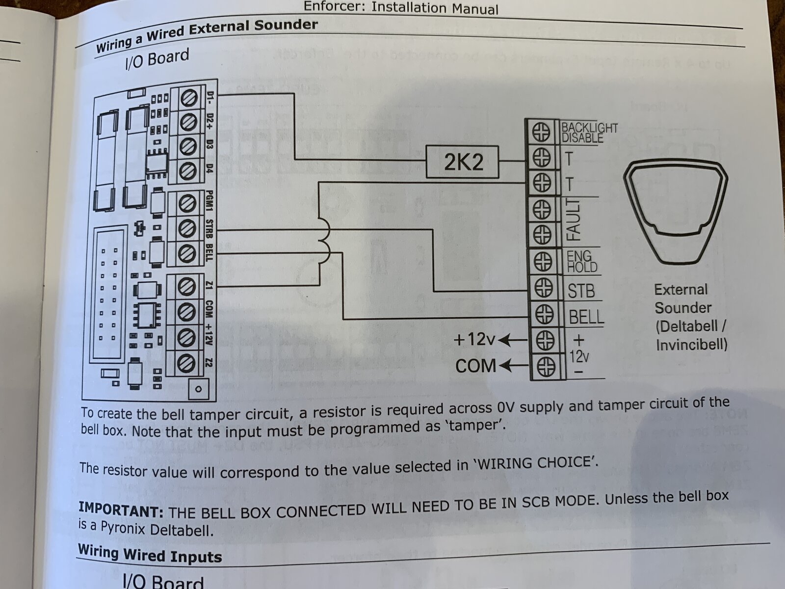

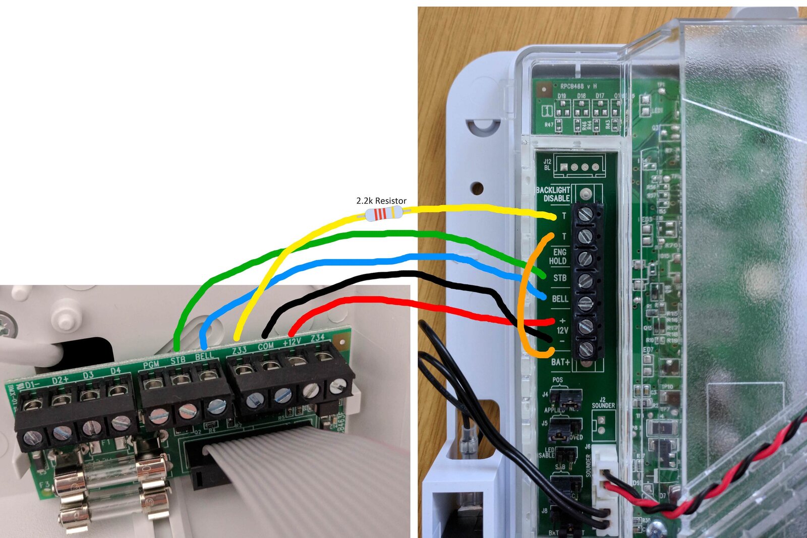

I have found one thing odd, when looking at the wired bell its coming back on the display as cF, input 1-33 is 0.23k, 2-34 is 25.0k, PS is 13.3V <0.10A, is this all fine?
BB was wired as installation manual.
I did find another way to wire it on here and if thats a better way I'll opt for that, then the spare wire I can use for Eng Hold.
One last thing, how weather resistant are the bell boxes, mine seems to have small gaps at the side and everything is as flat as possible.

Problem with instructions is they vary, the ones that came with the Deltabell X are different to the ones in the kit.
At least on those PIR's you can remove the plastic, don't have that option on some other brands.
Cant comment on them being different without seeing them both to be honest, would have thought the delta bell manual would have connections to other panels on there also and the enforcer manual would have options for other bells.
Here's both options
  • deltabell.pdf
U sure it doesnt say 2.3k for input 33 as it is showing closed circuit which is fine. U need to program input 33 as tamper aswell.
