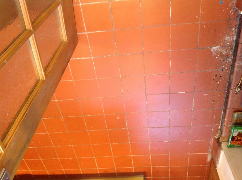

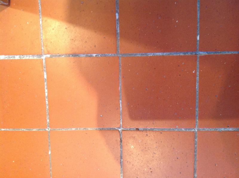

Just after some advice really with regards to a kitchen floor that is done with quarry tiles. We have just had the kitchen re plastered and the floor needs some major tlc as you can see
Is it possible to re grout an already laid floor (don't know how long it's been down for)?
Is this something that's easy to do for someone with basic diy skills or get a pro in?
Should I use white grout to contrast with the red tiles?

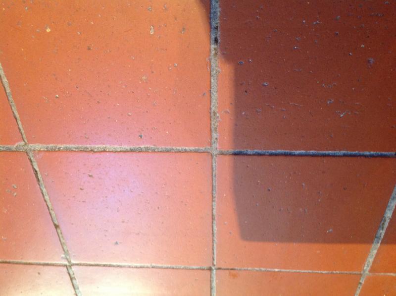

If it is possible how should I remove the existing grout? Wire brush the size of a tooth brush? Little chisel or multi tool. Dremel type rotary tool?
I will try and add some pictures to show people.
Any help or advice is very much appreciated
Its a DIY job.
Dont ever use white grout on a floor. Use a dark sanded grout see Mapei.
A 4-1/2" angle grinder and a diamond tile blade and/or a tile carbide router bit chucked in a drill - see tiletrader.co.uk
