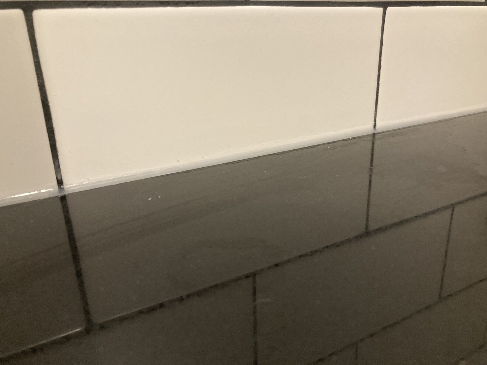

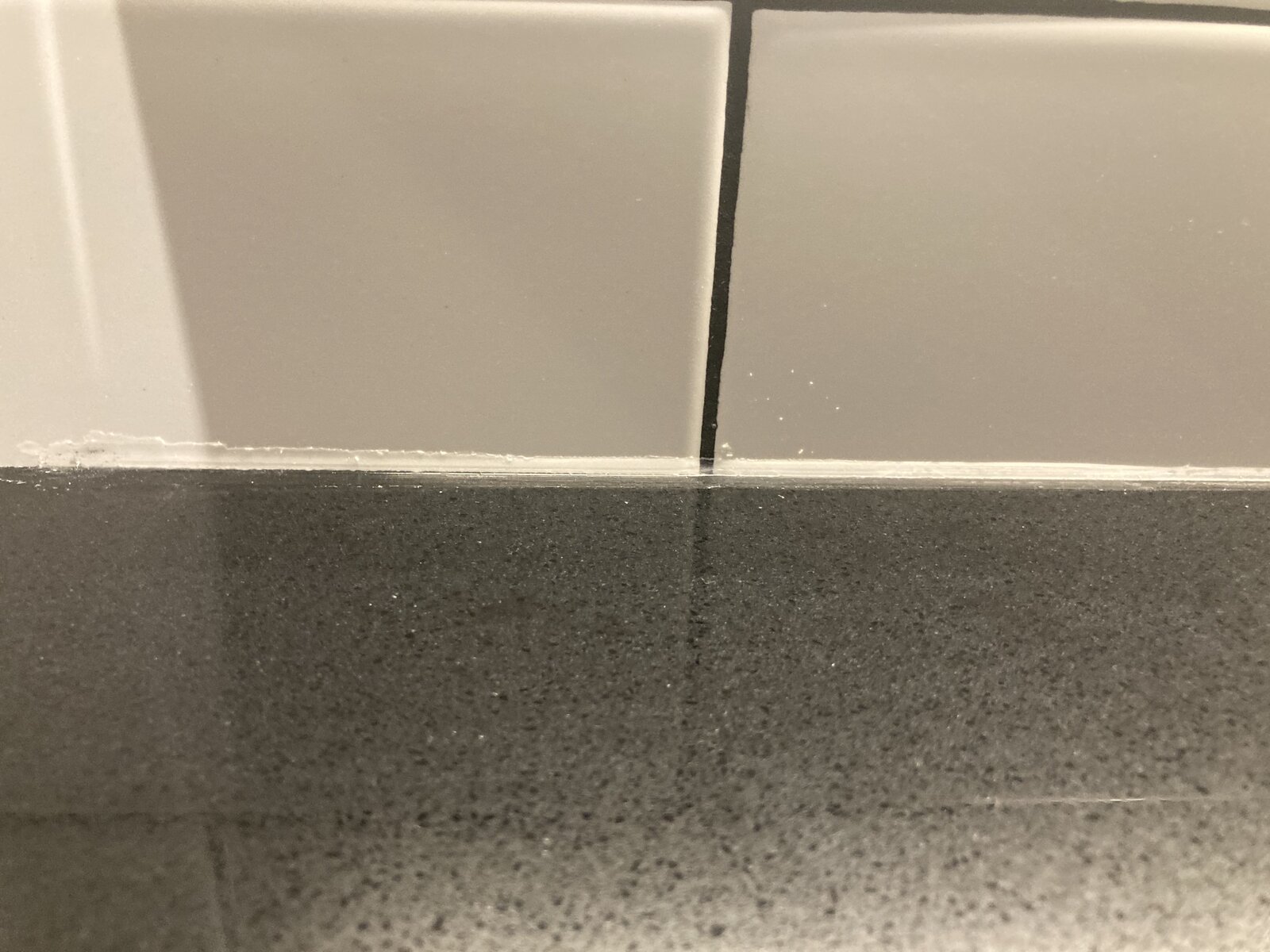

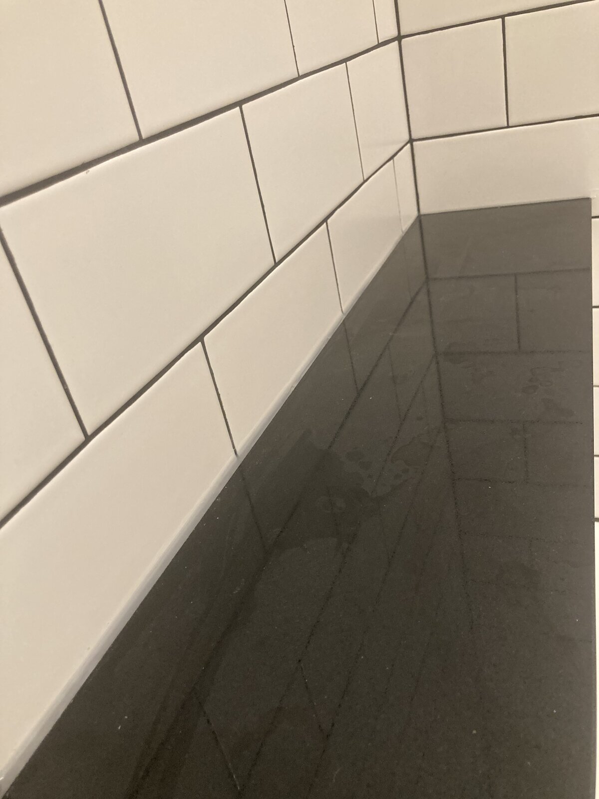

I have just had a quartz worktop fitted in a bathroom. The fitter measured beforehand, but clearly did not template properly, as a result, it appears there are gaps along the wall, this was filled with translucent silicone, and silicone all the way along the edge with the wall. Some of the silicone is also already peeling, 3 days later. Photos attached.
Clearly I need to get this resolved, should silicone have even been used and what would the best course of action be?

Can't see any gaps, maybe you're referring to the uneven tiled wall that's not perfectly straight.
That's why tiling is usually done after installing worktops.
The silicone shouldn't peel after 3 days, or a year, they probably used a cheap one or a faulty tub (happened to me last year).
Redoing the silicone is not a big problem, but I would use a dark one similar to the quartz and grout.
It’s looks like a tape was used to get silicon edge straight, but removed when dry instead of immediately, this leave a loose thin edge, it can be trimmed off, (thin areas)with a scalpel.
The silicone was badly applied.
It was the correct product to use though.
When smoothing silicone, if the outer edges become too thin, they will rip as you run your finger over it days later. Unfortunately, with clear silicone (and white silicone) people think "meh, it looks OK" and don't care about what happens a few days down the line.
Unfortunately, removing badly applied silicone takes much, much longer that it took to apply it. You need very, very sharp blades or chisels.
