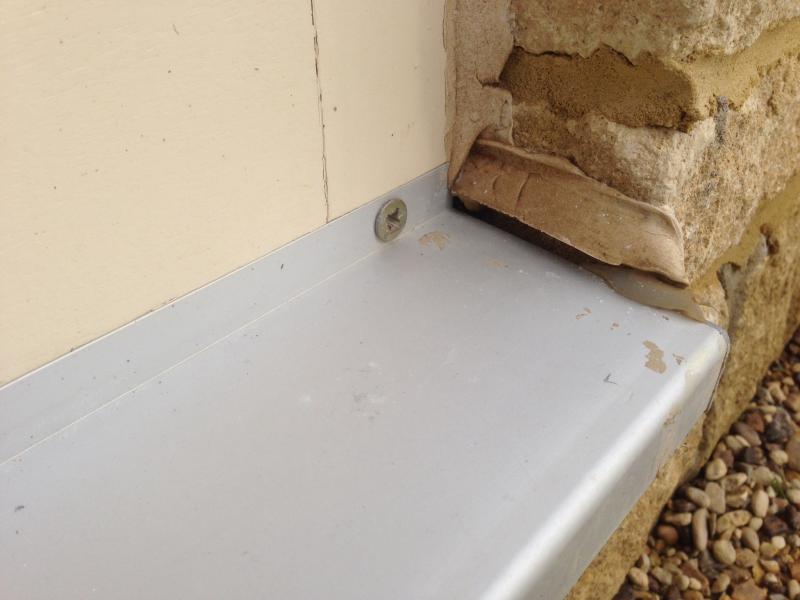

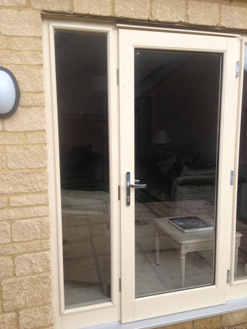

I'm am in the process of buying a new house and would like an informed opinion on if these doors have been fitted correctly?
Apparently the windows are painted hardwood so perhaps these doors are too.

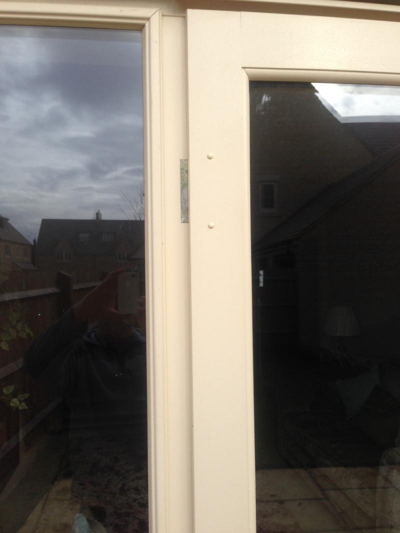

I have not seen doors before with these 3 metal plates on show, are they a security feature,surely these plates should be hidden.

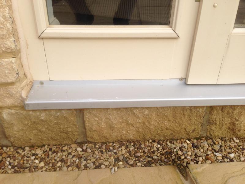

Also the sill appears to be metal, I find it odd the screws are on show, is this the correct way of fitting?
Does anyone know what make the doors are so I can check with the manufacturer?
All your help is really appreciated, it's bests if I have some info before the builder tries to fog me off.

My gut instinct would tell me to avoid this house. The metal cill looks like a poor patch-up for some kind of rain penetration problem. If you look in the right hand corner it has been siliconed and there is a gap which would allow rain water to seep under the edge. The hinges look as though they could have their pins knocked out with a hammer and pin punch, thereby allowing the door to be lifted out of the frame. It seems a slender frame to be carrying a large sheet of double glazing that size. I think you may have problems in the future of the door warping/twisting in damp conditions. The steel plates on show could be security bolts inside that you turn with a screw type key but you can see blanking buttons on the face of the door. It may be possible to remove these then use a screwdriver to loosen the locking mechanisms inside.
If this is what the exterior door is like I would not like to speculate what you may find inside once you move in and start decorating.
As I said, I am not a builder, but my gut instinct is to avoid this property.
If that's ALL you can find wrong, then negotiate on the price to allow for a new patio door to be fitted (allow 2K). It does look like a dog's dinner of a job.

The door looks crap to me. The mitres and alignment on that moulding are miles off, and I've no idea why those screws are visible. All in all it looks poor.
I'm sure these rough edges could be fixed with a bit of work and some wood filler, or you could just replace it. At the end of the day it if opens, closes and keeps the rain out it'll do for a while...
