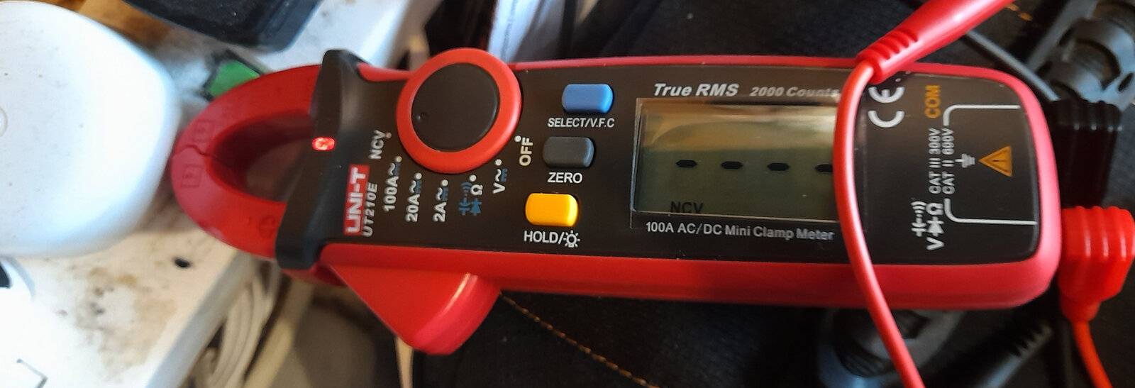

However armed with £70 worth of test equipment VC60B.jpgTesting for live.jpg I can find most faults, and if not I can borrow test equipment, but even £70 is a lot to spend, and the point is you need to decide is it worth it, or is it cheaper to get some one to inspect and fix it for you?
I assume you have some test equipment already to give us voltages, I have only one tested MCB's trip at rated currents, and that's another story, and in the main I cross my fingers that other protection devices work as they should, from time to time I have tested my RCD's with a proper tester, but if they were swamped with DC so would not work, I am unlikely to know. If the test button works I assume they are OK, however a test button often uses more like 100 mA not 30 mA and really is only the test the mechanics.
So you have unearthed some potential dangerous faults, they may not be dangerous, but without testing we don't know, and the big question is it worth doing it DIY? I would love to sit here and guide you through the testing, but is that really what I should do with such a fault, clearly should not refuse to help, that would be silly, but I should point out the limitations and allow you to decide if you think this is a DIY job.

However armed with £70 worth of test equipment View attachment 303936View attachment 303937 I can find most faults, and if not I can borrow test equipment, but even £70 is a lot to spend, and the point is you need to decide is it worth it, or is it cheaper to get some one to inspect and fix it for you?

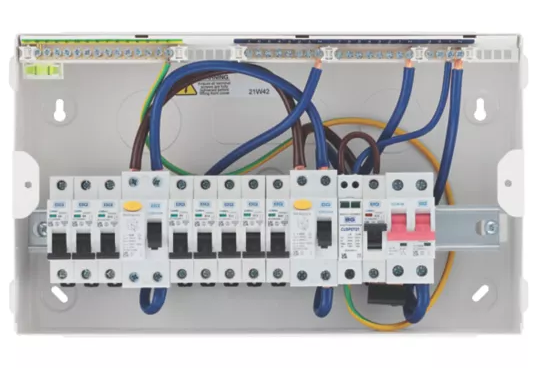

Sorry missed the bit about not tripping the RCD, we have some CU's called high integrity, not a clue how the got the name, but they have three neutral bars, two RCD's feed two of the neutral bars, and the third has RCBO's for critical equipment of course MCB's could be fitted, and today often the SPD uses those slots.
The units are still available, in fact when I looked for the picture, I found some boards being sold with type AC RCD's and also with 63 amp RCD's I am sure there are applications where they can be used, but it must be rare today. But at £54 with "100A Main Switch, 2 x 63A 30mA RCD (Type AC) c/w 10 MCB's (3x6A, 2x16A, 4x32A, 1x40A) Fitted" it must be a temptation to buy and use them, seem to remember back in 2019 I paid around £300 for mine, and used a cheap make, FuseBox.
