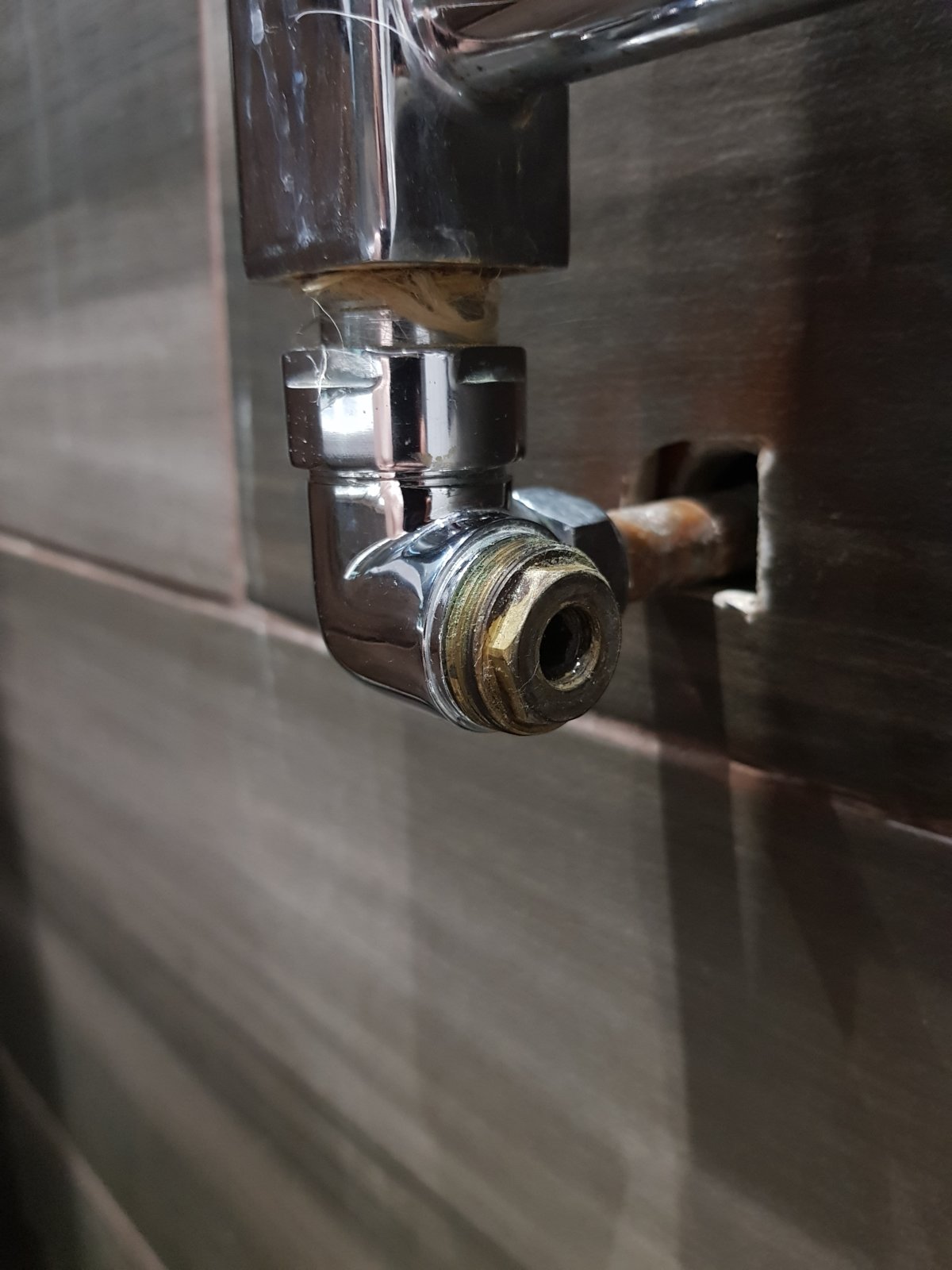

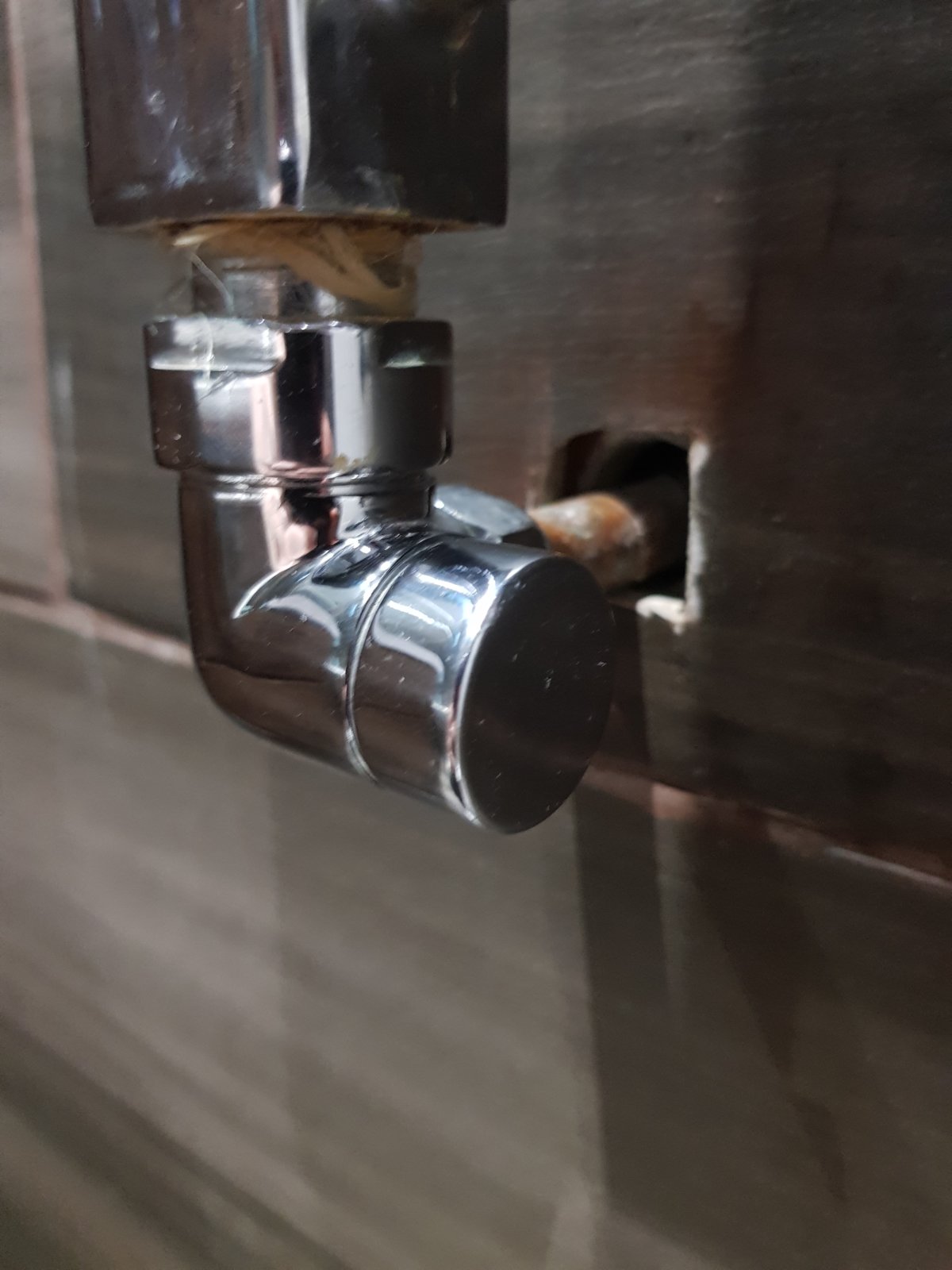

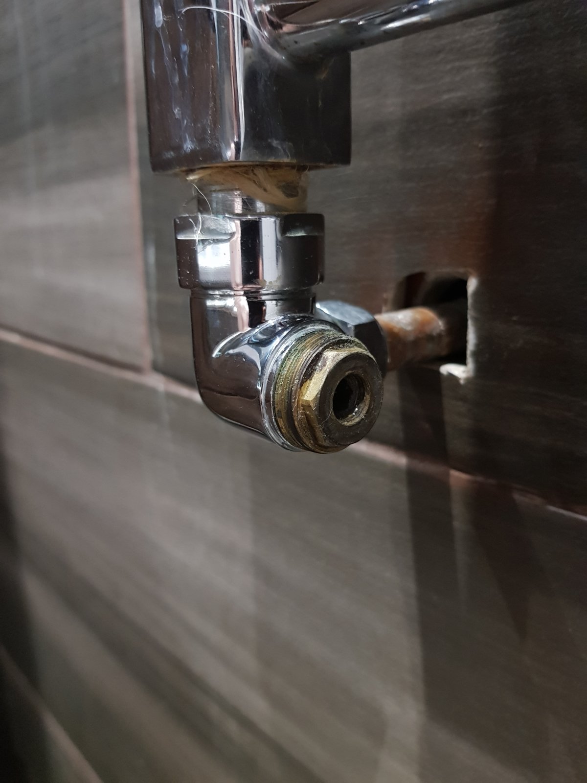

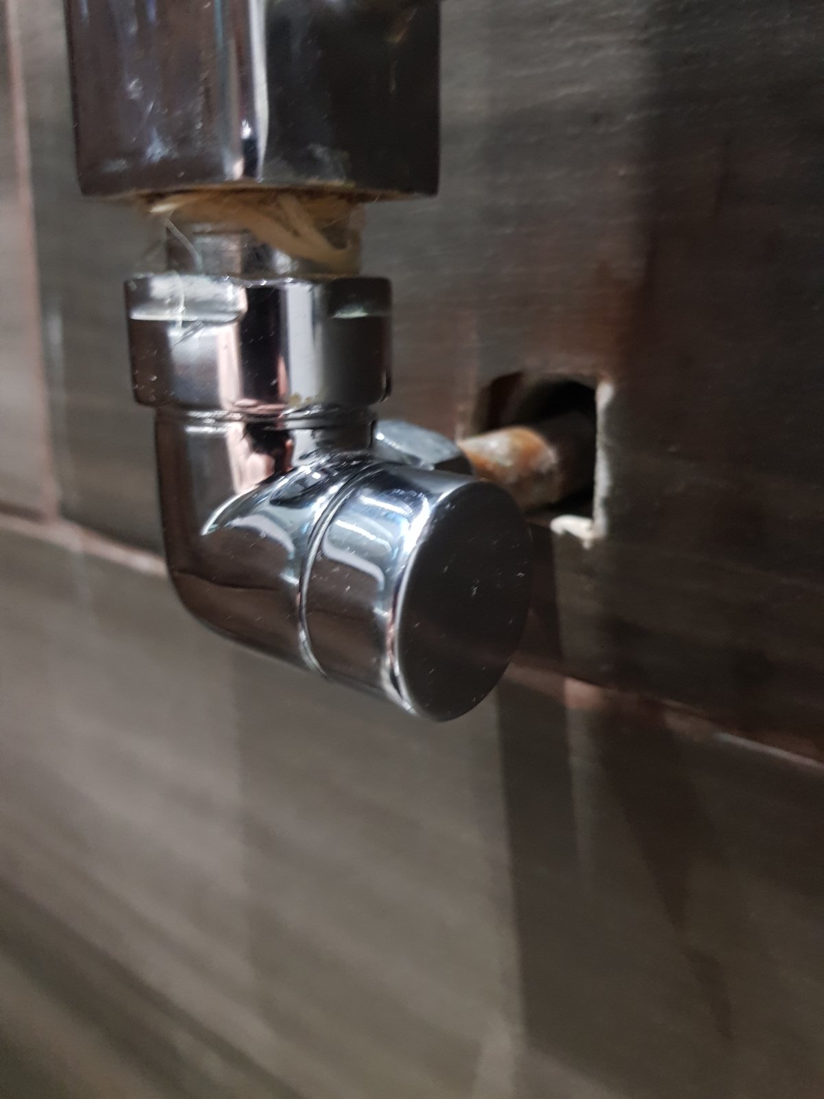

Stupid question sorry, I just can't work out what this thing is - there's a TRV on the other end of the radiator so I'm guessing it's a lockshield valve? It has a decorative cap, but no spindle or any sort of mechanism that I can see, and it's started dripping very slowly. What should I do?

yes it is a lock shield, it has no spindle you adjust it with an allen key in the hole

I'm pretty sure it's coming from the central hole
It looks rather like a Danfoss RAS-C2 lockshield, though mine are not that shape. It might possibly be a copy by some other make.
Yes, you can adjust it with an allen hey. I forget the size, it will be metric, you get one in every pack. I expect Danfoss will tell you the size. Tie one to your radiator bleed key and hang it under the boiler for next time.
if a lockshield starts leaking, it will usually stop if you tightly turn it either fully open, or fully closed. Then you can have it replaced at a convenient time. You could DIY or ask around for a local plumber by personal recommendation (not an advertising website)

Found the correct size key but it leaks when fully open and fully closed (and very enthusiastically in between).
I've thrown a bucket under it and will get a pro tomorrow, thanks for the help (y)
Just wrap the threads to the cap with some ptfe and the cap will seal (y) then cancel the pro - but don't tell him I told you. ( nice to see hemp used on the other end of the valve - into the rad - shame it wasn't cleaned off tho')
