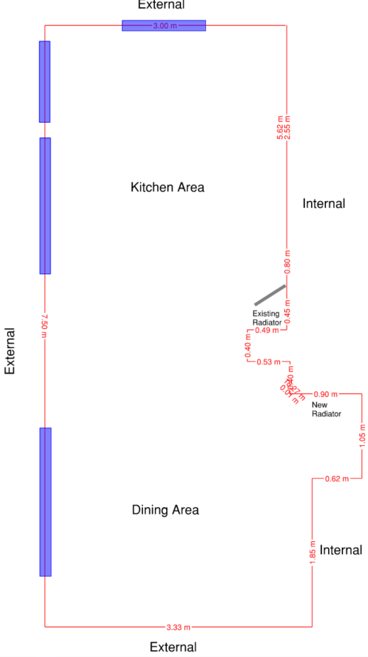

Hello all, I have an odd shaped kitchen diner, which a single vertical radiator fails to warm up so I am going to add a new type 22 radiator. We have a concrete floor so ideally we will locate the new one close to the old one. I've drawn a picture below but concerned that I am putting the new radiator in cubby hole so may not do a good job of heating the room although the kitchen part of the room doesn't really need to be that warm. The blue boxes are windows or french doors. Any thoughts?

I'd put a big one on the 3.33m wall tbh. Away from the kitchen heat, but closer to the dining space.
A few heat calcs (simple enough) would give you the btu rating.
I've just done the calcs and it appears I need about 8000 BTU. The existing column one I think is about 4000 BTU so I need about the same again, which I can fit in the proposed cuby hole area, just. I would prefer to go large on the radiator, as per your suggestion, and then just run the CH at a lower temperature but the plumber will need to run a lot of pipe over there from the existing radiator and not sure it's worth the extra hassle if the cuby hole one works... only i suspect it might just heat that area up.

Benefit of a rad on the back wall is it will be horizontal. Vertical rads are crap at heating efficiently. The horizontal rad will also be good for washing in the winter....

Waste of time including that rad in the calcs, the column rad will be adding very little to the heat into the room due to the way it heats. Only about 20% of that heat will be transferred into useable heat for the space
Get rid of the column rad and add in convecting rads, there are lots of new contemporary designs that will heat the space properly and also look good.

I am going to go with putting a large convection Stelrad type 22 or K3 on the 3.33m wall. There are french doors next to it so that should help with getting the convection going.
The question is how large... 8000 BTU for the whole room estimated but the kitchen area doesn't really need to be that warm and we are generally cooking when in that area plus there is no where to put a radiator there. I was going to go with an 8000BTU.

Keep in mind the size and length of supply pipe heading to the rad before the largest possible rad is thrown on the wall. Too big a rad will need a fair amount of heat supplied to it for it to warm up. The 8000BTU could be taken up by a 600x1400 K2 which isn't overly huge.
Another point to note, large amounts of glass, even double glazing, can act as a heat soak and can become a hinderance to heating a room properly. I recommend lined curtains or blinds as another option, to act as a barrier, if heating becomes an issue.
I'd also consider if the rad is going to be exposed or not. Exposed, I'd be getting something that looks decent. If it's going in a rad cover, something efficient will be best.
