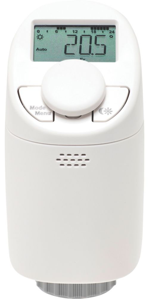

You can see the two arrows on this picture showing either direction, if only one arrow then must be mounted right way around, I have used these
886GV_P
as then I know temperature set and can program them, cost around £10 bluetooth version around £15 one shown is the eQ-3 the Terrier i30 very similar.
The problem is setting the valves, I found this out with my mothers house, I got 4 Energenie MiHome heads which unlike the cheap versions it shows both current and target temperature. The lock shield valves were wide open when I started I closed them to force water around the furtherest radiators on start, however I found the heat was over shooting the setting, so I slowly closed them until they were not over shooting, then I took one of the heads and fitted temp to other radiators and did the same, once the lock shield was set, put the wax head back, and found rooms were spot on after.

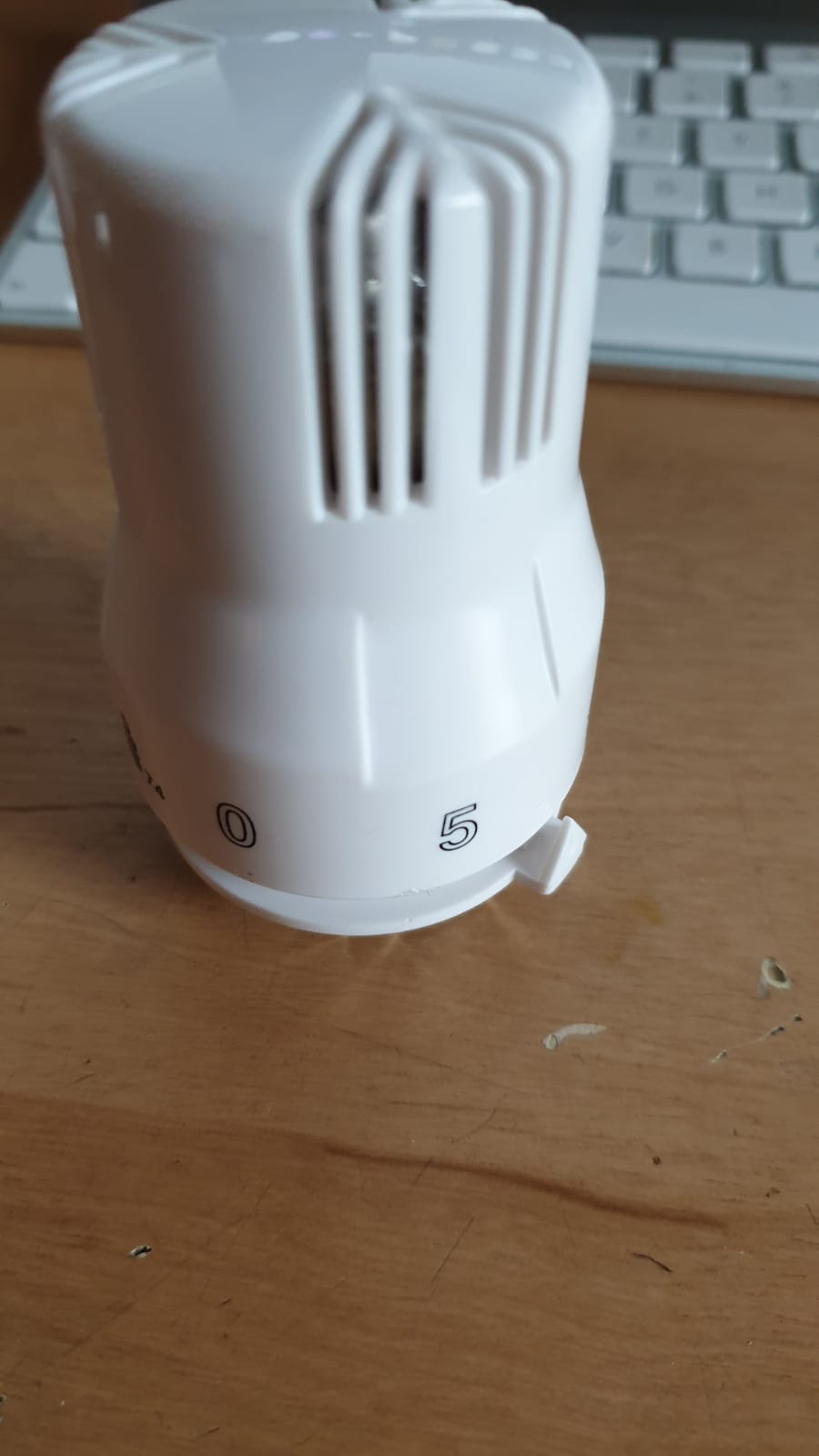

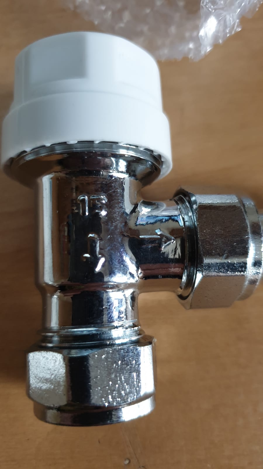

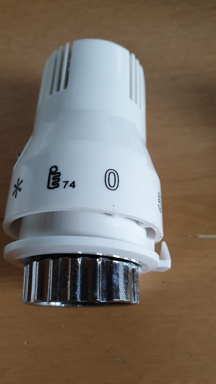

Hi, thanks for the replies. yes, the valves have the two arrows. I should have stated, the rad I was talking about has the Honeywell TRV, the other new ones I fitted don't have a brand one them, photo below. But they all have the 2 arrows. Alsothe issue I mentioned in the first post is apparent on several of the rads.

Thats when I noticed the issue. The rooms in question were not up to temp, and the rads were not at full heat. I understand they should come on at full heat until the desired temp via the TRV dial is reached. The only way I can get these rooms to match the heat in the room with the thermostat (19.5 deg normally), is to leave the TRV at 5.

Ive posted some pics above. I done the hot/cool test on each rad before fitting. They are all on the 'hot first' pipe.
