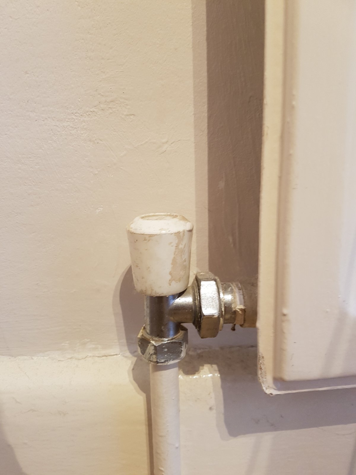

Felling a little confused can you post a picture of the valve you need to replace and attached pipe please?
Old rad valves had an odd sized union but most new ones use the standard 15mm compression so the valve can be fitted upright or sideways if needed.
My system is 15mm drops to the bottom of the valve. That is the same no problems.
It is the tail and connection to valve that differs.
My terminology could be out but I think it is a 1/2BSP thread into the rad end and a union 3/4? fitting for the tail to radiator valve. The nut stays in place on the tail when you undo.
I see them everywhere and they are on all our radiators but almost all new valves seem to be 15mm pipe tail with compression fitting into valve. Is that any clearer? Photo below:

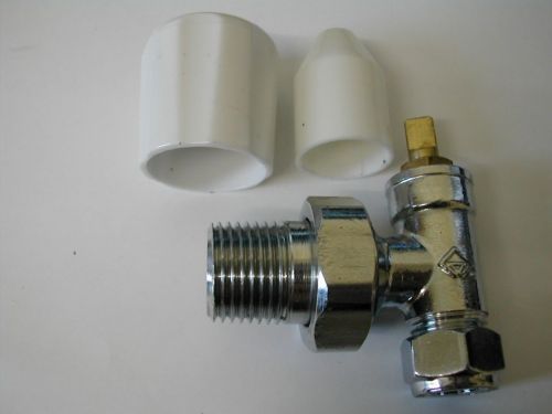

This photo shows it well. From https://www.stevensonplumbing.co.uk/10mm-radiator-valve.html
["Some radiator valves use a large union nut and tail, and others use a 15mm compression connection to the tail."]
It is 10mm to bottom of valve in photos / link but they list a 15mm for purchase as well but photos not as good. So it seems you can get them for the non TRV valves. Seem to be very rare now?
But I'm still stuck for the TRV end. Or is there sufficient adjustability with the 15mm tail to compression fitting to make it the same overall projeciton into rad? I.e. about 50-52mm from centre of valve.
