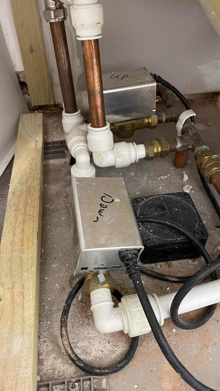

Wondering if someone has an idea to my issue even my plumber doesn't know why.
Firstly, the boiler is about 3 years old (moved into new house Sept 2019). The boiler is absolutely fine. I'm getting hot water to all taps and showers, so we can rule the boiler out.
I have 2 central heating zones (downstairs & upstairs) with 2 separate thermostats and 2 separate zone valves (which are behind the bath panel in the bathroom).
The problem is, when I turn the thermostats on, nothing happens anymore. The boiler doesn't fire up and I get no heating whatsoever.
The zone valves' levers do not switch to open the valves.
I've put the valves in manual so they're always open but this makes no difference so I don't think it's the valves?
Any idea?

Could it be anything to do with the little black box where the valves are connected to?
It's the motorised valve that sends voltage to the boiler to fire up.
What little black box ? Show us a pic.

Ok ,that's just a junction box used as a wiring centre where all the electrical connections are made.
Ahh, okay. So all signs are pointing to the zone valves which will need replacing?
Yes ,probably just their motors. What make and model are they ,look like Honeywell ?
