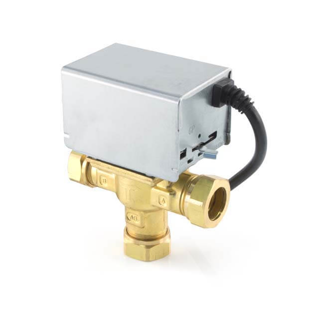

A few details needed, Boiler? Motorised Valves? Make and model numbers would help. First guess would be a stuck motorised valve.
+1, if heating valve is stuck open, then radiators will continue to heat until Hot Water is satisfied and boiler switches off. First check for me would be the motorised valve(s).

If the motorised valve is stuck open, is there an easy test for this?
Possibly the roomstat contacts aren't breaking when they should. Switching off the electrics and doing a continuity/resistance check of the stat with a multimeter would verify this.
Does valve look like this?
Should be a small lever on the side, as shown in pic above, should spring return to HW position, blocking off CH port. See if their is any resistance on it, is there is, its returned to rest position, if it's floppy, it'll be stuck in mid position. If stuck, give it a gentle thump with your fist, you may here it whirr back on the spring to HW position.
Many thanks to all for taking the time to respond. The lever was limp. I did a bit of YouTube research, then bought a replacement Honeywell Powerhead from Screwfix and I've changed it this morning.........now all working fine again.
