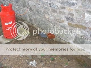

Could someone tell me which part of forum I would find advice on a radon sump Cheers
Hi thanks for replies. Can you tell me if this pipe should just be left like this or does it have to go up like the ones from toilets ? (can not think of name ) and can i top it with that black cover to stop rain going in or do i have to leave open ? many thanks
Technically you're supposed to measure the Radon level at the pipe outlet after the building/extension is complete and stick a fan on it if there's a high reading, otherwise you just cap it.
Thank you both I did pop the cap on before as it was lashing down I shall find out who measures the radon level and get it done when I can. Sorry if come across thick.
