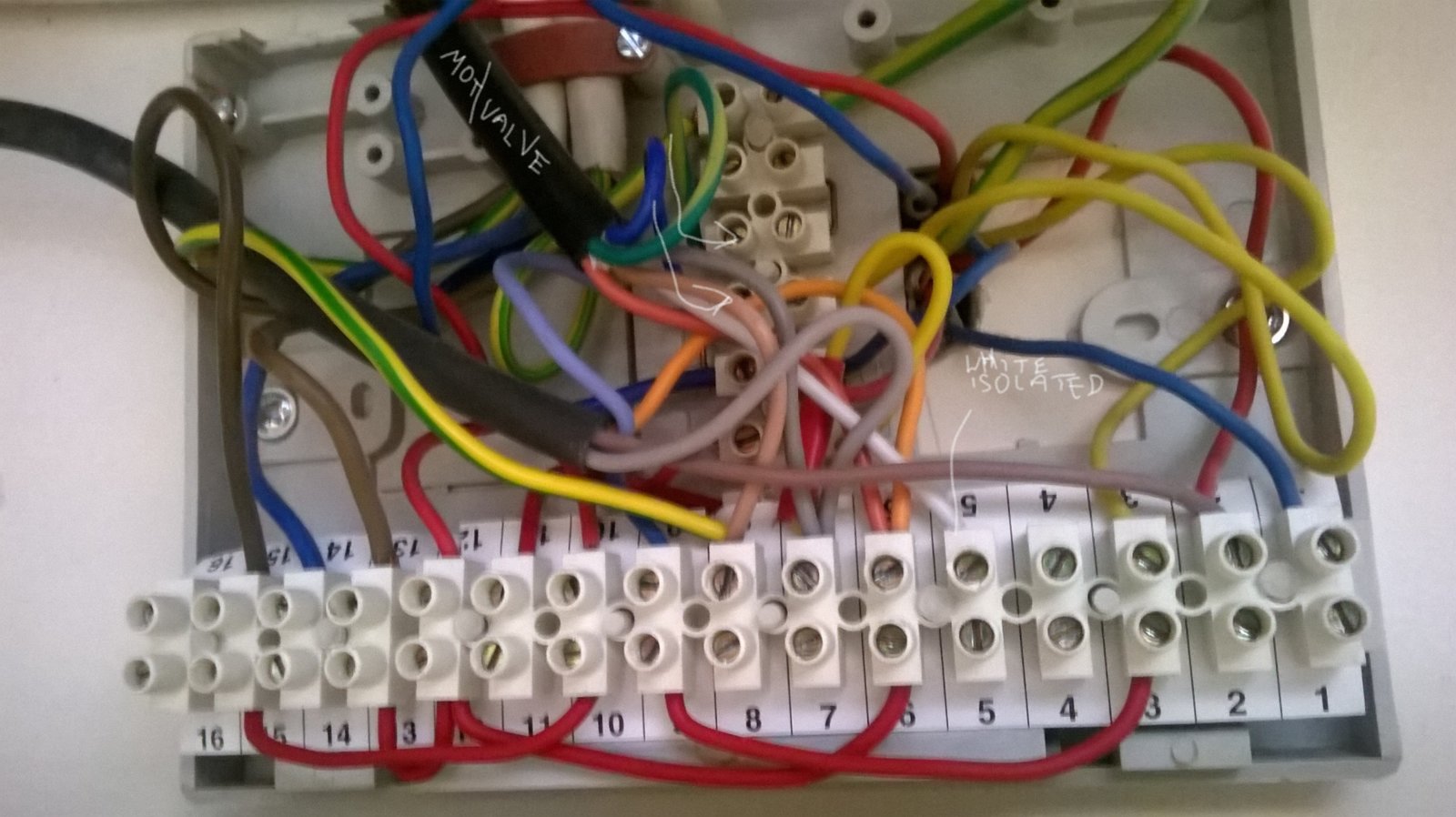

RCD is tripping when I move the room stat to (call for heat).
Conventional boiler, Mega Flow system, was having intermittent fault with the motorised valve where the boiler wasn't flashing up to supply hot water, removed the MV a few weeks ago fitted a new one and wired it in only to find the clutch/return spring was broken so returned it and refitted the old one, opened and closed the main 2 port valve it is attached to with a touch of WD40 and pliers seemed to free it up, wired it up like for like as previously fitted, quite confident the wiring is ok as the hot water has been ok for weeks.

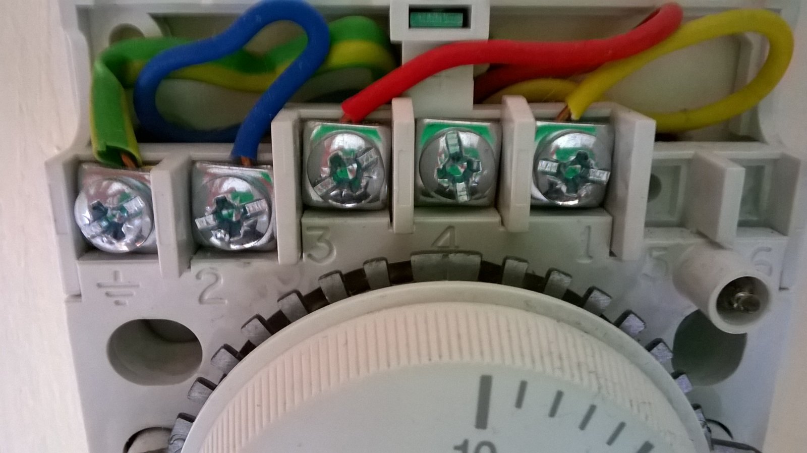

3. Power off. Room thermostat not calling. Turn to calling, test for neutral / earth and live / earth short circuit (test in wiring centre).
4. Room thermostat off. Turn to calling, test for neutral / live short circuit (test in wiring centre).

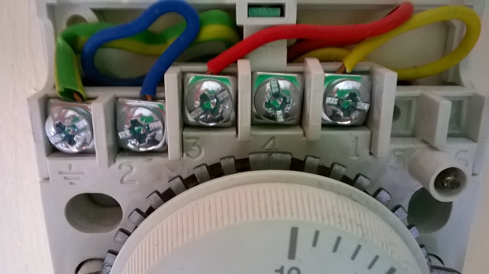

please show us a photo of the wiring connections on this stat.

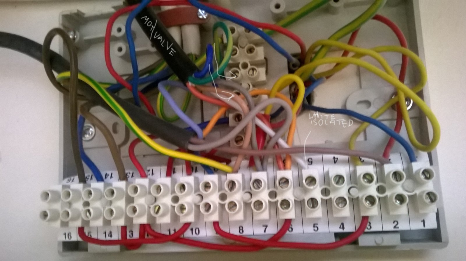

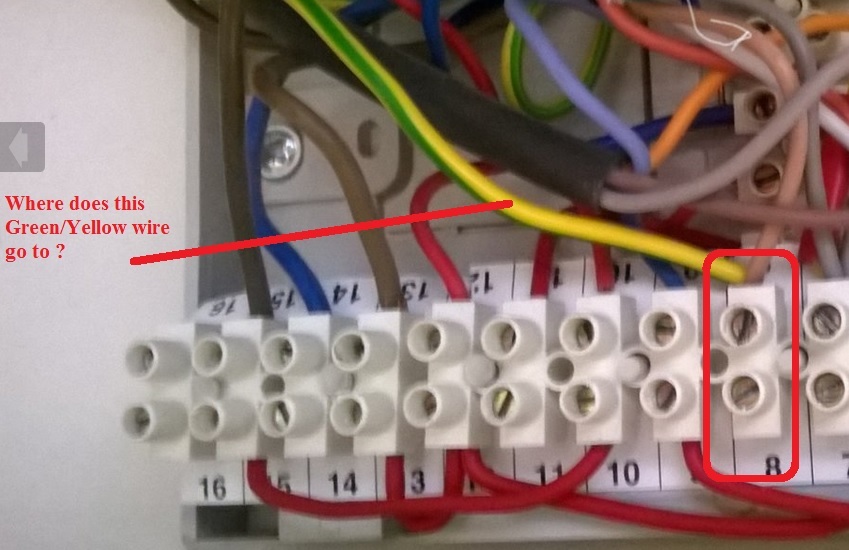

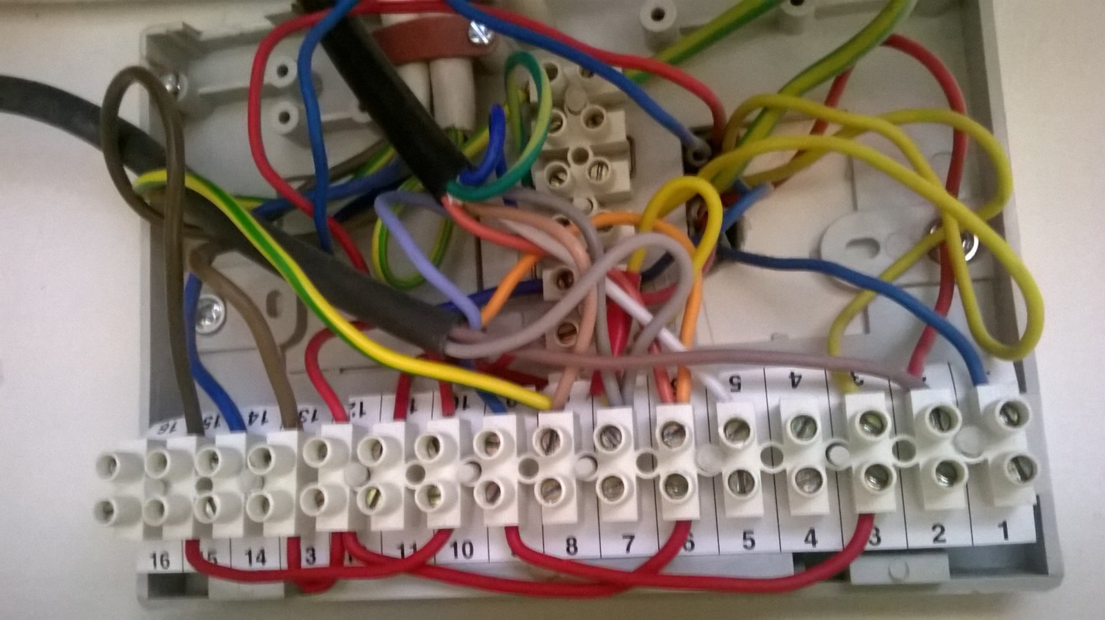

Cheers for the assistance, Hopefully pictures may clarify and I take your point, I haven't used the CH after re fitting the MV apart from yesterday when my wife tried to put the heating on tripped the RCD straight away, when I tried it 2 mins later CH worked and I bled out all the rads reached their op temp. Now every time it trips the RCD

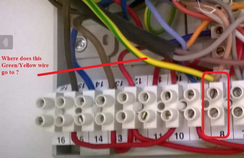

terminal 8 appears to have a taupe wire connected to earth.
I'm not a plumber and have seldom wired these centres so there may be something I can't spot.
If that green yellow goes to Earth and the other wire in terminal 8 is the Brown from the motorised valve then Switched Live from the motorised valve ( the brown wire ) is connected to Earth. If that is the case then it is no wonder the RCD is tripping when you call for heat, The valve opens and when it is fully open ithe micro switch operates and puts Live onto the Switched Live.
Thanks for getting back to me I understand what you are saying I must have made a mistake rewiring the MV, unfortunately I have no reference point to know where the earth wire in '8' would go I took a picture with my camera prior to removing the wires so I am baffled, you obviously can't tell me where it should go only that this is the most likely cause for the rcd tripping.
