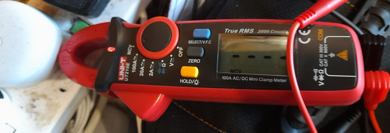

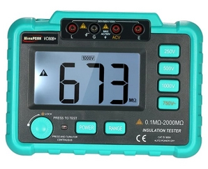

The rub comes in that the electrician needs to explain to the home owner the risk, and to be frank I am not sure what the risk is, so how can I tell Joe public what the risk is? Default is fit one, but if the home owner says no, then we don't need to fit one. So the same splitting the installation into more or less circuits, I lived in a caravan at one point and all went through one RCD, but to be fair lights were 12 volt from a battery, and the reason we have leakage is AC can transfer by inductive and capacitive linking, so the more cable used the greater the leakage, and a caravan is small. It also means the insulation tester VC60B.jpg only shows faults, as it tests with DC, to measure back ground leakage we need the clamp on ammeter Testing for live.jpg and I have already admitted up until 12 months ago I could not have tested how much earth leakage there was as my meter did not measure that low, and a normal ammeter is no good as can't measure the difference between line and neutral.
