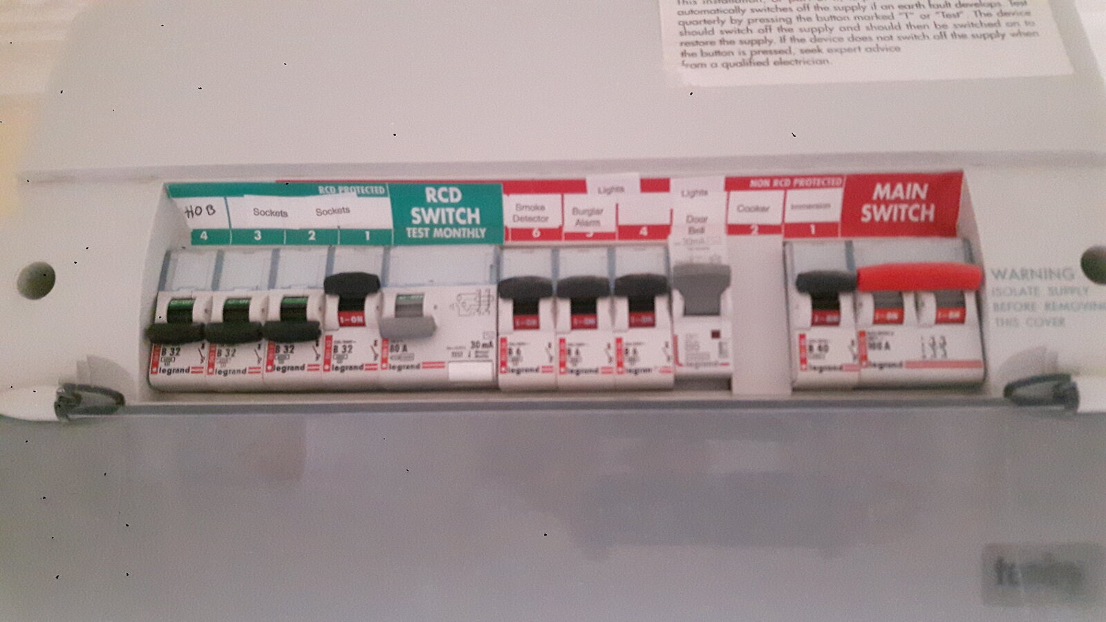

Hi,
About once a month I have the main 80A RCD trip. It will never reset immediately, so I turn off major items one by one (cooker, washer, fridge, dryer, etc.) until the RCD will reset.
1. I only have one appliance off at a time until I can rest the RCD.
2. Mostly, the appliance that allows the reset is not in use.
3. Here is the interesting bit, it is a different appliance each time that allows me to reset the RCD.
4. I can then always turn on the offending appliance without tripping the RCD
I then tried pressing the test button on the RCD box. Same result - I can only reset after a seemingly random appliance is turned off. Now I can reproduce the problem but am no closer to diagnosing the problem.
Any suggestions would be gratefully received.

Any chance of a pic of your cu showing the mcbs and RCD ?
Sorry, that was a bit confusing.
Below is a picture of the cu. RCD it tripped and 1 MCD is on.
1. I press the test button. RCD trips.
2. Four times out of five, the RCD will not reset with all or any single MCB on. It does not matter which MCB is on, it will not reset.
3. After trying four or five times it will come on.
The confusion with appliances came about as I can leave all MCBs on and turn off, then on again, individual appliances around the house until it resets.
One new piece of information: it is much more likely to reset if I move the switch very fast. Speed of switching might be the variable that affects whether it can be reset. - But I was never switching it hesitantly, always with a good positive movement.
