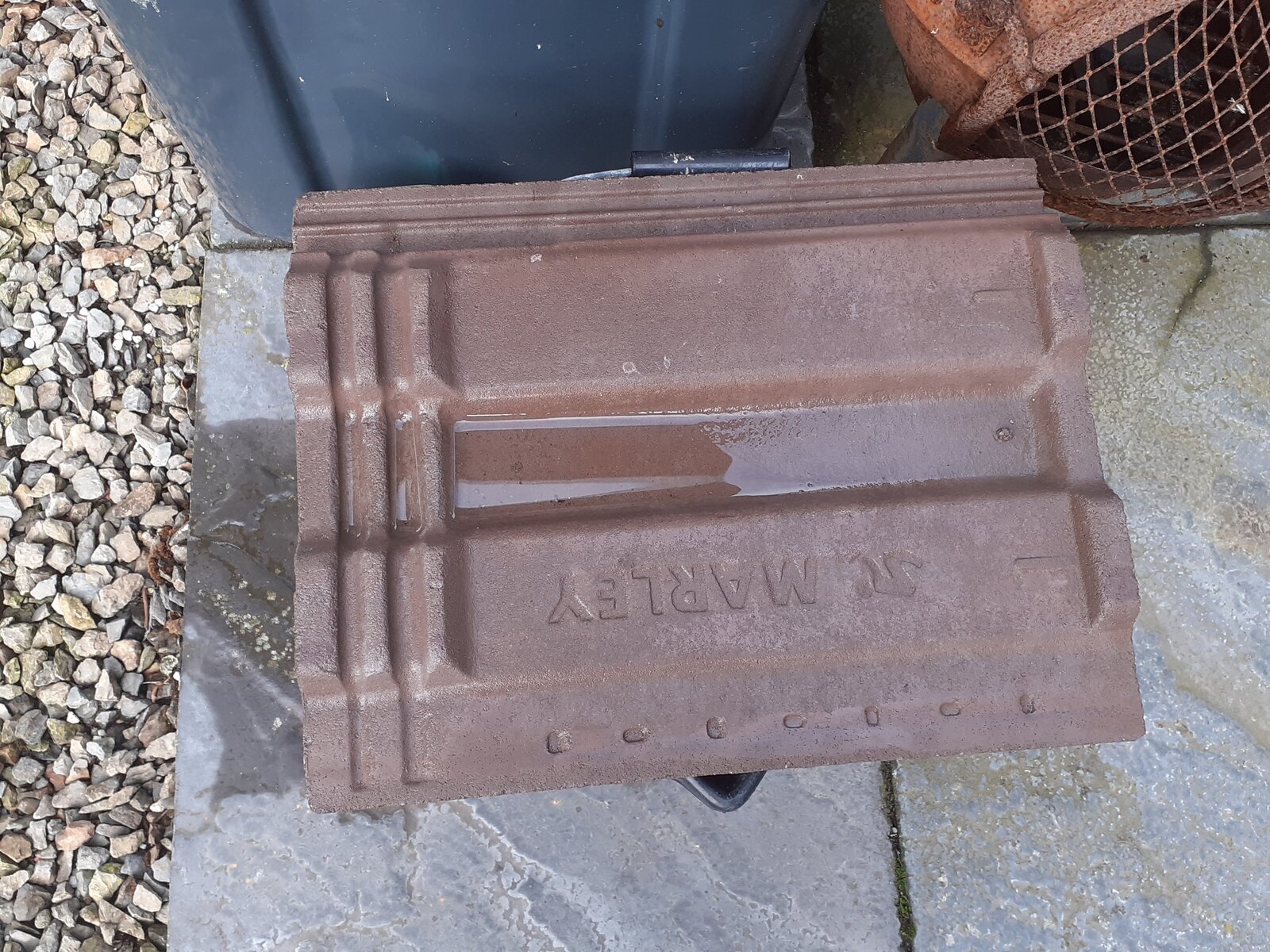

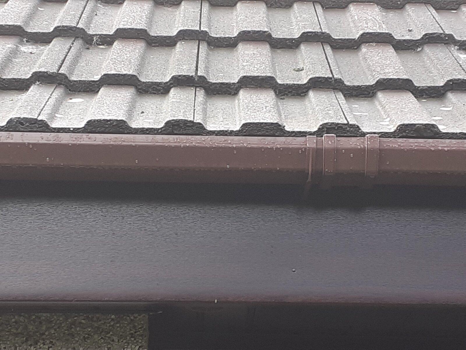

What type of tile is it? Profile wise, can you take a picture?
Hello again Makie
sorry for long delay in sending Photos. Away from home due to work. Heres a couple of photos

Thankyou kindly.
On order whilst they are only a tenner, Maybe tackle this next summer though
Don't they knock into the side of the tile supporting Batten ?
Bit Confused now with "nail down from the top " Don't they clip onto the side channel of the Tile and knock into the 25mm face of the 50 x 25 Batten underneath the tile
Yes they nail into the top edge (25mm section )of the batten , be it 25x50 or 25 x 38
You can end up with a nailed first course and a bottom of the second course clipped with solo .
The top of the second course and bottom of third will not be secured.
