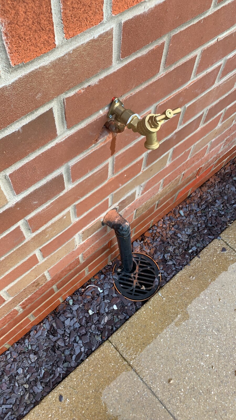

Need a small quantity of mortar for some repair work on the house.
Anyone had any experience with it?
Looking for one to match below as close as
I’ve used a couple. They have turned out quite grey, so they would probably be a fair match to what you have there.
Looks 1.5 sand to 1 cement. If you want a good match, mix it yourself and observe the dried colour of test samples.
You can't just buy some random mortar and expect it to match.
