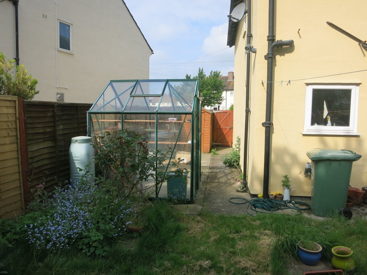

There is always a drain or sewer in the wrong place with extensions :mad:. You might want to plan for a downstairs toilet at the same time, which might mean moving the gas and electric meters if they are inside.
The house looks very open, has a wall been removed between the kitchen and dining room? You would need the structural aspect looking at in detail.
You could be looking at a party wall issue at the back.

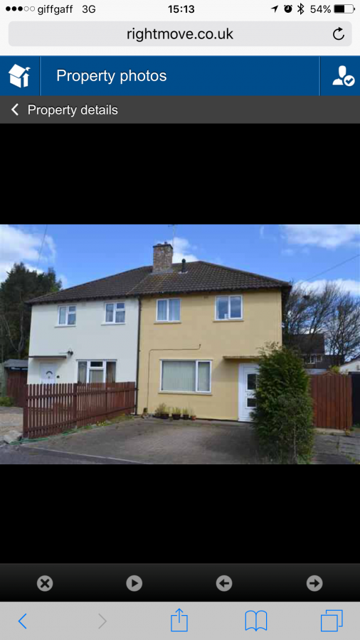

It's very hard to give an opinion without knowing the age of the house or the roof construction.
The trouble is if you set a moving in date in stone it can lead to a whole heap of financial woe.
Like if this is a Victorian house in London it could get very painful.

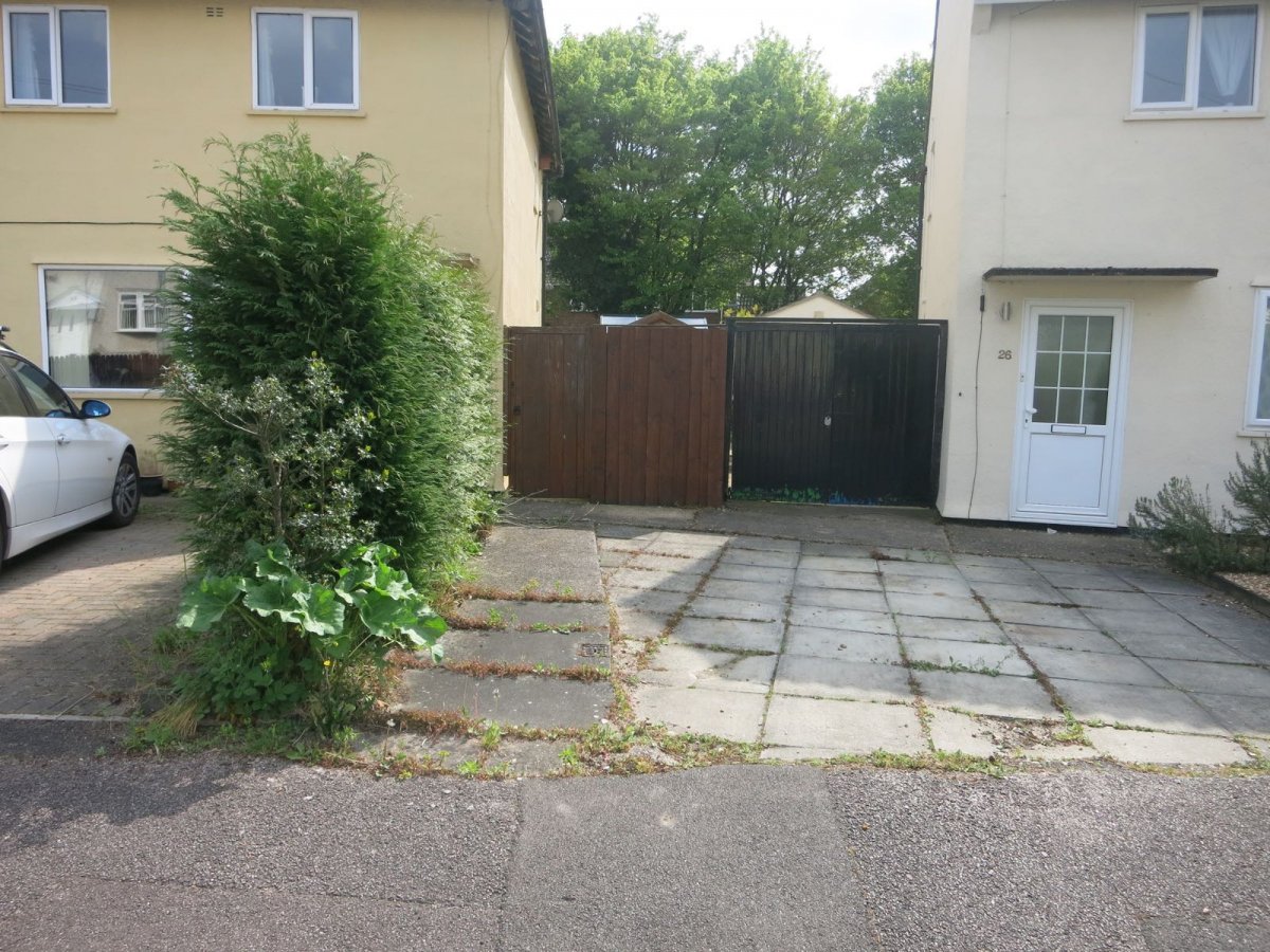

The property is in Cambridge. It's a Laing Easiform build around 1950s. Attached is some pictures of it.
