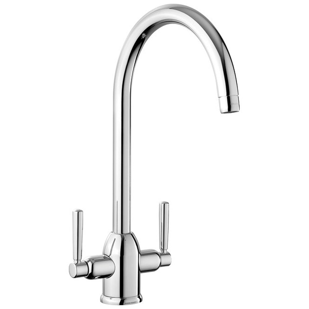

Having looked around, I have found the following tap that has similar dimensions (quite a long reach) to my old, leaking Blanco tap. Looking at the installation instructions, it looks like it may also come with copper tails, which would be a bonus, although I see nothing that specifically states they are copper.
Rangemaster Parma Chrome Kitchen Sink Mixer tap
I've never heard of Rangemaster taps. Are they any good?
Comes with a 5 year warranty, but that seems to be normal these days.
Looking at the Rangemaster logo, I think they are part of the AGA group so they should be fine.
All spares are available from tapmagician.
It's really only the cartridges and connection of the swan neck to the tap body that give issues anyway, so nothing to stop you going for it!
John :)
The Rangemaster Parma was supplied with some flexible tails, which was a little disappointing, but ordered some copper tails and used these instead. It avoided having to change the pipe configuration under the sink and because all the copper pipe work was connected using JG Speedfit plastic push-fit fittings it was relatively easy to connect up the new copper tails, once they had been compared to the old tails and cut to size.
Really pleased with the end result and the tap looks good.
