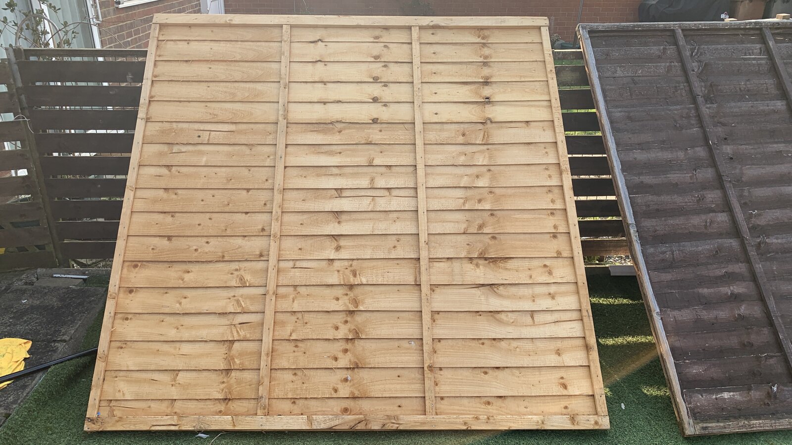

Hoping to open up an exploratory discussion:
Fence panels.
How to competently reinforce them?
(No funds to replace all 15 with stronger panels this year).
But - how to do it - right:
Fixings: galvanised nails/screws? Some will say stainless steel screws will suffice.
Extra bracing?
Is there anything else that can be done/added? What would you recomend?
Asking for guidance. Happy to add extra struts bracing to the panels. But what type and where?
(I'm sure i'm not the only one fed up with yearly remediation after storms).
Before installing - how can they be made more robust?
Cheers,
SirLancelot
(Good to be back)
This is what I am aiming to do:
Strengthening lap panels
I am asking the communities help in discussing alternative/better ways.
I want to put in the effort now, so I'm not dealing with this problem again in the next two/three years.
Open to suggestions and opinions on alternative ways to strengthen/re-enforce these types of panels.

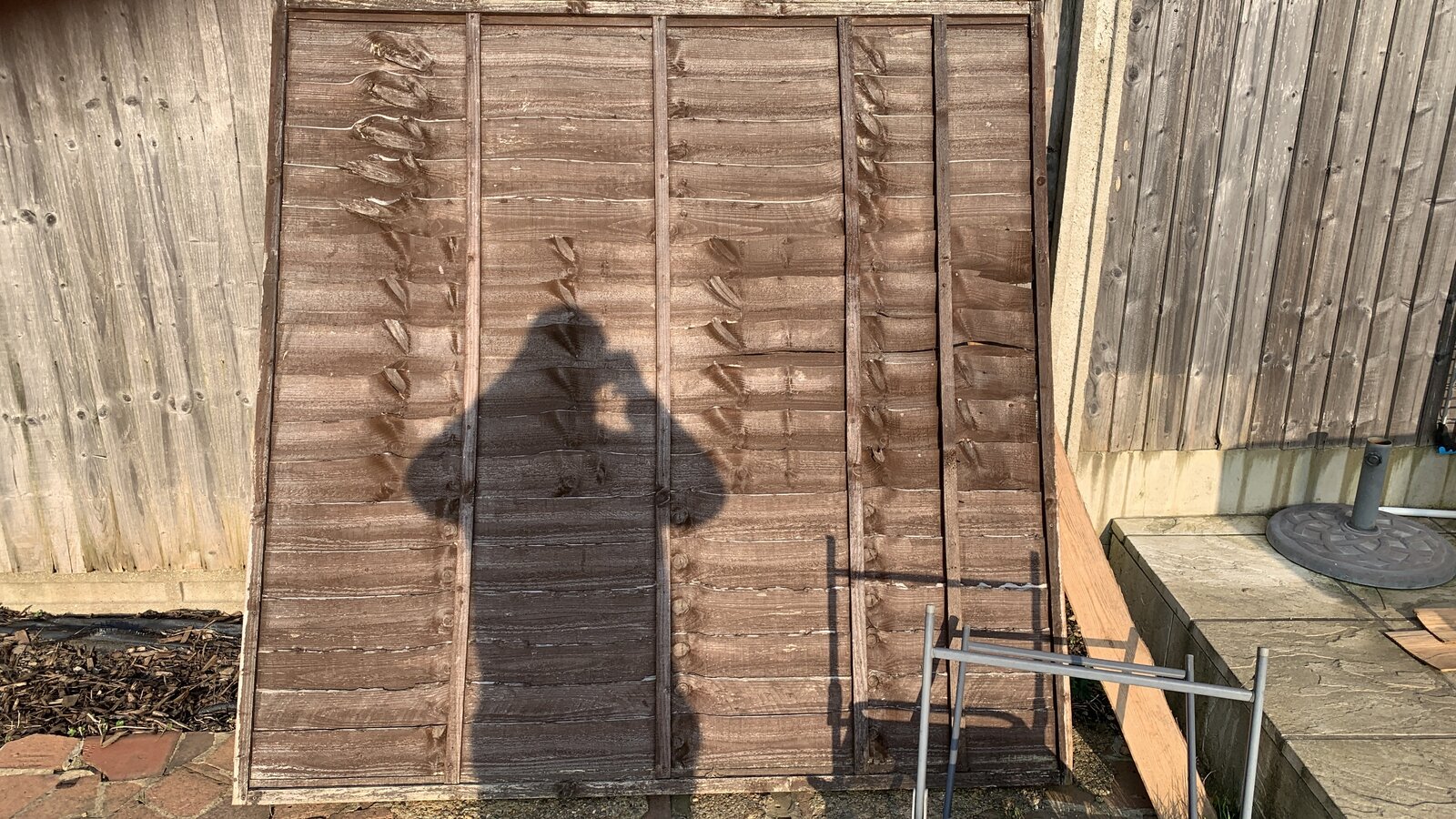

when the cap starts to fail i remove and replace with chamfered 50x25 tile baton and that makes the panels fairly indestructible along with replacing the other timbers with 19x38mm tile baton as required
but the fence cap is the one when it fails the panels bow and fall out
and make sure there is no soil or other detritus touching the fence panel at the base
They're on gravelboards.
I heard that putting some brass screws on the base, to lift it from the gravelboard a few mm can prolong the life, as the base doesn't rot out so quick?
perhaps 3 felt nails much cheaper and much quicker will give you the 2/3mm separation
I'm going to re-enforce the panel joints with screws.

The main issue, seems to be the panels being blown out by high winds, where they only fit into a slot, in concrete posts. A horizontal timber, halfway up, one at each side, through bolted, helps to reinforce them. In addition - some sort of lashing through the panel edge, around the post, can help keep them in place.
Other than that, the panels in the photo are not the most robust design. The curved top ones tend to be better quality, and are also much heavier.
[EDIT] I would also make sure they do not sit on soil. Bricks/ blocks, or even better those concrete base panels. An H shaped metal bracket, located in the middle, between concrete and fence panel can also help resist 'blow out' in high winds.

To add to the previous answers, putting screws through the fence edge battens, from one side to the other, helps reduces the panels being loosened, by wind pulling the nails out.
