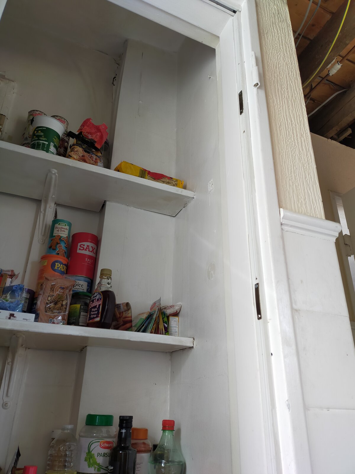

And these 2 , that form some sort of cupboard in the corner .
https://ibb.co/ykzcVW4
https://ibb.co/WVpD6kR
https://ibb.co/Pm3MQVf
What i tried to show in last 2 pics , is that the RSJ is sitting on a padstone , and obviously only remove the wall just up to padstone .
https://ibb.co/3p30cpG
https://ibb.co/wgR8dXn
This is one of the joists from flat roof that spans between external walls .
Any thoughts please ?
cheers .
Wall that makes up utility area can just be removed, the wall with the rsj you need to make sure the padstone is at the end of the wall with the lounge window in and not in the wall you want to remove
easiest way will be to remove 4 inches of plasterwork along the top of that wall and see what's there, inside the cupboard will probably be tidier for you, if the padstone is in the lounge wall then removing that cupboard should make no difference to the rsj albeit you may get some slight settlement once the wall is removed but nothing will fall down
Great!
Was assuming so, just wanted to ask for another opinion
This is the inside of cupboard and padstone ends on the small half brick 'column'.
I'll only take it off up to padstone.
I'll get going then.
Thank you :)
