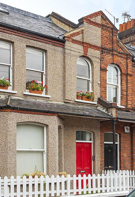

Hello All, I've decided I just can't live with the vile pebble dashing on the front of my smallish, 2 story house anymore. I just had a quote of just under 5K and whilst I don't think that's outrageous, I just can't afford anything like it. So, (you guessed it), I'd like to have a go at it myself. I'm a painter & decorator by trade and can do most things to a reasonable standard, but never have I done anything like this before.
A place up the road had their PD removed and apart from the big 'hack off' which took them a good while. I noticed they were restoring each brick afterwards with a kind of filler. Would it be reasonable to assume they were using a good quality ext' filler and a powder brick colour dye in it? Then of course they re-pointed.
Any advice and opinions on this will be greatly appreciated. Cheers..

based on the neighbors house, it looks like a 9 inch solid wall. Have you thought about external insulation as an option ? it might look odd next to your neighbors but could leave you with a smooth render and warmer home.
I can't unfortunately, it's a terraced house and a conservation area where I am. This PD is 70/80 years old. I was thinking of rendering over it all, but my worry is I then get told to take it off again by the council after the neighbours have complained to them. So I either leave it as is (not an option as I hate it) paint it a reasonable white, or off-white colour, or hack it off.

Yes and that's a concern for me too, painting is a reasonable compromise and one I might end up making. There's no reason to expect the brick to be in any worse condition than all the other houses in the terrace. It should be OK underneath. I know the place up the road had their Pd taken off and it made a mess of the brick work underneath. I've found a few brick restoration places online, but they dont say what products they use (quite understandably). I'm wondering how to go about restoring the bricks that will inevitably get scarred by the chisel marks my hacking the Pd off will create?
It depends on how much of a key the dash has got on the wall.If the guys did the job properly then you will probably lose most of the face's off the brick work. Or if by chance the never keyed the dash in well, then it might come off in sheets!! But having said that it looks like they knew what they were doing. Why not paint it brick colour?

Painting any masonry is the wrong thing to do - painting any kind of render is even more problematic, painting your dashed render will bring you nothing but future knock-on difficulties. Not to mention expense.
The exposed surface is in excellent condition based on the photo - why would you want to do anything with it?
Believe me, no matter how you mess with it you will make things worse.
To my knowledge, there are no products that will "restore bricks" to anything like an original colour or face surface. Most "restorers" are acidic or aggressive. Sometimes cement colour powder is mixed as a mortar and applied to spelched brick faces - it doesn't last.
