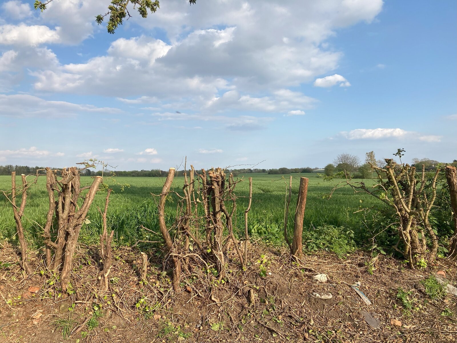

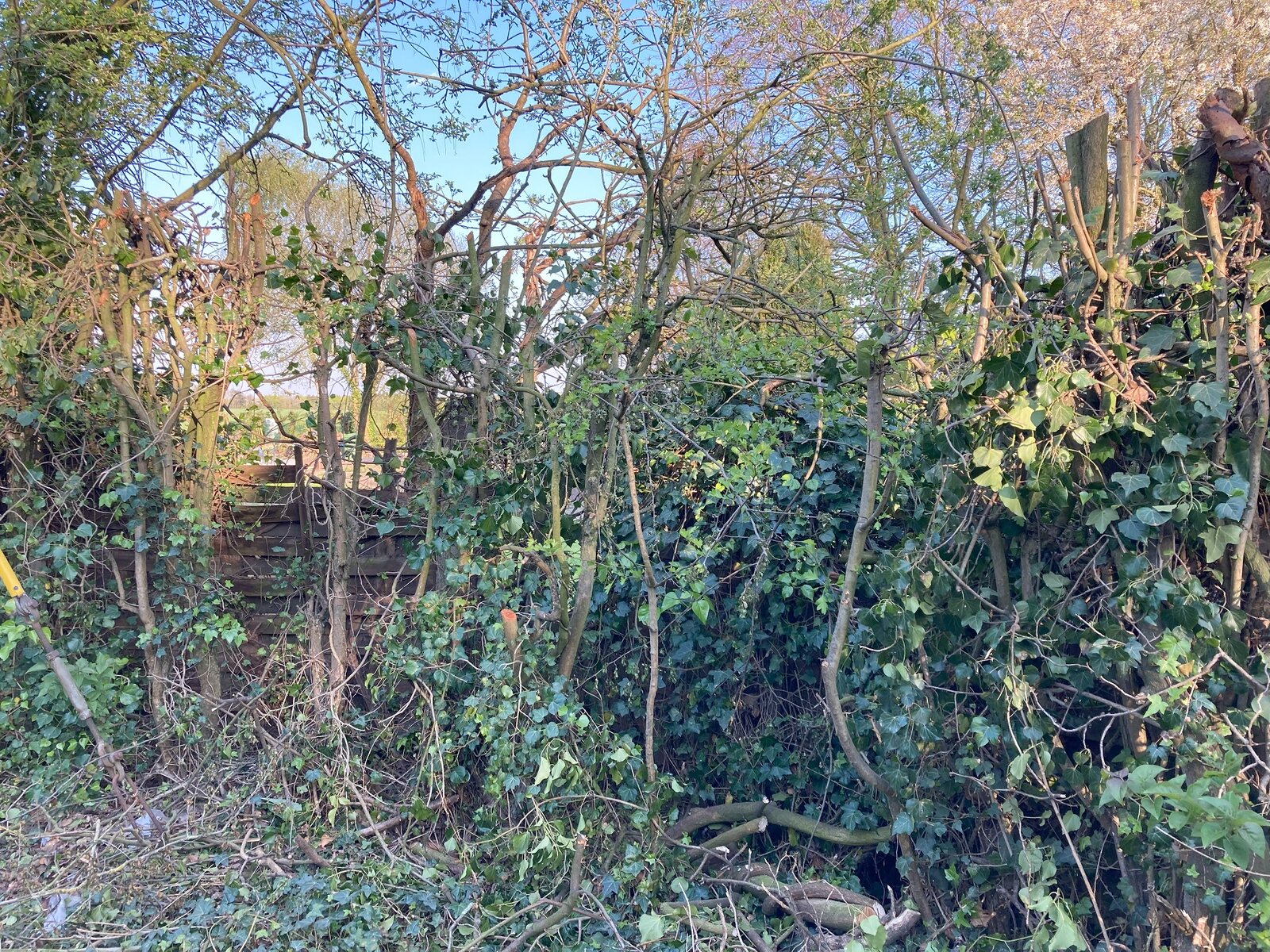

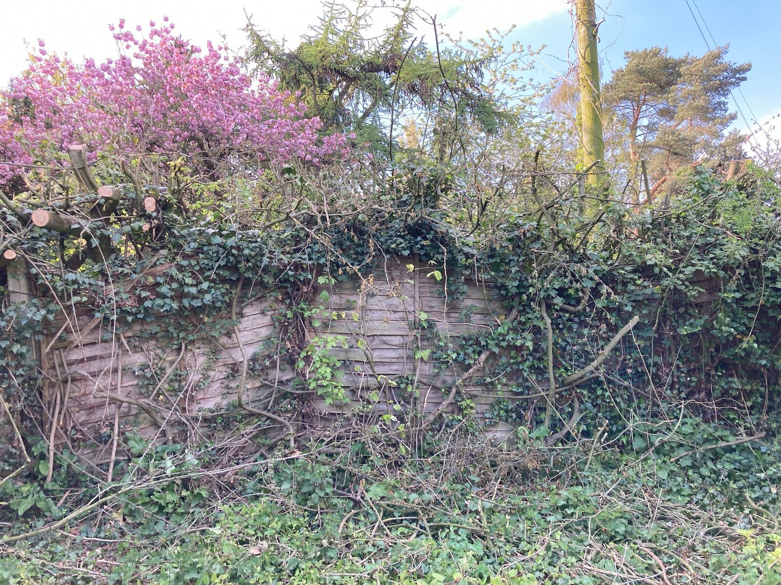

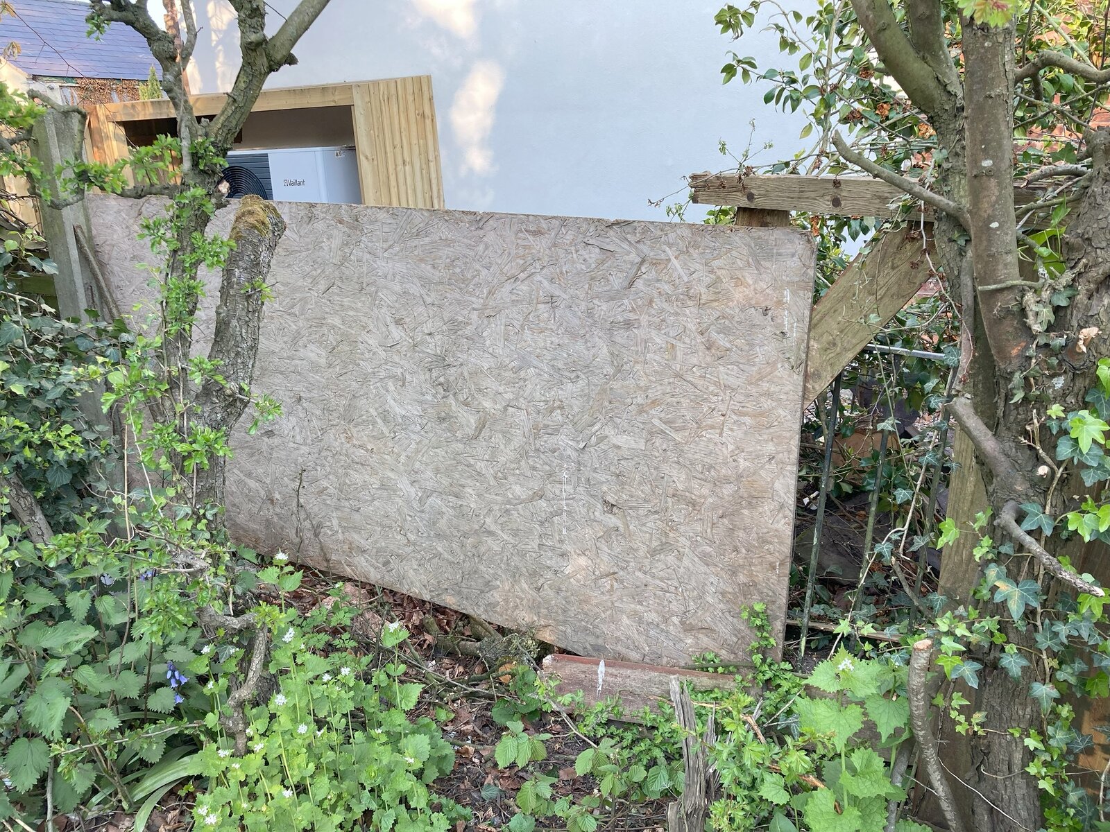

Sorry about the delay with this - I was waiting for the gardener to top off the hedges before I could provide any meaningful pictures. I've attached three: 2432 is from the garden side, 2438 and 2440 are from outside. As you can see, there are large gaps which I don't think can be fixed by laying the hedge. I just don't like the idea of removing everything other than the hawthorn because there will be nothing left in some areas and I don't know how long it would take to fill the gaps with new plants. I haven't had any luck with hawthorn cuttings either so I'll have to buy them in no doubt. I've done the other side of the garden's hedges easily but that side opens out to a farmer's field picture 2427, so the resulting gaps actually ironically make it look better and they're already showing new growth.

Personally, I wouldn't have cut thorns.
Normally they should be left and layered across the gaps as low to the ground as possible so the new growth grows vertical This coupled with some new planting and dead hedging fills the gap.

I'd say 50% of the hawthorn was dead anyway as it was completely strangled by huge amounts of ivy. Most of the large gaps are because we'd pulled (with almost no resistance) the old hawthorn that was rotten. The resulting gaps were/are just too large to layer it but I take your point on the stuff that's 7' high. Unfortunately, once I've pulled all of the ivy and magnolia away, and once I've removed the young trees (sycamore, etc.), we'll be left with huge gaps again and it's impossible to get all of the ivy out whilst saving much of the hawthorn. Most of it is rotten anyway because the ivy's already killed it - lack of light I guess.
Having said all that, it's the first time I've ever done something like this. I'm sure you would have done a much better and more informed job than me (you probably don't have the same level of horror I have looking at it!) but there's no-one locally that I could get to do it - I asked the local farmer but they could only suggest replanting the lot or putting a fence up. On the farmer's field side, some of the hawthorn is already regrowing strongly so I can try layering that and hopefully get a bit of practice before attempting the other side :)

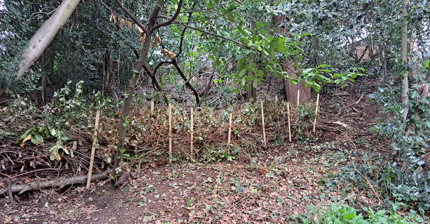

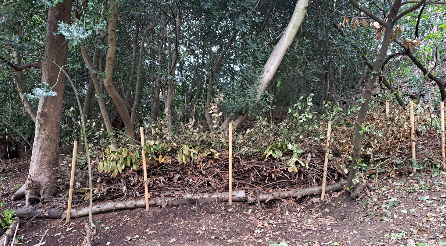

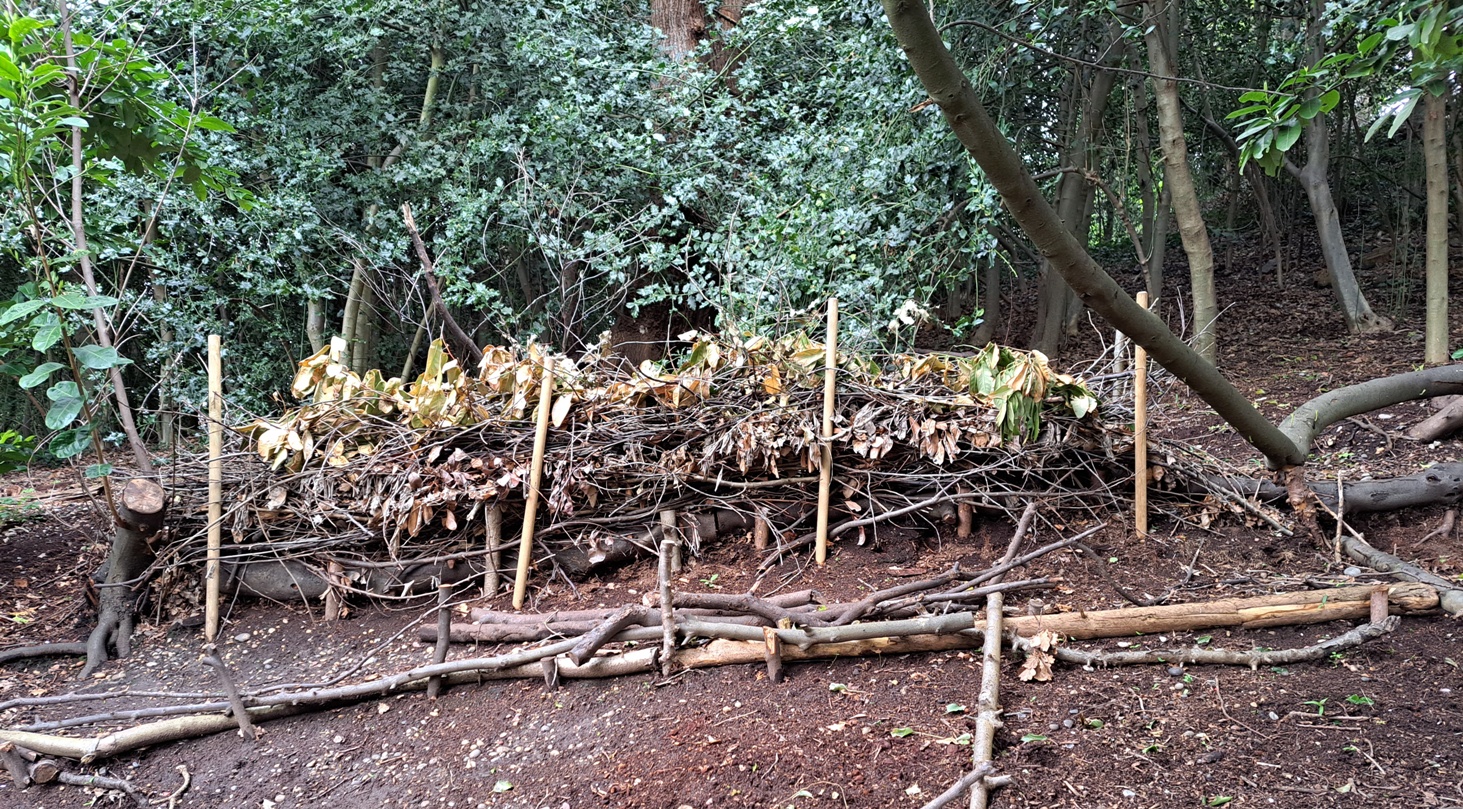

I have just finished a section of this in my garden, so below are some photos.
The boundary was a mess; a couple of panels, some wire (ordinary & barbed) and some chestnut paling. Most of this had fallen down or been pulled down by ivy. What I have now might not be tidy, but it is lot better than what was there beforehand.
As well as marking the boundary in a somewhat better fashion I wanted something to stabilise the ground a bit. It slopes down from R to L and also towards the POV.
I pulled / cut off the ivy, bundled it up an put it in as the bottom layer. That was layered in but the branches were poked in at a shallow angle to try and make them catch and so cause the whole mass hang together. I got this from a mate who has done dead hedging at an English Heritage place, that is how he was taught to do it.
The photos are L to R, going uphill.
