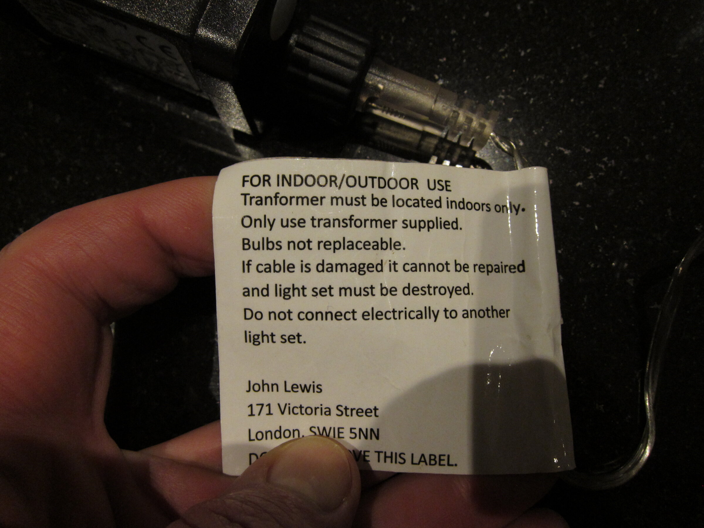

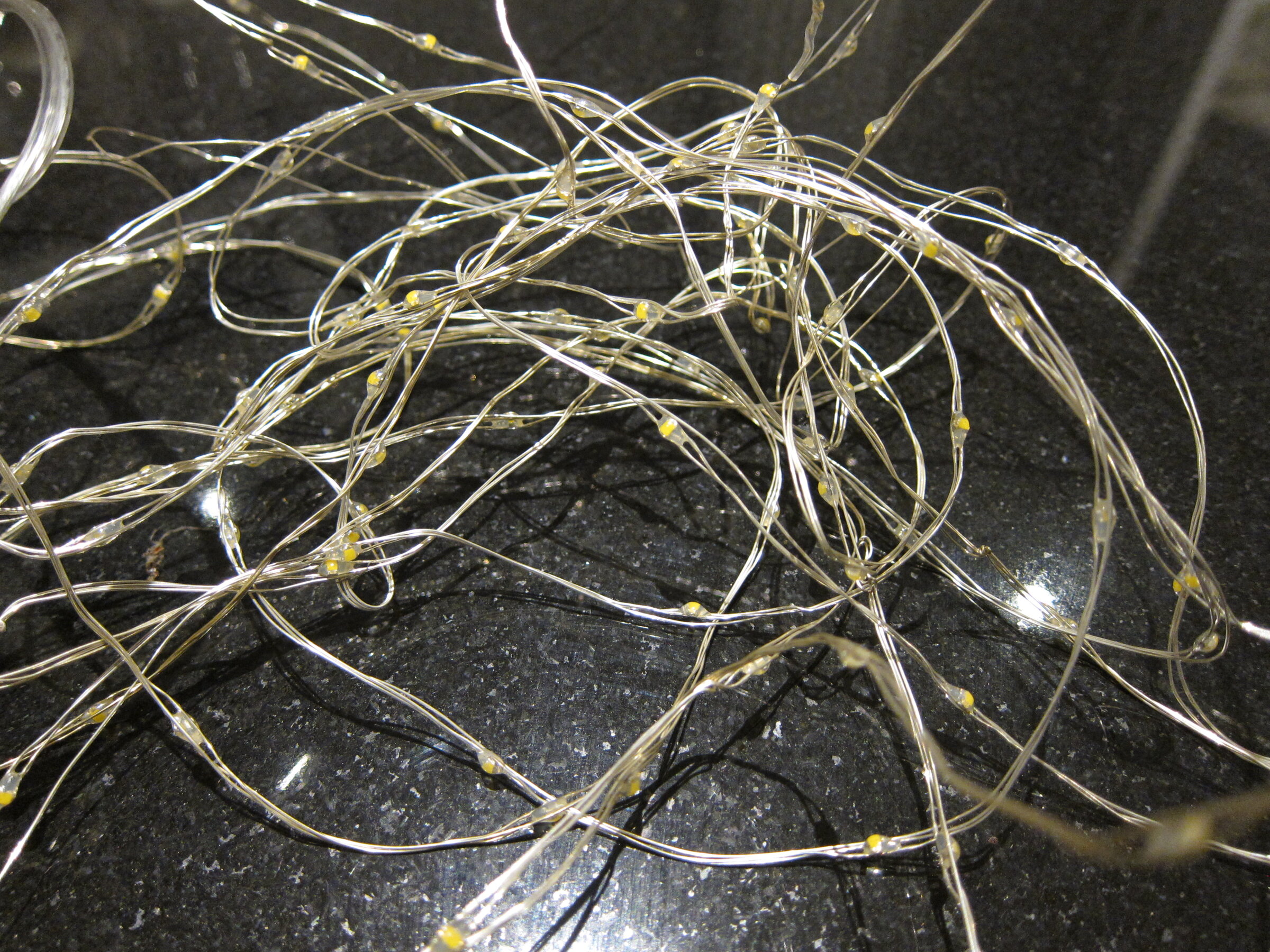

Hello, I have these very delicate John Lewis xmas lights where the cable has broken and I want to know if they are repairable as I've only had them 2 years.
The label says definitely not but I wanted to run it past you guys before I throw them in the bin. They have broken where the plastic sheath ends and the lights start (there is no plastic sheath on the lights).
Thankyou.
I'd repair them. 4.5vdc wouldnt worry me.
Depends how how you'll repair it. I'd solder the cables and use some amalgamating rubber tape round the join.
I guess a choc block would also be ok...
If its only 2 wires, and you know whats what polarity wise, i personally would join them, as there an outdoor set they are likely just saying that water or damp may be a problem if the cables damaged.

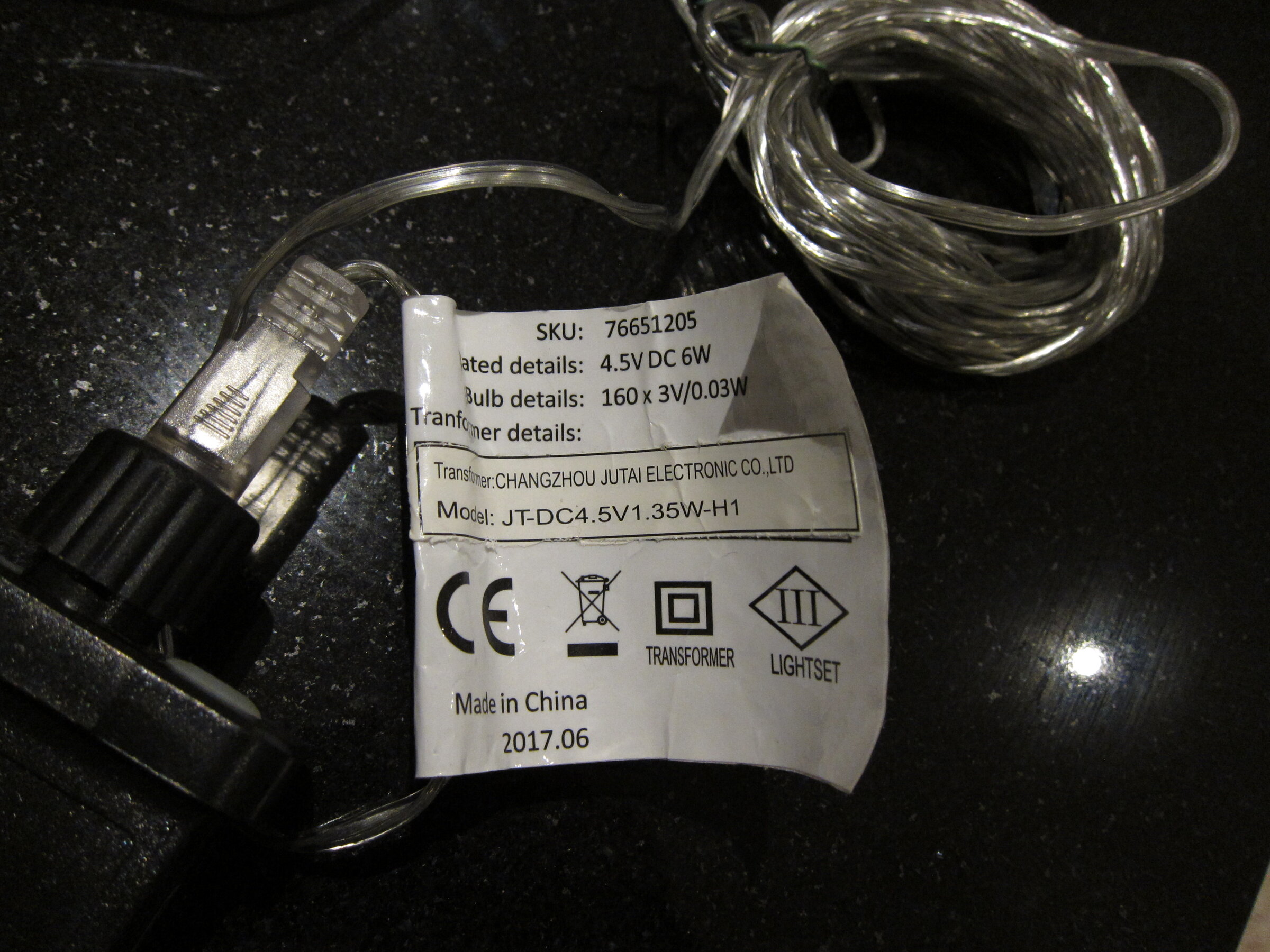

I assume the wire is not mains voltage and they connect to a transformer, likely about 24 volt output so i do not see any real danger of joining them
Edit
4.5 volt

Only because of the such low voltage, theres higher voltages in childrens toys, do not do this normally

I would solder them for a proper joint, then heat-shrink, or hot melt glue to seal them, even Araldite would work. See if they might be polarity sensitive, try to rejoin by seeing if one wire is marked in some way, sometimes an edge or different texture on one wire, sometimes a white line.
