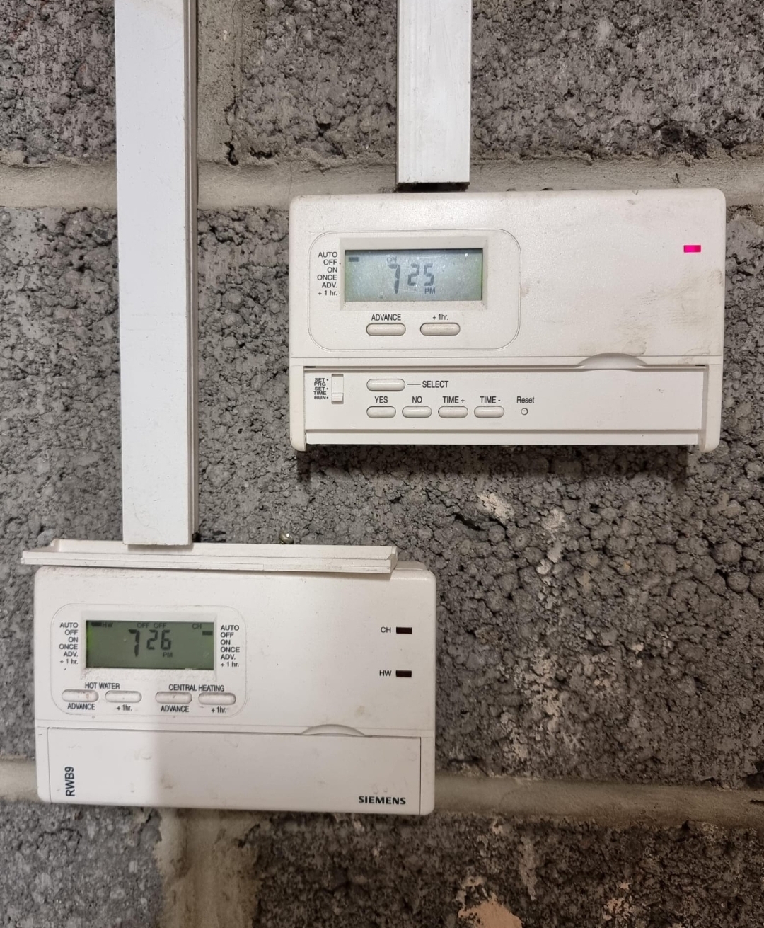

I currently have dual zone heating in the house with a system boiler and tank. A thermostat upstairs and one downstairs. There are 2 Siemens programmers near the boiler, one for heating downstairs and water, and the other for upstairs.
I want to replace the existing system with a smart Drayton wiser 3 channel Kit. Normally they seem to say just remove the old programmer and put the hub there, but in this case I have 2 programmers. How would the Drayton Hub be installed? I have posted a picture for reference to current programmers.
Thanks for the help.
After carrying out safe isolation, you would need to cut the cable back so they're of equal length and you'd need to put the relevant wires in the relevant terminals, but you would also need to remove a permanent live and permanent neutral unless they can be safely isolated (I'm unsure of this as not an electrician).

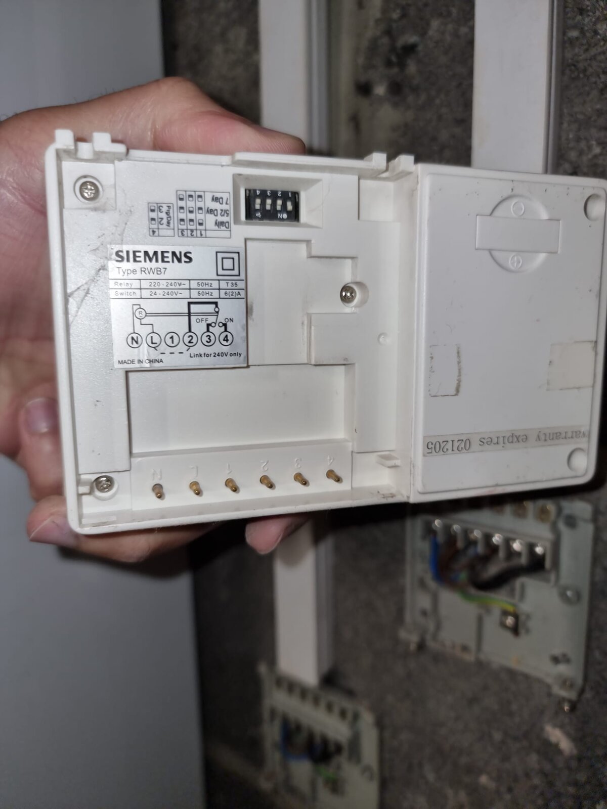

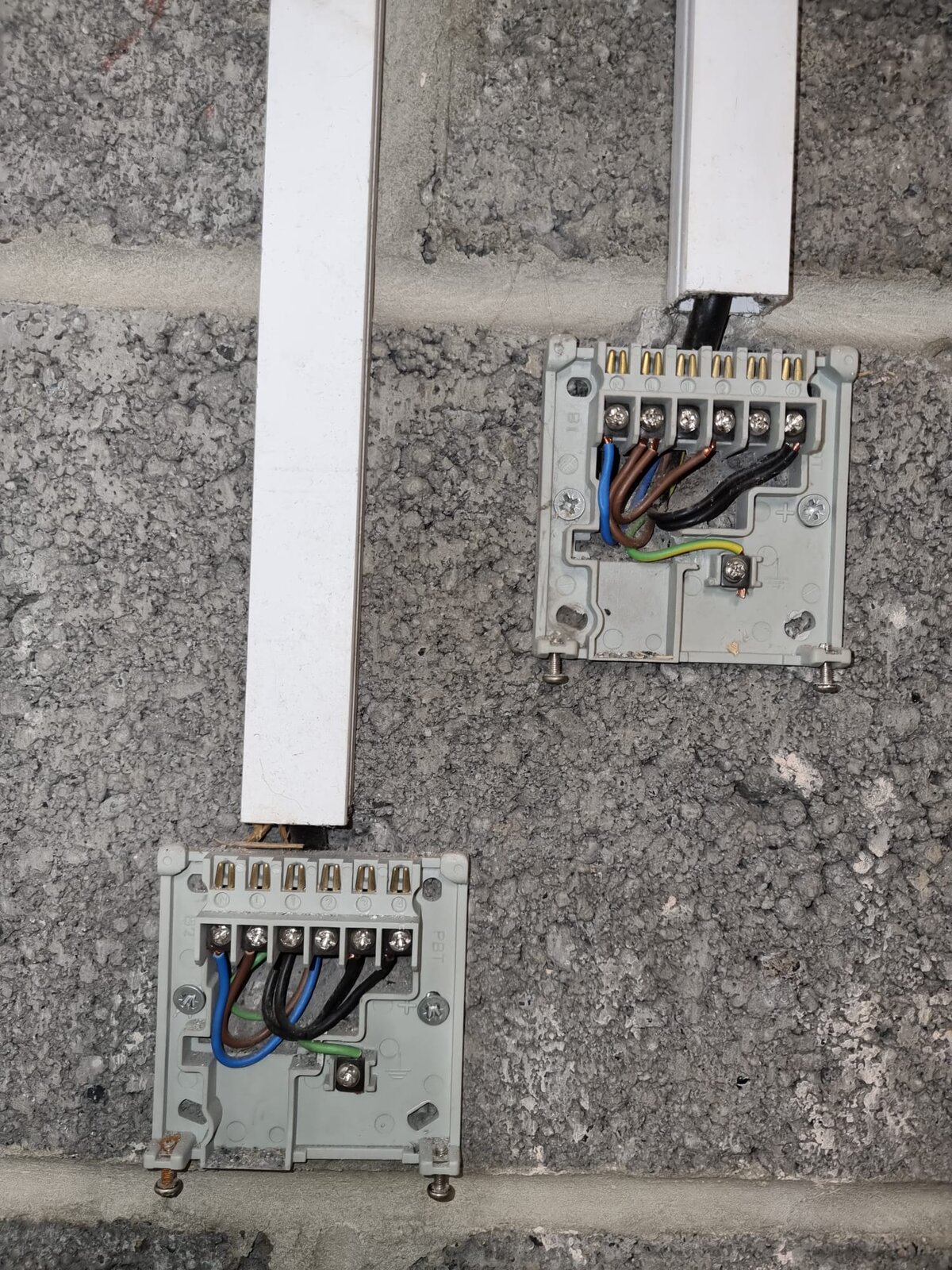

I have attached additional pictures showing the wiring underneath the programmers. The one programmer being the upstairs heating only. Wiring of bottom plate is for downstairs heating and water, while other is for upstairs heating.
Either trade would be fine, as long as they’re competent. If you’re to do this yourself, ensure you can safely isolate, cut back the left hand one (looking at it) to match the level of the other, then it would be transfer the wires over, minus one set of live and neutral, and no link.

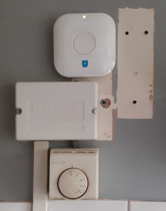

It will likely take some working out, if I was doing it likely I would fit a junction box (some times called a wiring centre) at end of trunking to bring both together and give some room to work in with the Drayton unit either to side or under it. New_wiring_centre_etc.jpg This is how I did it, as Nest has very little room inside.

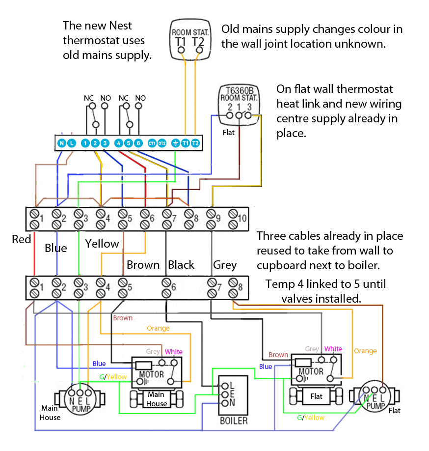

You need to plan it out on paper, you are unlikely to remember it all, and if you come to change something latter good to be able to look back this is mine C_Plan_My_HouseD.jpgmy mistake was I did not put a version on them, and now can't remember which one I used.

I would not bother studying my system, it is C Plan and designed to work with my oil boiler, it was just how I laid it out on paper so I could return later and know what did what. Yours is likely a lot simpler, what messed mine up was two pumps.
