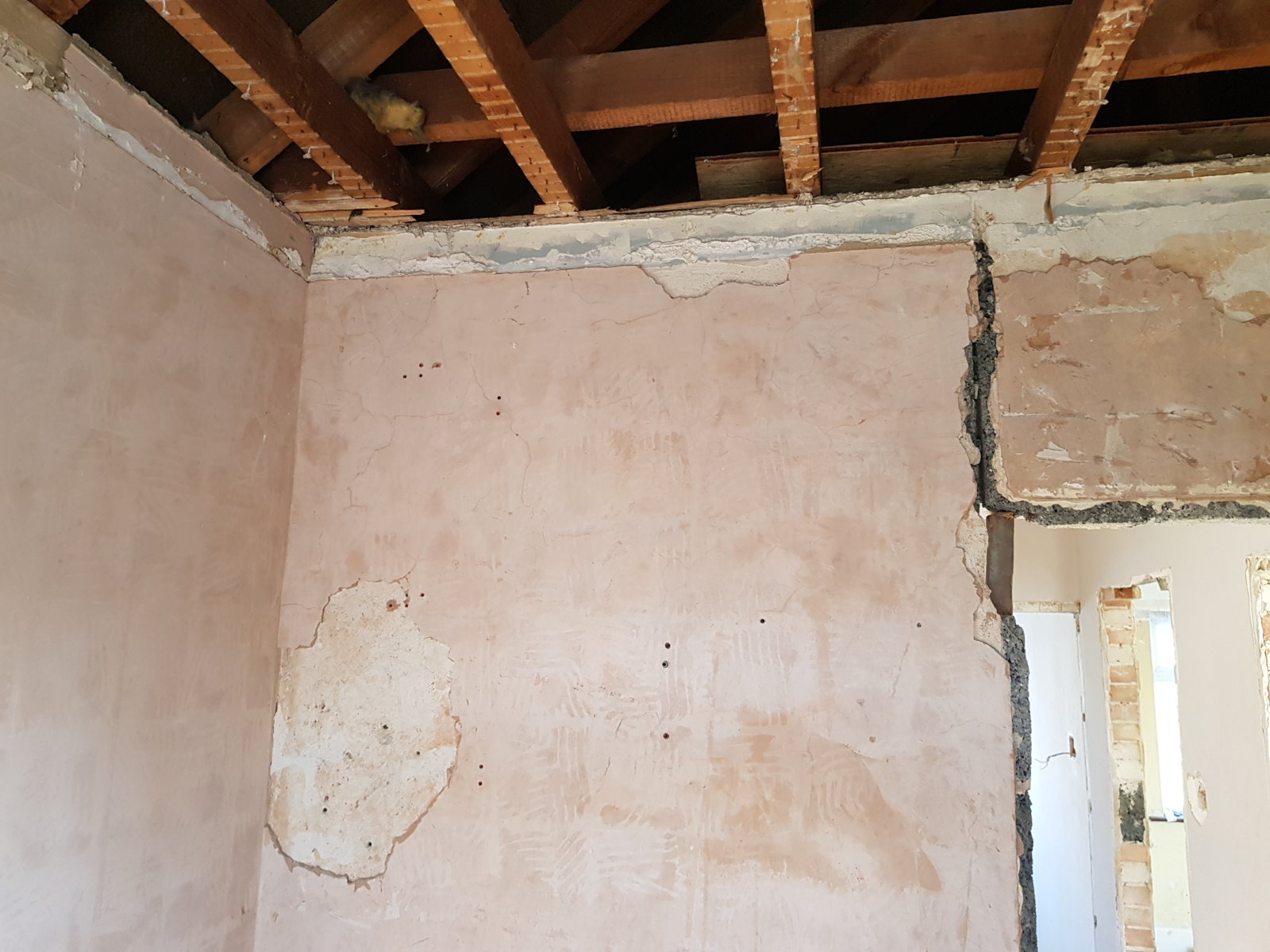

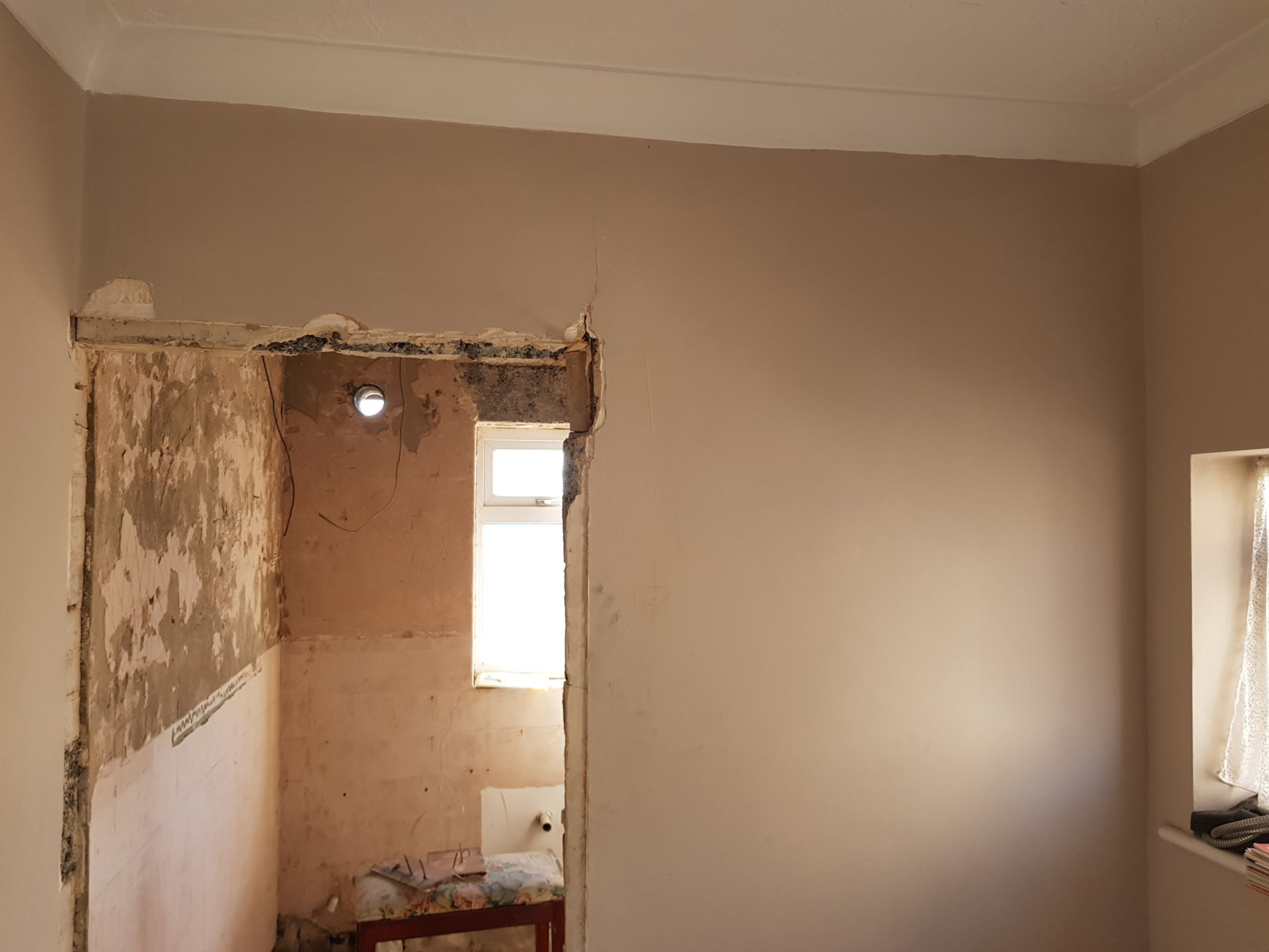

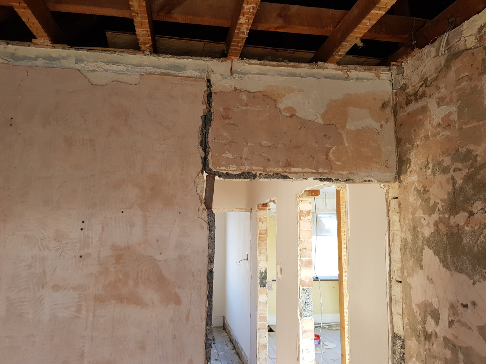

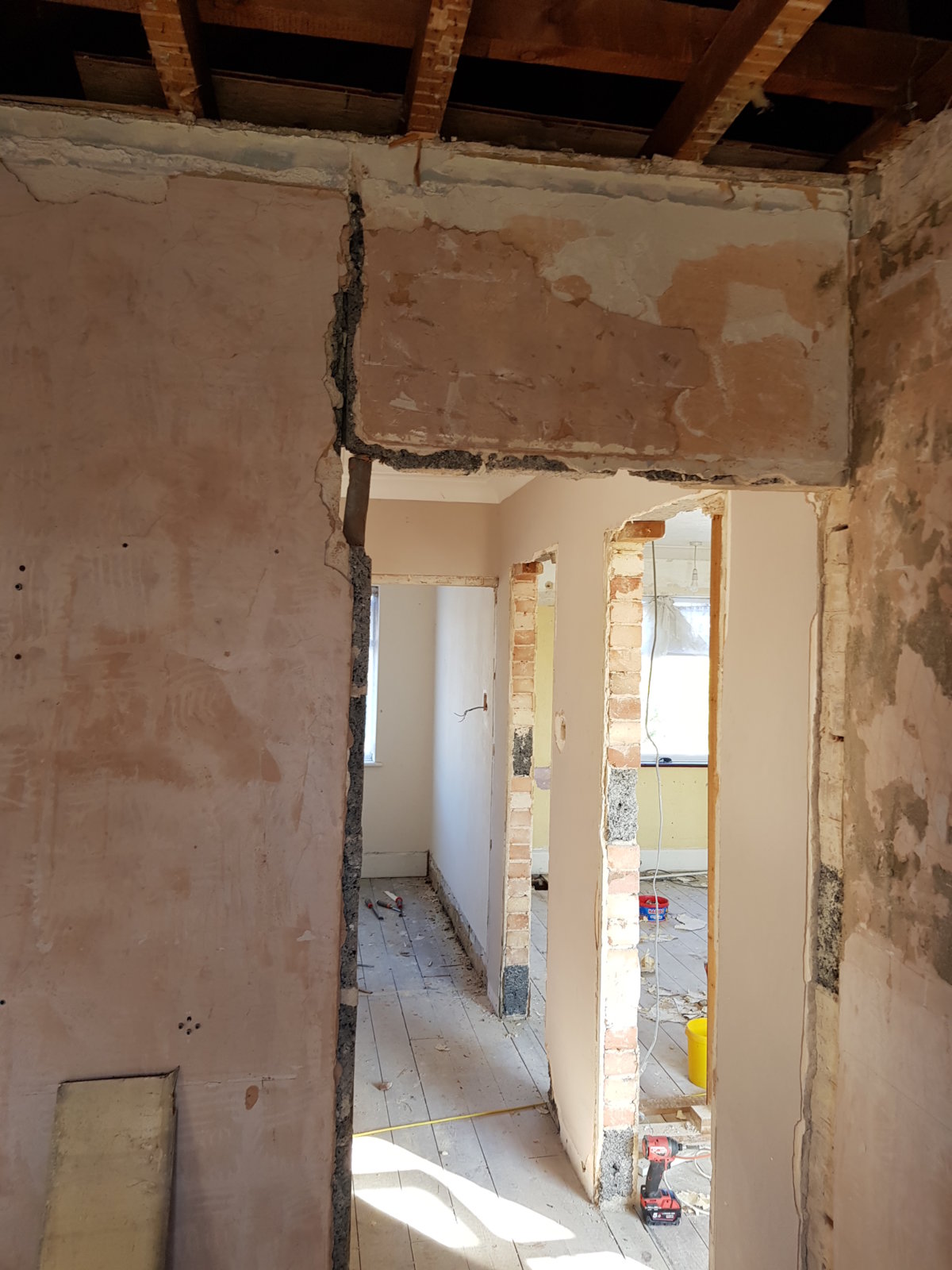

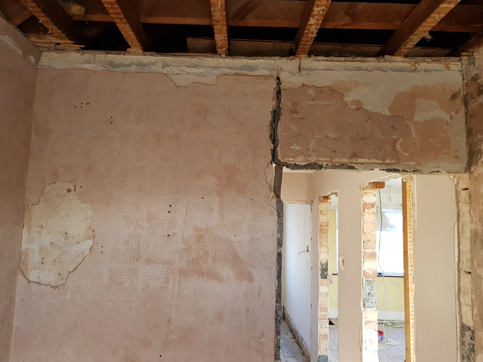

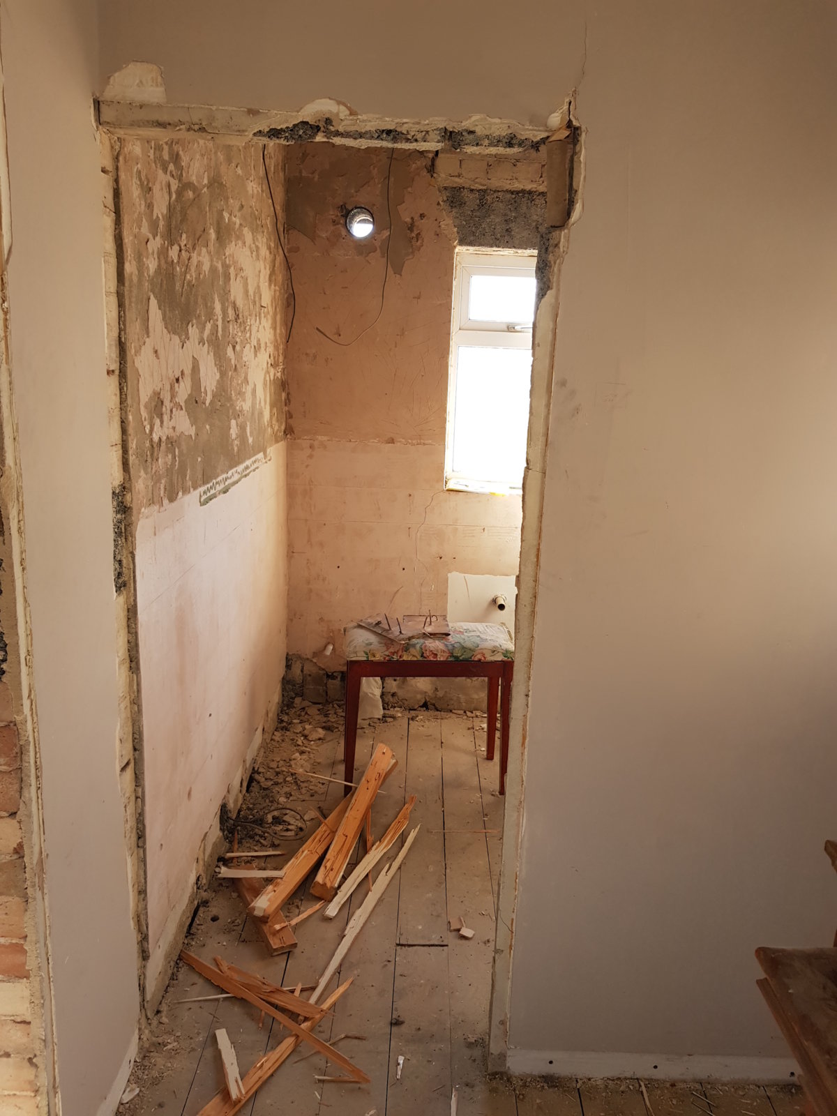

I`m in the middle of renovation and new thing come out.
I have removed the old architrave of my upstair bathroom and small bedroom to find out that the door opening is very low and also the lintel is not properly installed and that was the reason of a visible crack on the wall. Also the door opening is close to the wall not allowing any architrave. I have attached photos for refreence.
My dilemma is. is it worth to start playing around this 70mm blockwork to move the structure opening and install new lintel or just demolish and install a new strong wood stud wall with maybe some extra noggin or plywood?

Doesn't look like there is any lintel there.
As far as I can make out the blockwork was supported off the door frame, removing the rest of blocks and installing stud work would be the easiest option.

A dog would have done a better job to be completely honest with you.
I don`t think wall this has any structure input but based on your experience would like someone to share their experience on these case and be sure can remove these blockwork and replace with stud wall.
Presume you mean partition wall ,not party wall, but why would you want to remove the whole wall rather than just fill in above the door opening :?:
Because look like more work on installing the lintel plus moving the opening 150mm to the right side as at moment there is no room for an architrave. Also not easy to find a 70mm blockwork and re hard plastering and skimming on it.
