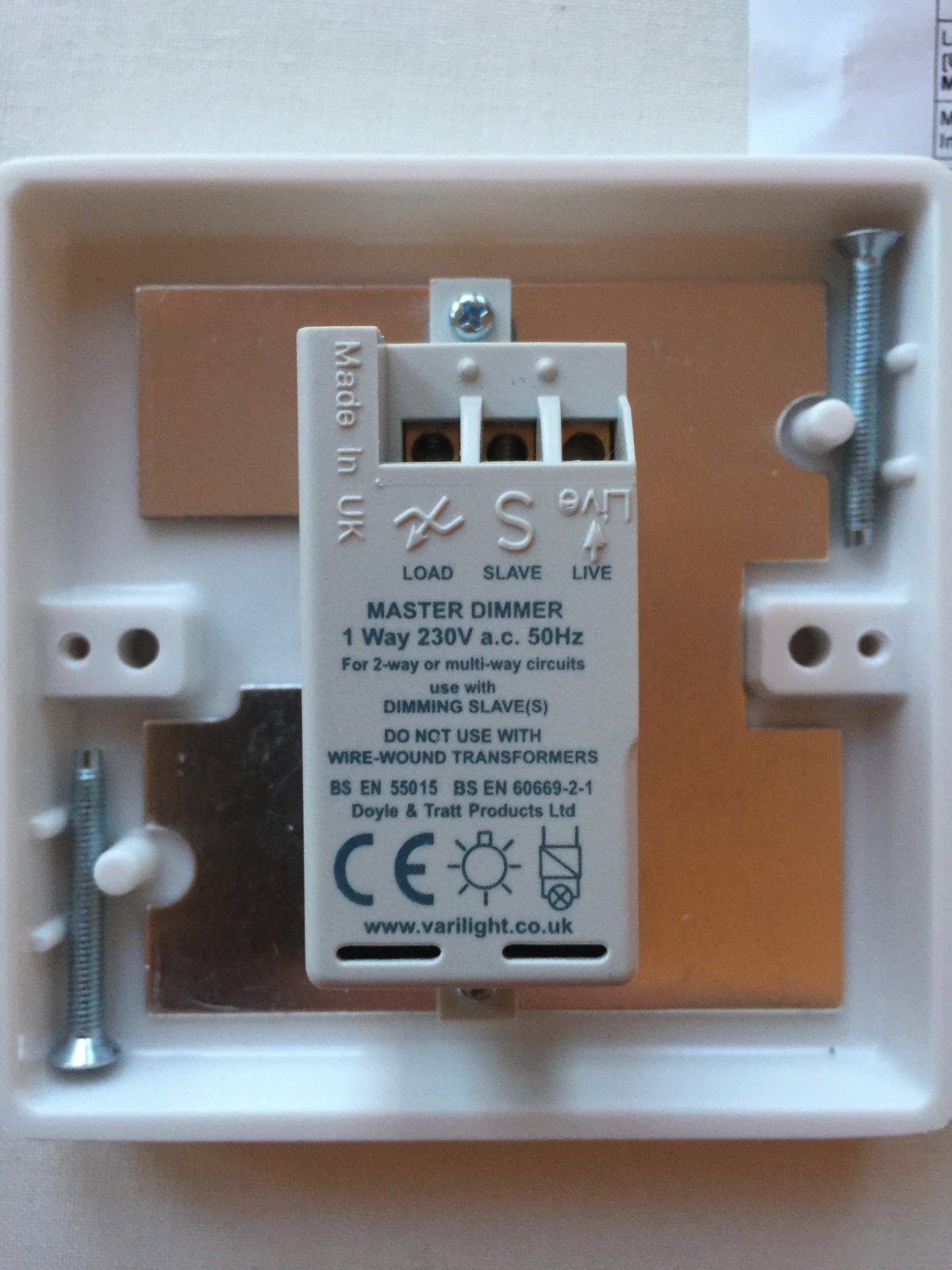

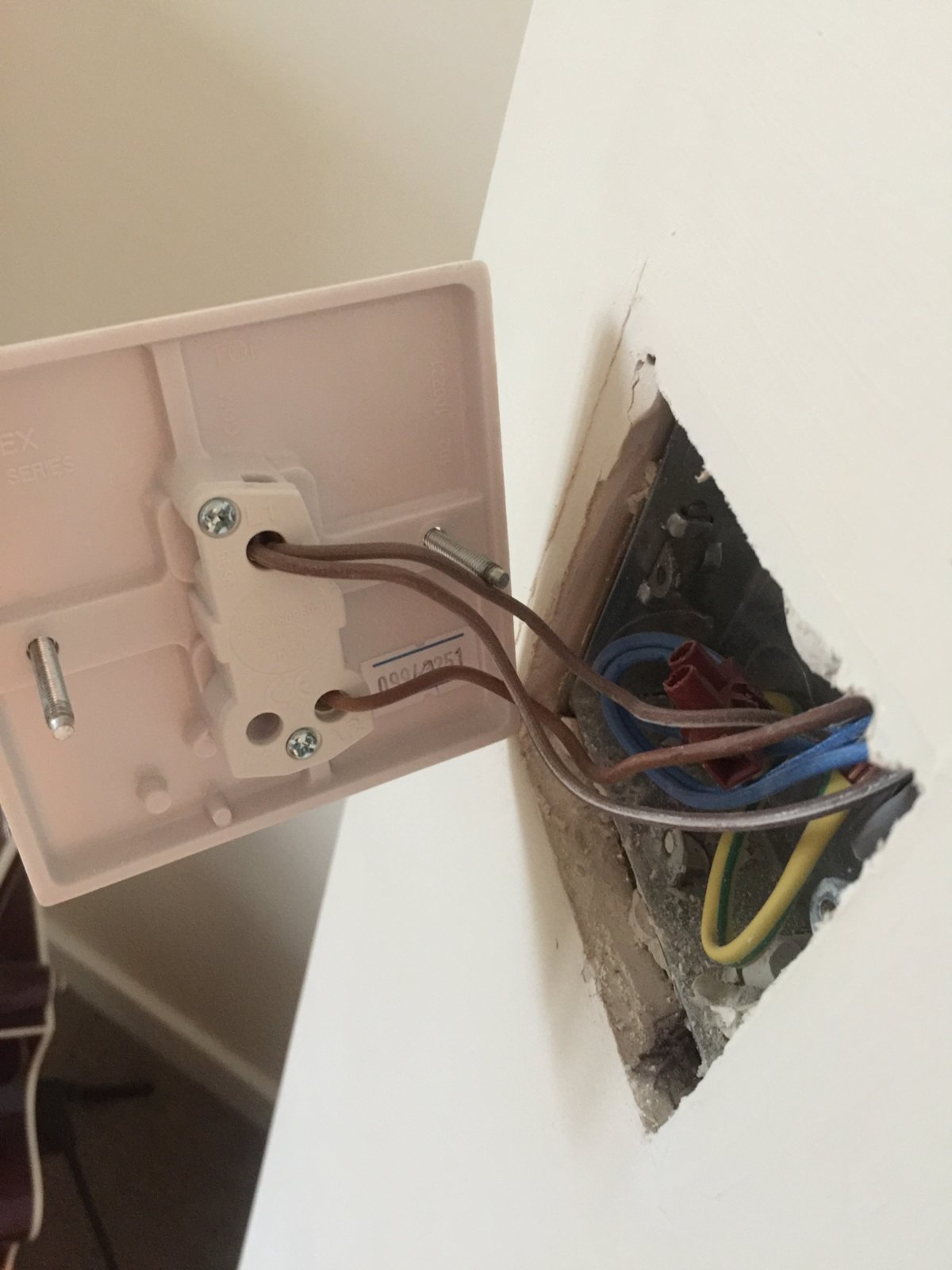

The current switch has two brown wires into the L1 port at the top of the switch (which also has the word "COM" moulded on the plate near the L1 connection), and a single brown wire connected to the L2 port. I've installed a dimmer in the kitchen and was able to just match up the L1's and L2's etc... However the new Varilight dimmer doesn't have any COM, or L1's, 2's and 3's, it had a LOAD, SLAVE and LIVE.
My guess would be the two brown wires currently in L1 should be connect to the new LIVE connector, and the single brown wire in L2 would go to LOAD on the new switch.

Here's the new switch:
(see attachment: IMG_7566.JPG)
And here's the existing switch, as wired currently:
(see attachment: IMG_7567.JPG)

The two wires that are together go into the terminal "live" and the other wire goes into terminal "load"

Yes, that diagram is just like my current switch say for the wire colour changes, but the one question those pictures don't answer is what does the new LOAD equate to in the old setup, mrwatsonxx is suggesting my two brown wires - current L1(COMmon) should connect to the new LIVE, while my old L2 connection (single brown wire) would be the LOAD.
I was just after clarification LOAD and LIVE equates to what from my old setup, but think mrwatsonxx has done that..
Thanks for all your help.

The load is the electricity-using part - the light.
He is very probably correct.
It could be a possibility that the single wire were the live and the two wires went to two lights.
Whichever, the wire that goes to the light.
With your old switch it doesn't matter which way round it is connected - it is just a switch which joins wires together.
