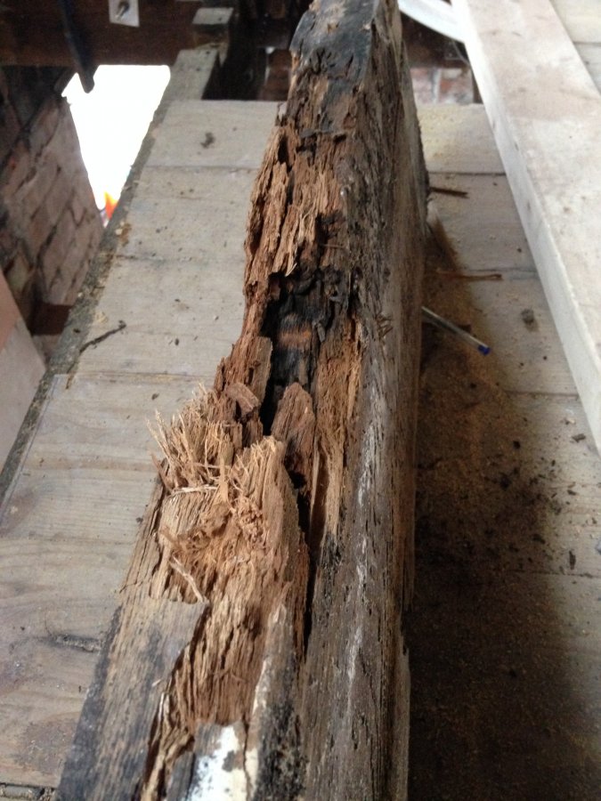

Hi,
My house is about 200 years old and the kitchen floor joists are supported in a solid stone wall. I`m replacing the kitchen, but unfortunately the previous owner had leaks from both the dishwasher and washing machine on the back wall which she never bothered to sort :(
Now i`ve fixed the leaks and its dried out a bit, some of the floorboards are obviously rotten (the washing machine on spin made sure it had pummeled its way through them!). On further inspection , it looks like the some of the joists in this area are rotten where they enter the wall - they feel spongy as if you could stick a screwdriver in there.
Whats the best way to repair them? Ideally, i would replace the entire joist, but the other end is also supported in another stone wall - i have no idea how i would manouvre the new joist into place once the old is removed. If thats not an option, can i repair the end of the joist somehow? In my head, i feel the joist would lose alot of its strength though by somehow splicing a new end onto it?

Here`s some pics anyway. I had a closer look - you can see the rotten boards which i just pulled up with my hands to get a closer look. They are 4 x 2 joists at 35mm centres over a 2.7m span so under spec'd really, but nevermind!
The one on the left is rotten about 30cm out from the wall, then it feels solid when i put my hand round under the floor. The joist on the right seems ok. There is another joist behind the washing machine which seemed a little similar when i had the washing machine out.
You can see the wall is damp, but this mainly comes from a combination of the previous leak, the solid stone walls rendered in gypsum plaster instead of lime and no extractor fan in the kitchen and no real ventilation at the mo. Outside, the wall is pretty dry. The stone walls are rough stone, not brick.
I`ve been reading some previous posts and seems a possibility may be that i can cut away from the end the rotten bit and then lap another joist timber along the good bit 1.2m of the existing joist. I can then bolt it together with some timber connectors between them. I `ll have to make a new pocket in the wall alongside the existing one, but it sounds doable.

There's evidence of previous remedial work and the joists appear to be sitting, or almost sitting, on the earth oversite - no ventilation air bricks are apparent in the external pic.
9" x 6" air bricks should be installed.
The rot appears to be of long standing - not the result of a recent leak.
Depending on what you expose, and please post pics on here, it might be necessary to lift the whole floor to provide through ventilation, remove all traces of fungal infection, & maybe lower the whole of the sub-soil and cover it with a membrane (to prevent oversite condensation).
The stained plaster behind the units is gypsum plaster - it should be a sand and lime render over a stone rubble wall. Is any surface cover really needed behind the units?
The external plinth is probably irrelevant and possibly causing moisture difficulties - at a minimum the render should be cut back 50mm from ground contact. FWIW: the render was probably applied in hope of preventing damp difficulties.

Had a bit of time tonight to pull out another cupboard and lift one of the floorboards which being tongue and groove are a right pain!
The wall is really damp and has been rendered in various coats over the years! I knocked some of the gypsum off which revealed cement ( i think) underneath and then once that was off, the wall below was soaking with moisture. What i think is the lime mortar in the wall (possibly!) is soft and damp.
I think the best thing here is going to be just knock all the top renders off and leave the wall to dry out. Given that the outside floor is the same level, i`m going to install a couple of telescopic air bricks which will pass thorugh the wall and then drop into the sub floor behind the units. I`ll also remove that external render too.
The subfloor itself is pretty dry actually - which is nice for once! There are a few inches gap under the joists aswell - at the wall there is bits of rubble, etc coming up to meet the joist at the wall which probably isn`t helping matters. Where the wall is damp, the ends of the joists look on their way out and quite a few will need repairing. The other side where the end is in the internal wall seems dry and ok. I `m considering bolting 6 x 2s to the current 4 x 2 joists to strengthen them and then bedding the end in a new hole in the external wall.

Would something like this possibly work?
Drawing obviously not to scale! But effectively lapping a 6 x 2 timber alongside a new 4 x 2 and the other 4 x2 end. This would be connected with bolts and timber dog teeth washer fasteners. I could then use the existing pocket once the wall had dried out with damp course membrance wrapped round the end.

1. If you use bolt-on's then keep to the same section: 6" x 2" (no 4" x 2") - the thing is you've not indicated any damage on the far wall of the kitchen - have you lifted any boards against that wall or seen damaged joist tails?
2. Is the water mains in a modern plastic pipe - it should not have a sharp ninety degree bend.
3. There are two steps down to the kitchen - is the house on a hill?
4. Typically, remove all units and apps from the floor to give work room - messing about with sink positions will waste time.
5. Is the wall 800mm solid?
6. Your rear elevation will need a few air bricks.
7. Photo #5 shows what appears to be dry rot tendrils - is that a vegetation?
8. All plaster/render should be removed back to stone - note the render is running down below the FFL to the sub soil: knock it all off.
