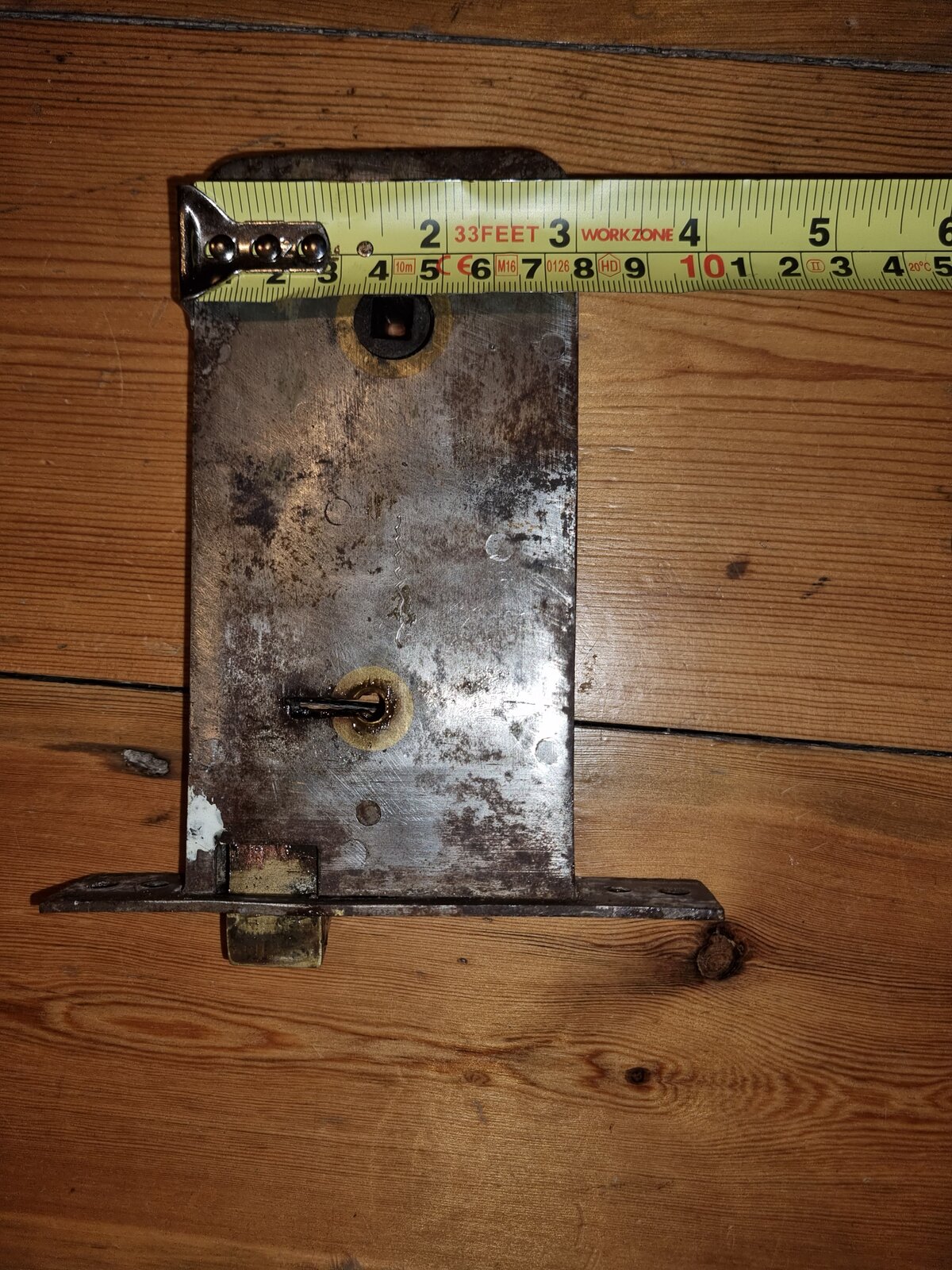

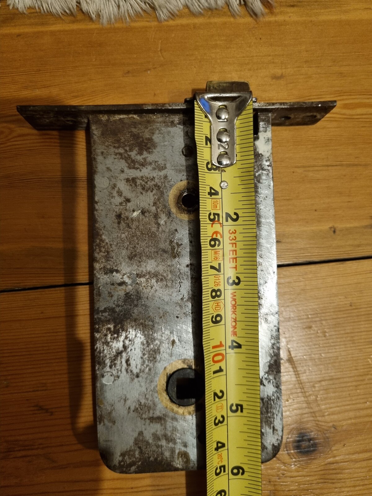

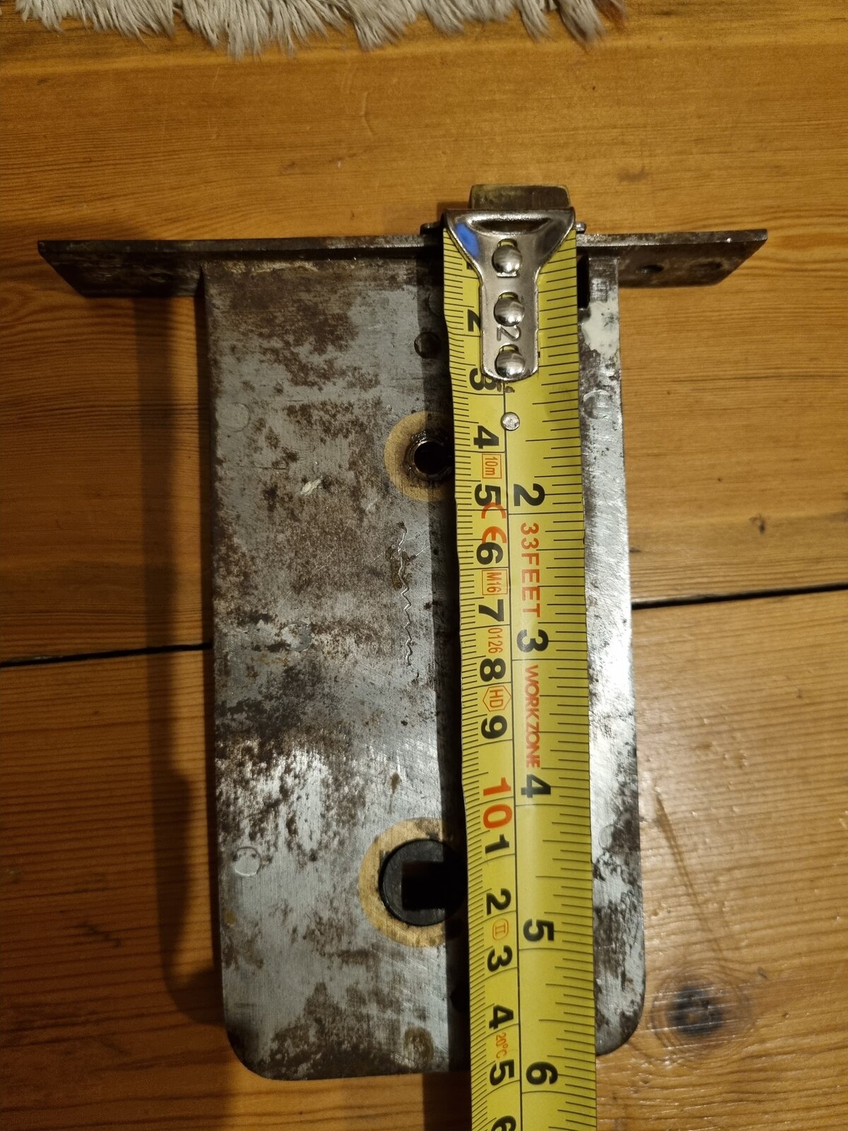

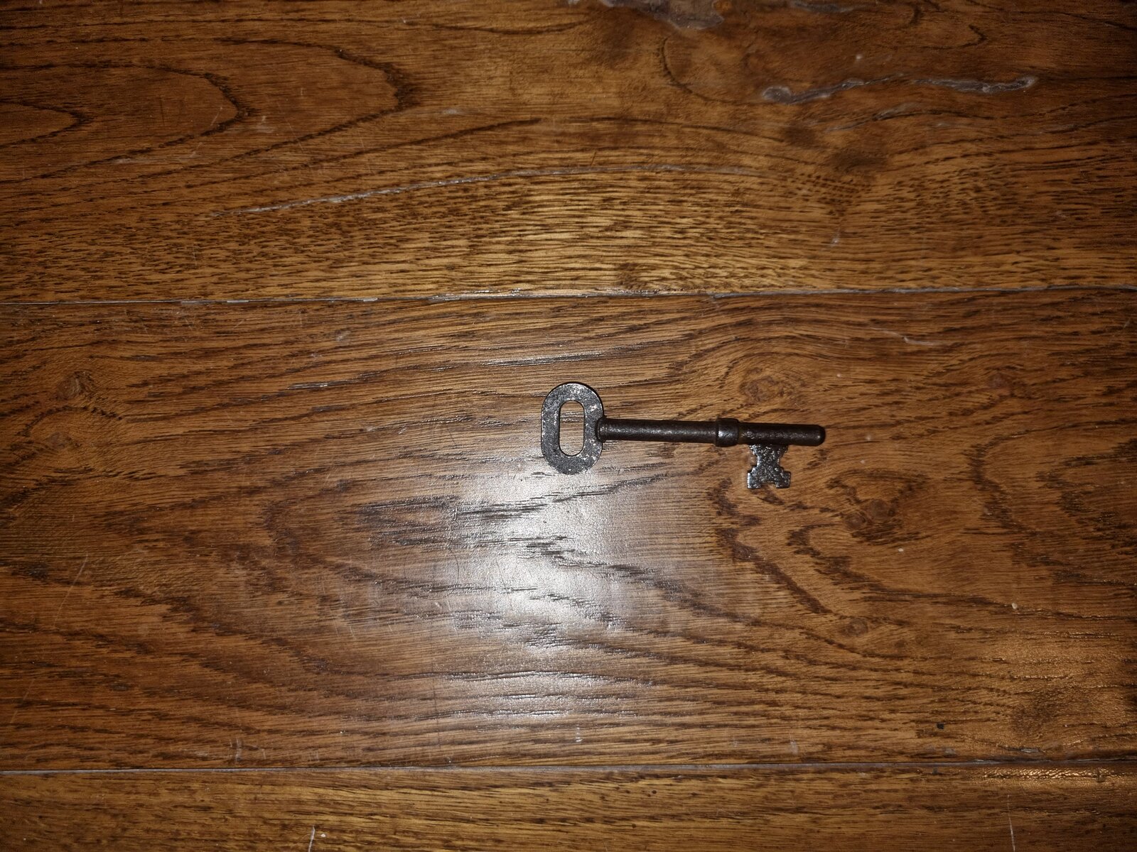

Hi,
I will be grateful for your help in trying to replace an old front door mortice lock.

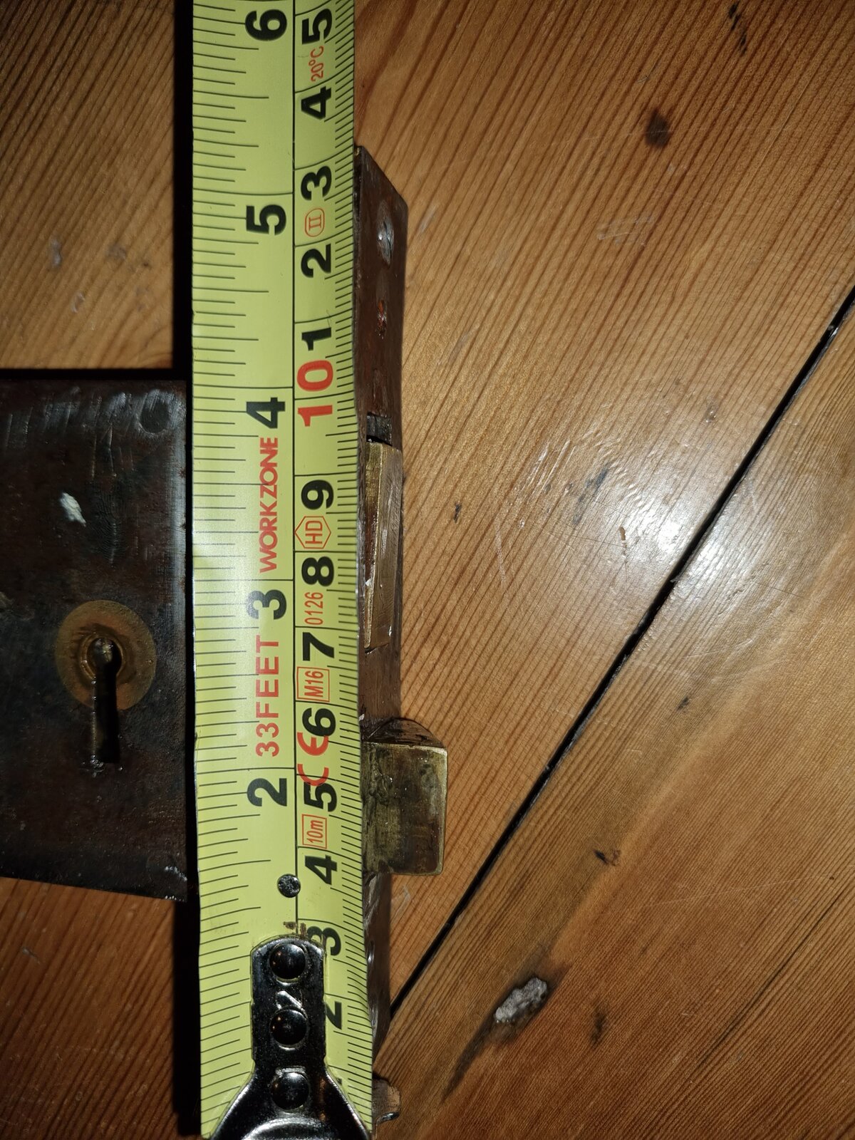

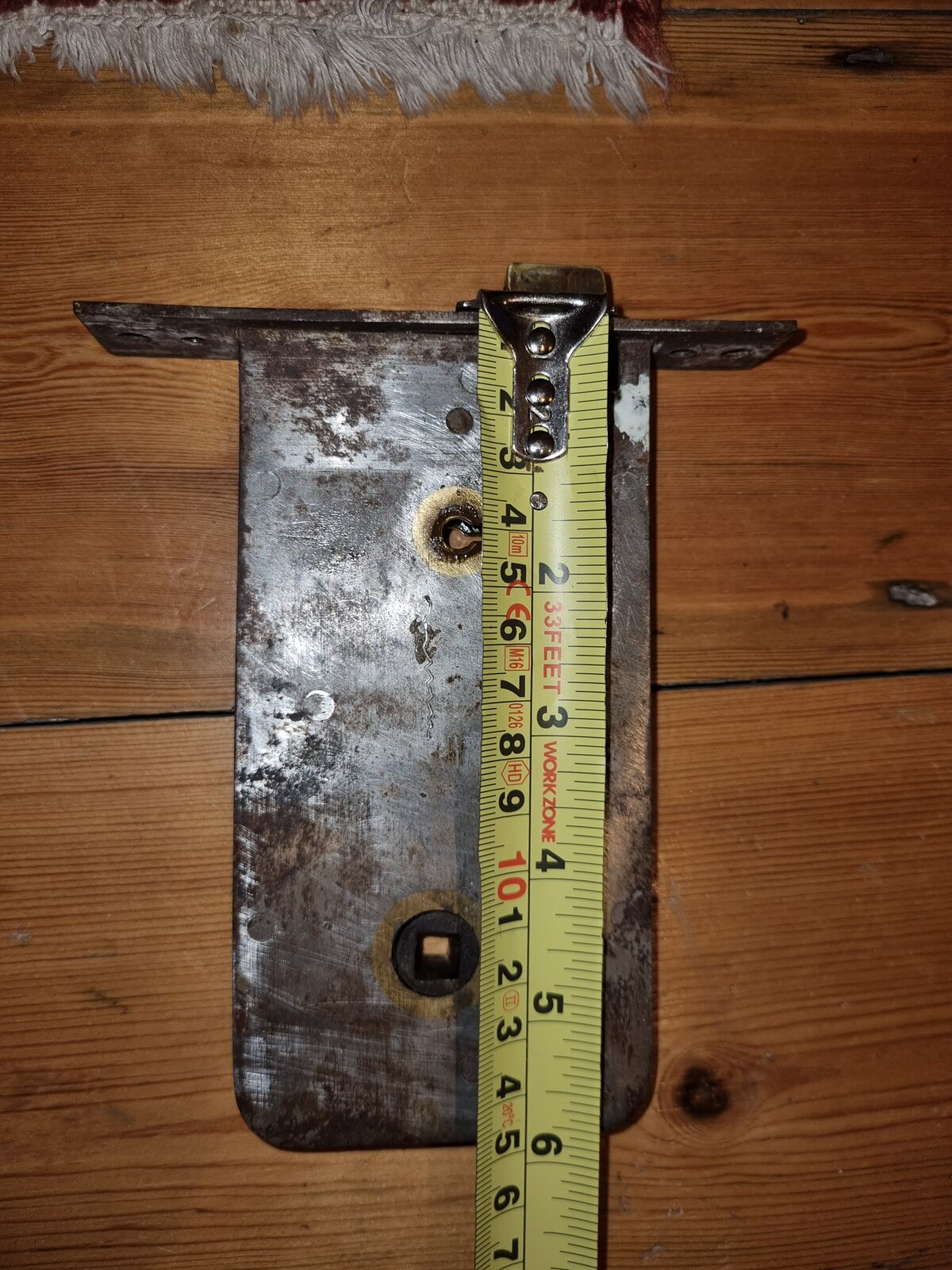

There are no markings on the lock & it measures 149mm/ 6 inches but the bracket is about 40 mm.
Ones I can see online have a backset if around 51-52 mm.

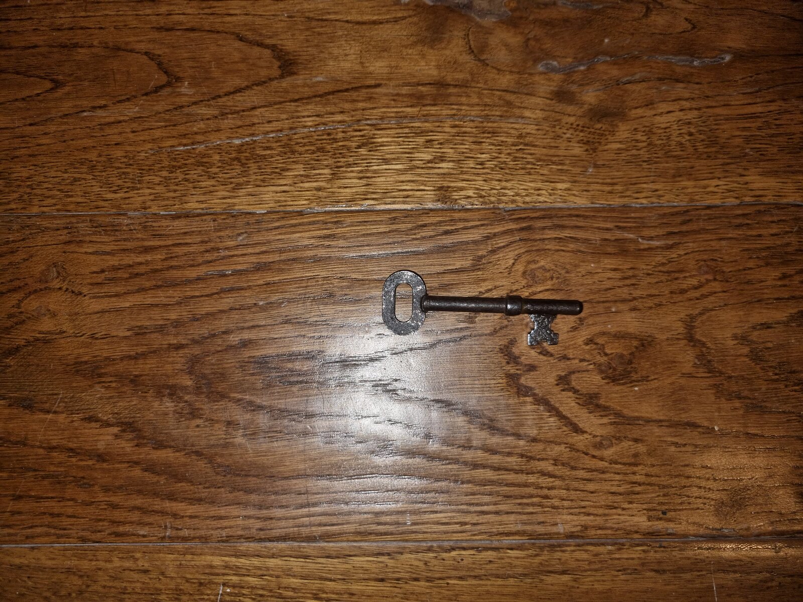

I am attaching the pictures of the lock with measurements & will be grateful for any ideas on trying to replace it.
Many thanks.

It is a 6-inch Victorian Horizontal Sashlock

The 3G115 is not the correct replacement.
Your lock is clearly made to Imperial measurements, the case is six inch and the knob backset is four inch. I can't make out the keyhole backset, it will be to a quarter-inch or possibly an eighth.

If you goggle for "Horizontal Sashlock" you will find ads, mostly for modern replicas. Three lever is adequate for internal locks, and much more secure than your old one, which is warded and probably has just one tumbler. You might need to shave out the mortice as they are a bit thicker. Check the measurements before purchase. There may be slight differences in heyhole and knob spindle position.

I just measured some of my stock
I have 6 inch cases, with 5 inch backset to knob spindle and 2 inch to keyhole
Modern replacements with 100mm knob and about 44mm to keyhole
Some others are in a crate somewhere, I think they are Legge.
I think this one (with 5 inch case) might suit. Look at the dimensioned drawing.
