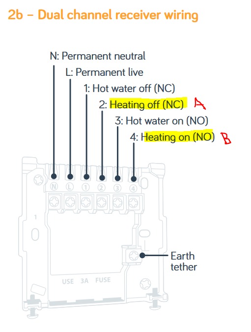

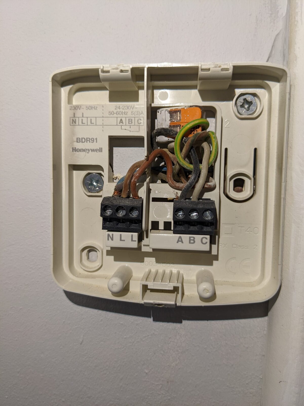

Hi All,
Apologies if this has already been answered earlier, but I cannot find a 100% confident answer.
I am replacing my old Honewell BDR91 with the new Hive Mini (dual channel) Thermostat. I have Baxi 400 combi boiler at home.
Attached image with my old Honewell BDR91 wiring, I have replaced it with the attached new Hive mini dual channel thermostat wiring.
I have replaced the old wiring:
A to 2: Heating off (NC)
B to 4: Heating on (NO)
is this the correct one?
Note - I don't have a hot water tank and using a combi boiler of Baxi (400)
Thanks,
Jigar

The switch in the BDR91 connects A to B to command the boiler to fire up.
The dual channel Hive has an internal connection to the switches so that the switches connect Live to send commands to the boiler.
That internal ( inside the Hive ) connection of the switches to Live may mean a dual channel Hive cannot be used to control your boiler.
You have the wrong version of Hive. The Dual channel is for a system with a hot water cylinder.
The BDR91 has the switching wires isolated from the mains supply, so change it for a Single Channel version then the wires in A & B go to terminals 1 & 3 (Common and Heating On)
You might be able to use the Dual Channel if your boiler is wired for 230V control with some modification to the wiring. If on the other hand your combi is wired for 24v control you can't, and if you tried, the results wouldn't be good. But you would never make any connection to CH off.

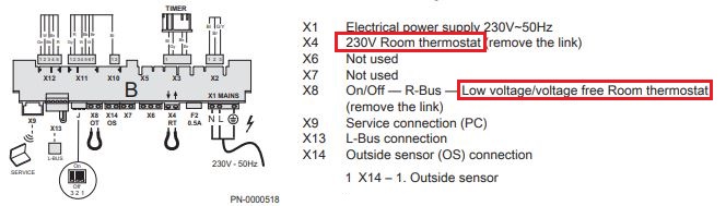

They are not silly questions, but unfortunately without knowing what is connected to the other end of the wires in A & B it's impossible to tell if it's 24v or 230V. Looking at a Baxi 400 series manual I've found on line, and assuming yours is the same, it can be wired for either 'low voltage' (24v) or 230V, depending on whether the wires to the BDR91 are connected to X4 or X8
If, and only if the boiler is wired for 230V, quite possibly it might work by connecting B to number 4, but it might be A to number 4 depending upon which way around the original installer has connected the wires to the terminals at the other end. [It doesn't matter with the BDR or Hive Single channel, as they have voltage free connections the wires will work either way around]
If it is wired to X8 the link can be reinserted and the wires moved to X4
