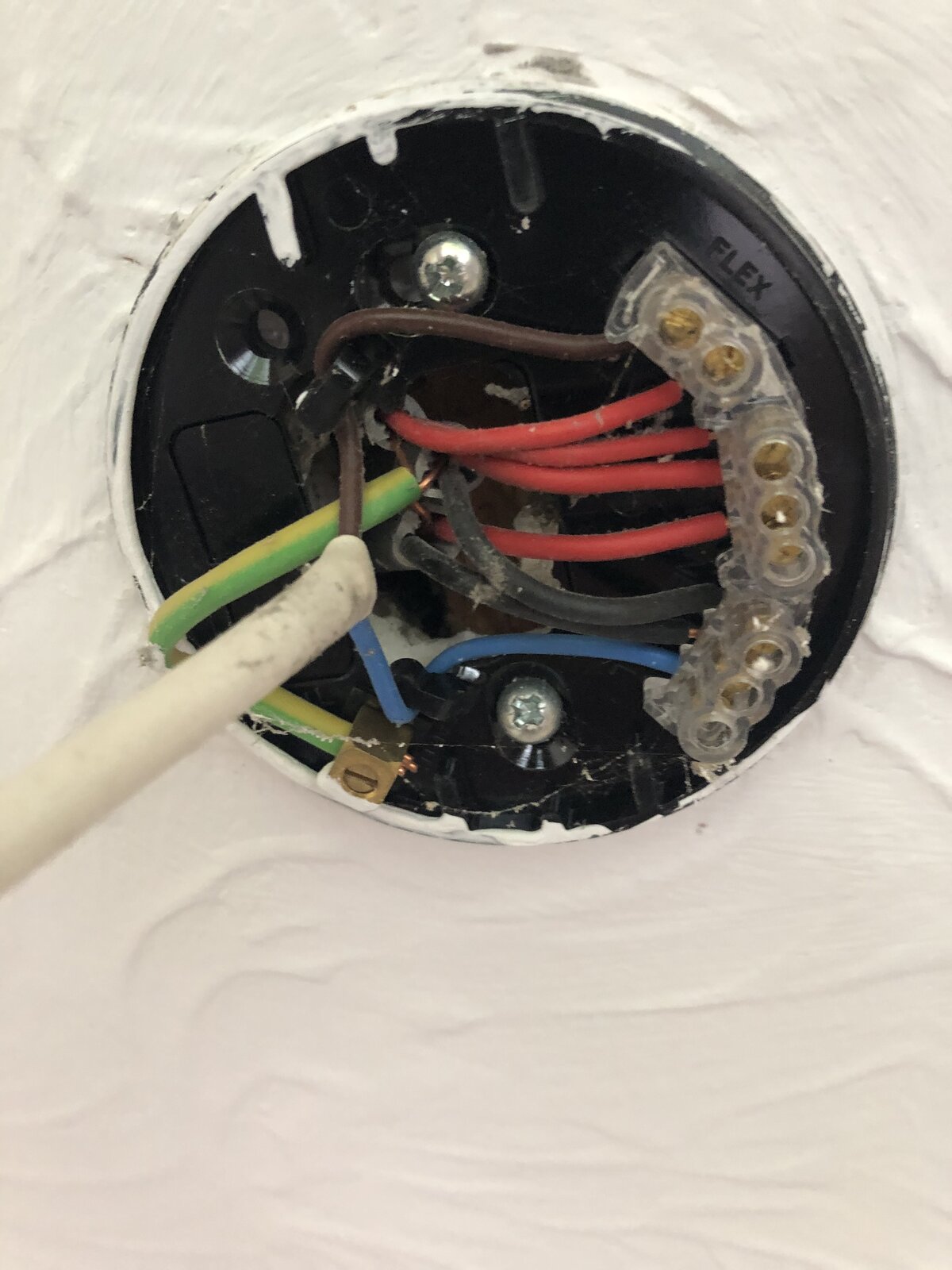

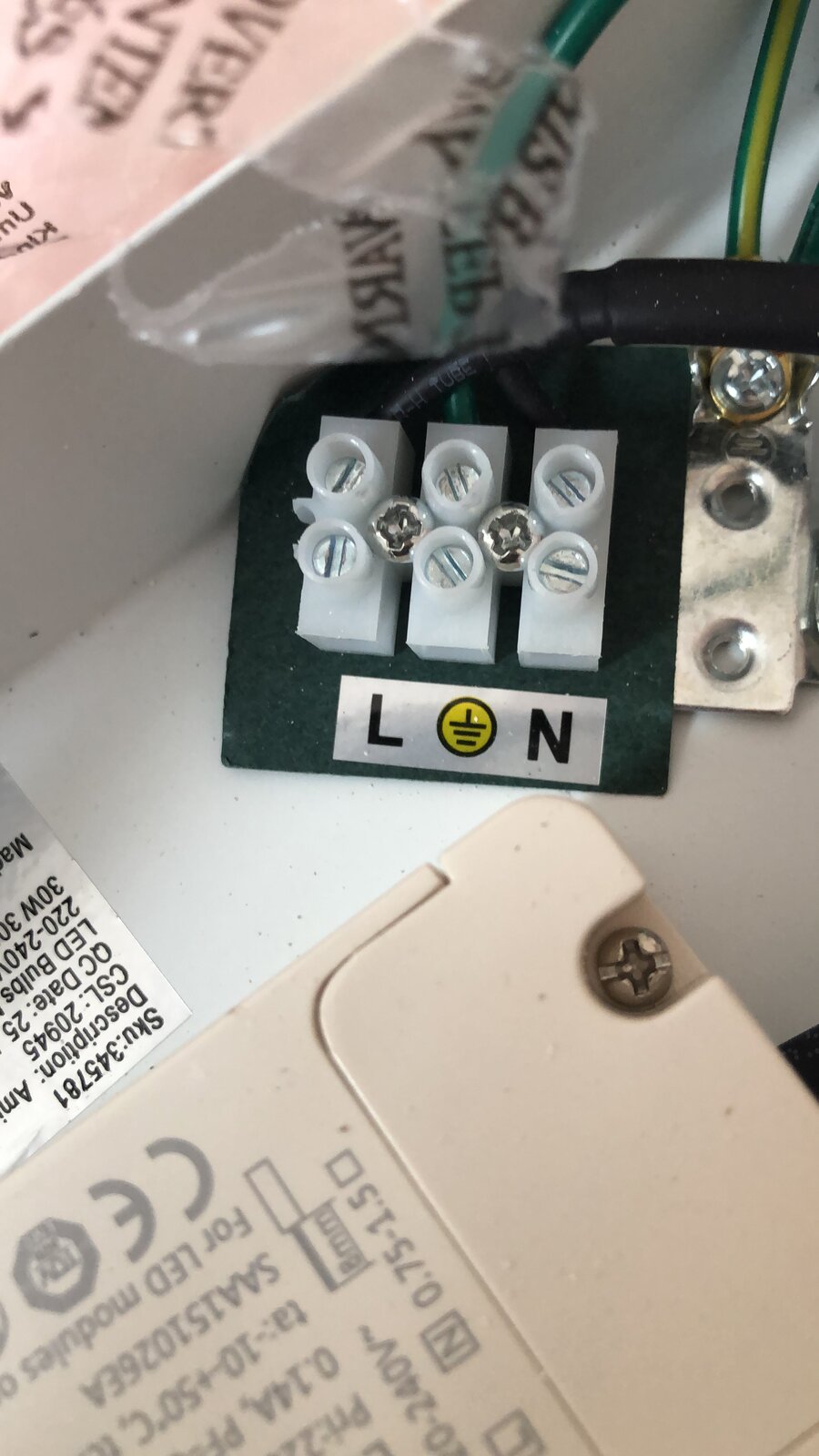

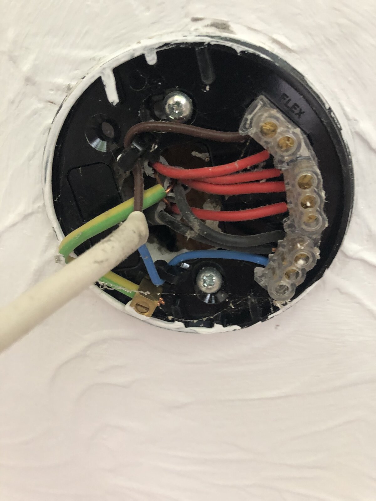

Hi I am trying to replace a bedroom light. I have posted the images of the current wiring and the new light (also the earth wire on the new light fitting). I can identify the live, neutral and earth but not quite sure how the wiring should transfer into the new light. Any advice gratefully appreciated.

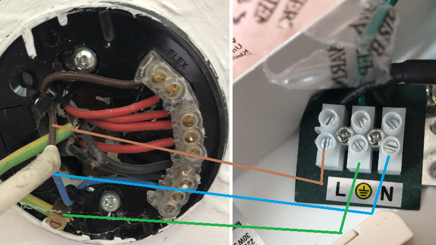

Assuming the old lamp and the ceiling rose are being removed then the brown and blue wire that go to that lamp are no longer needed and should be removed with the ceiling rose.
If you are keeping the ceiling rose in place then

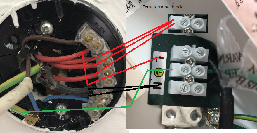

Thanks also for your help! On the brown and blue wires which are not needed can I just put them into a extra terminal block and leave them redundant. Otherwise I am not sure how I would remove them?

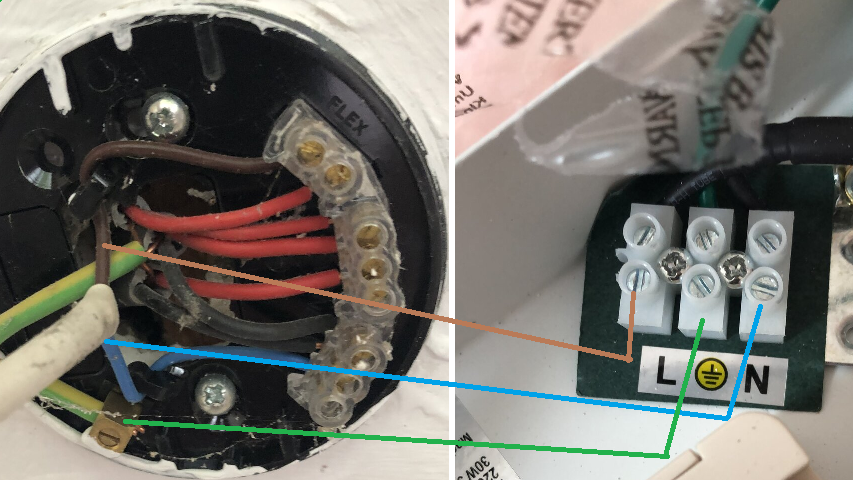

Are you removing the ceiling rose ,and pendant ,and fitting in its place the new light fitting ? If so there will be no blue and brown wires going to your new fitting.
Hi thanks, your right no blue or brown wires as I am removing the ceiling rose. Just wanted to know on how to remove/isolate the brown and blue wires coming from the houses wiring
Do you know now ,or do you still need advice ? Before touching any of the wires at the ceiling rose you should turn off the mains electricity supply at your fuseboard or consumer unit.

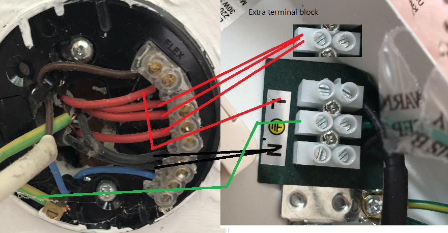

The installation wiring is black and red. There are no blue or brown wires.
You may want to consider paying an electrician to install this light fitting, as it appears you are unable to understand the basic concept of what needs doing.
Thanks I’m good I have installed the light! Thanks for your guidance mate
