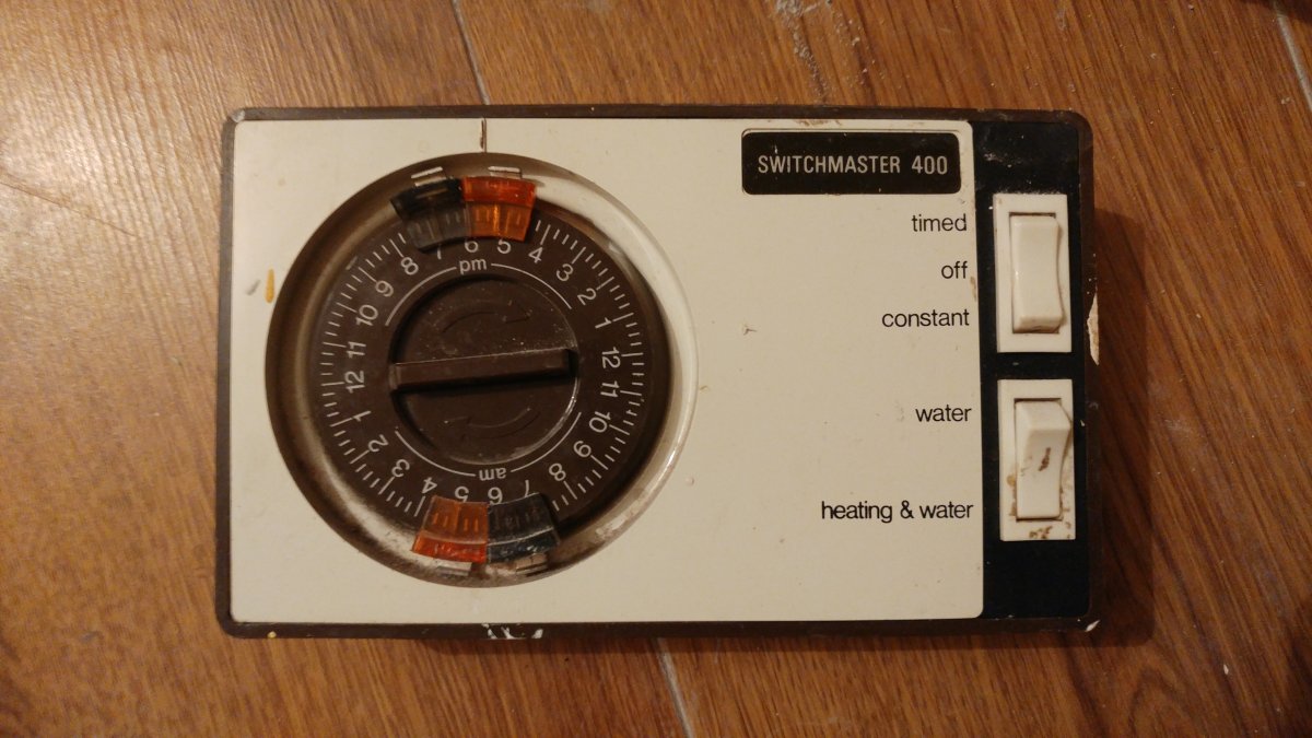

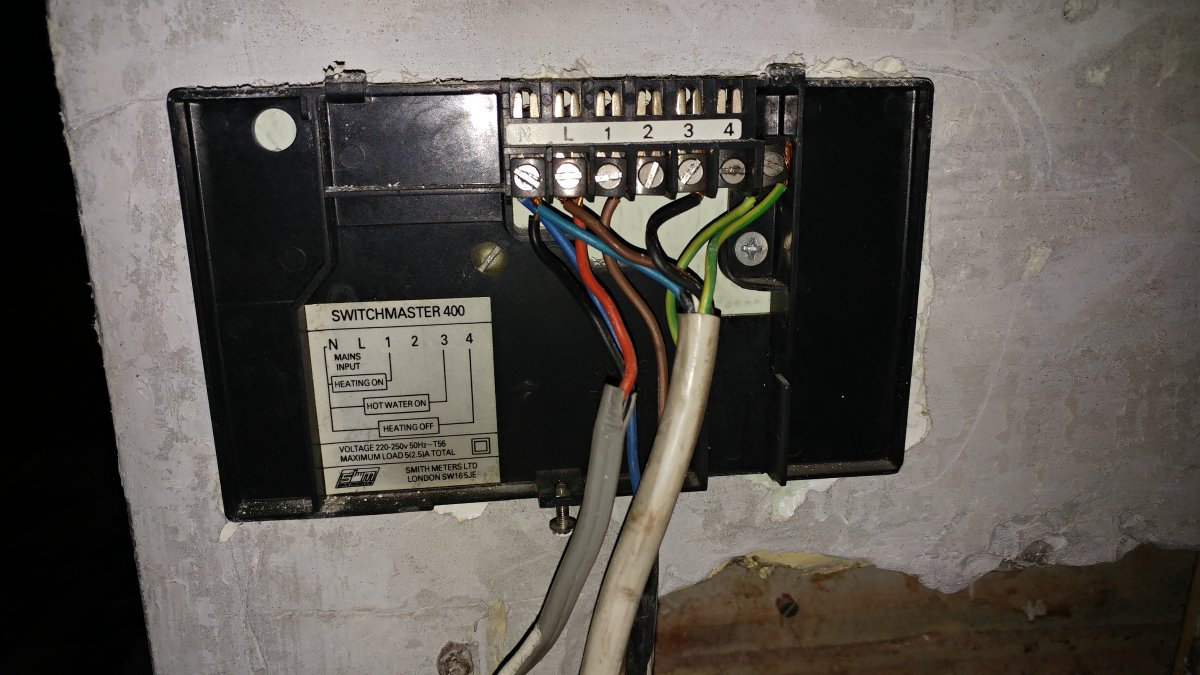

Hi,
I'm renovating a few rooms, one of which contains a very old central heating controller:
I'd like to replace this. The wiring looks fairly normal, with one output for "heating on" and another "hot water on".
Can I put a new controller on in place of this one? My concern is that this one only allows "water" or "water and heating" -- not independent control of water and heating as most do, even though the wiring looks like it treats them separately. Can all systems support independent control of water and heating, or do I need to check? If I need to check, what do I need to check please?
Normally I'd just try it and find out -- but I can't because there's no power, and I need to make the decision before getting the plastering done, only after which the power can be reconnected.
Thanks!
-Mark

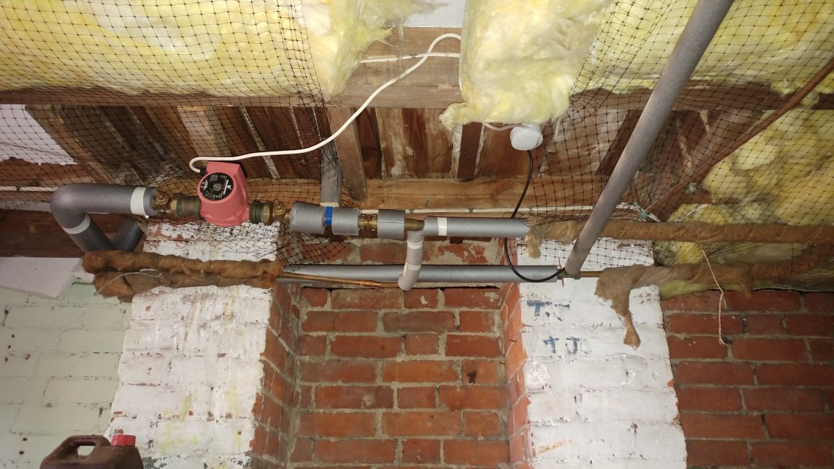

Thanks. There are neither of those near the cylinder (in a bedroom, immediately above the boiler), nor visible in the living room where the back-boiler is, nor in the cellar below the boiler where the central heating pump is.
If it helps at all, the cable going to the boiler has four cores: live, neutral, water and heating. A second cable (neutral and heating) goes to the central heating pump.

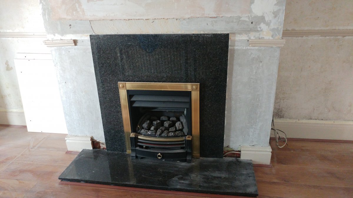

Any idea where the valve might be located on a back-boiler system? (Sorry, probably should have mentioned that it was a back-boiler system.) The only place I can imagine it could be, if there is one, is behind the fire with the boiler. Does that seem likely?

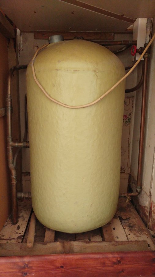

you more than likely have a gravity hot water system so no matter what you do with the controls, you will not get CH without the HW being on unless you completely alter the pipework, a simple pic of your HW cylinder will confirm

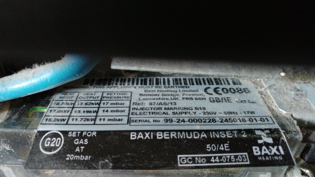

More pictures as requested:
I think I may have answered my own original question, though: I had a closer look at the wiring, and only one "signal" goes to the boiler: hot water. The other control, central heating, goes only to the pump. So my guess is that there's no valve at all, and it selects between water and water+heating simply by running the pump or not. Does that sound like a reasonable understanding?

That setup is what I originally had. I converted it to a fully pumped system. It involved a bit of pipework but then my tank was almost next to the boiler. Yours are far apart so I'd imagine a fair bit of new plumbing would be needed.
Only one "signal" goes to the boiler: hot water. The other control, central heating, goes only to the pump. So my guess is that there's no valve at all, and it selects between water and water+heating simply by running the pump or not. Does that sound like a reasonable understanding?
Yes, that's how the old systems used to work. When you select 'hot water' it turns on the boiler, and the hot water cylinder is heated by natural circulation. When you select 'central heating' the pump will operate and circulate water around the radiators, however, the 'hot water' must also remain 'on' to keep the boiler running.
Can I get a more modern controller which supports this same mode of operation?
Yes, but you must choose a programmer which is specified as suitable for 'gravity hot water systems'. Many still are suitable, they have the facility to be selected for this mode of operation so that when central heating is selected, the hot water is automatically turned on also.
Is this (the heating being invoked only by running the pump, no valve) a good, normal, sensible way of doing things?
No it's an old way of doing things, wastes energy and doesn't provide thermostatic control of the hot water. Systems like this haven't been installed for 30 / 40 years. Modern gas boilers cannot support this method of operation anymore, so when you replace your boiler, the piping arrangement will have to be changed.
