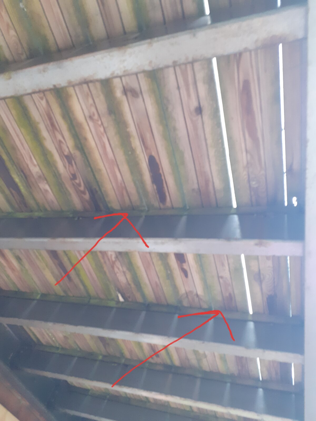

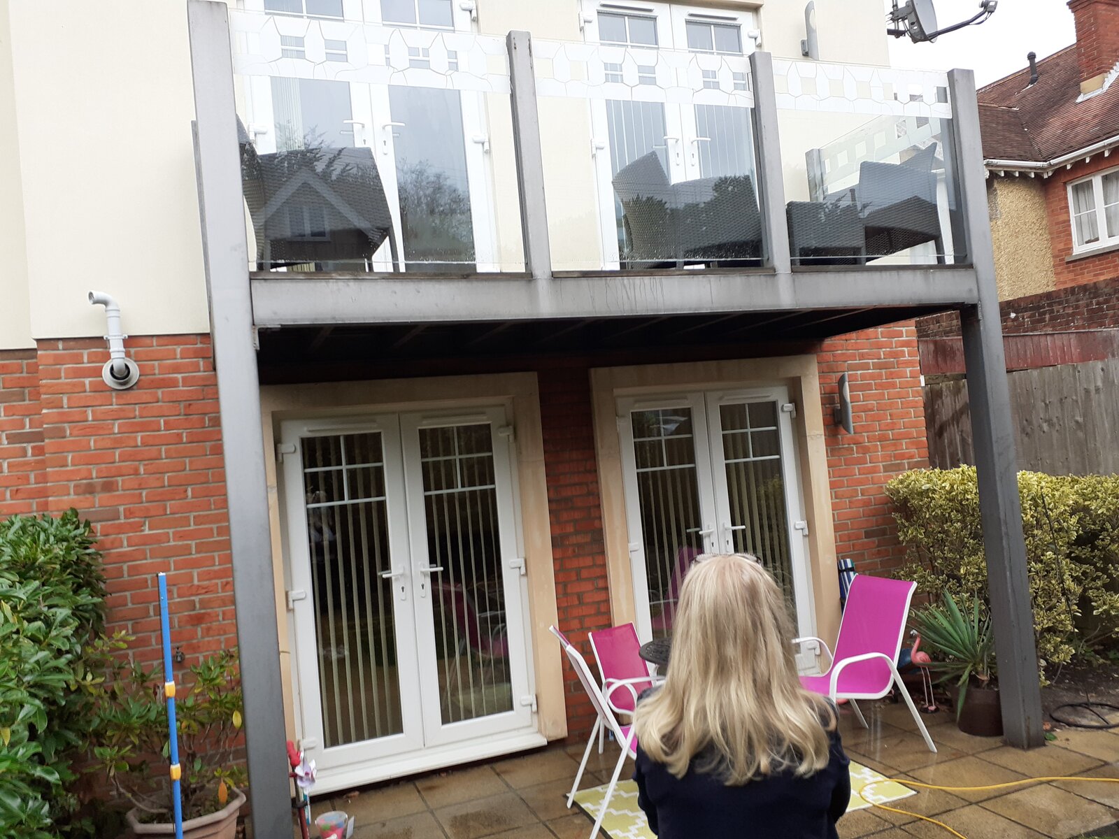

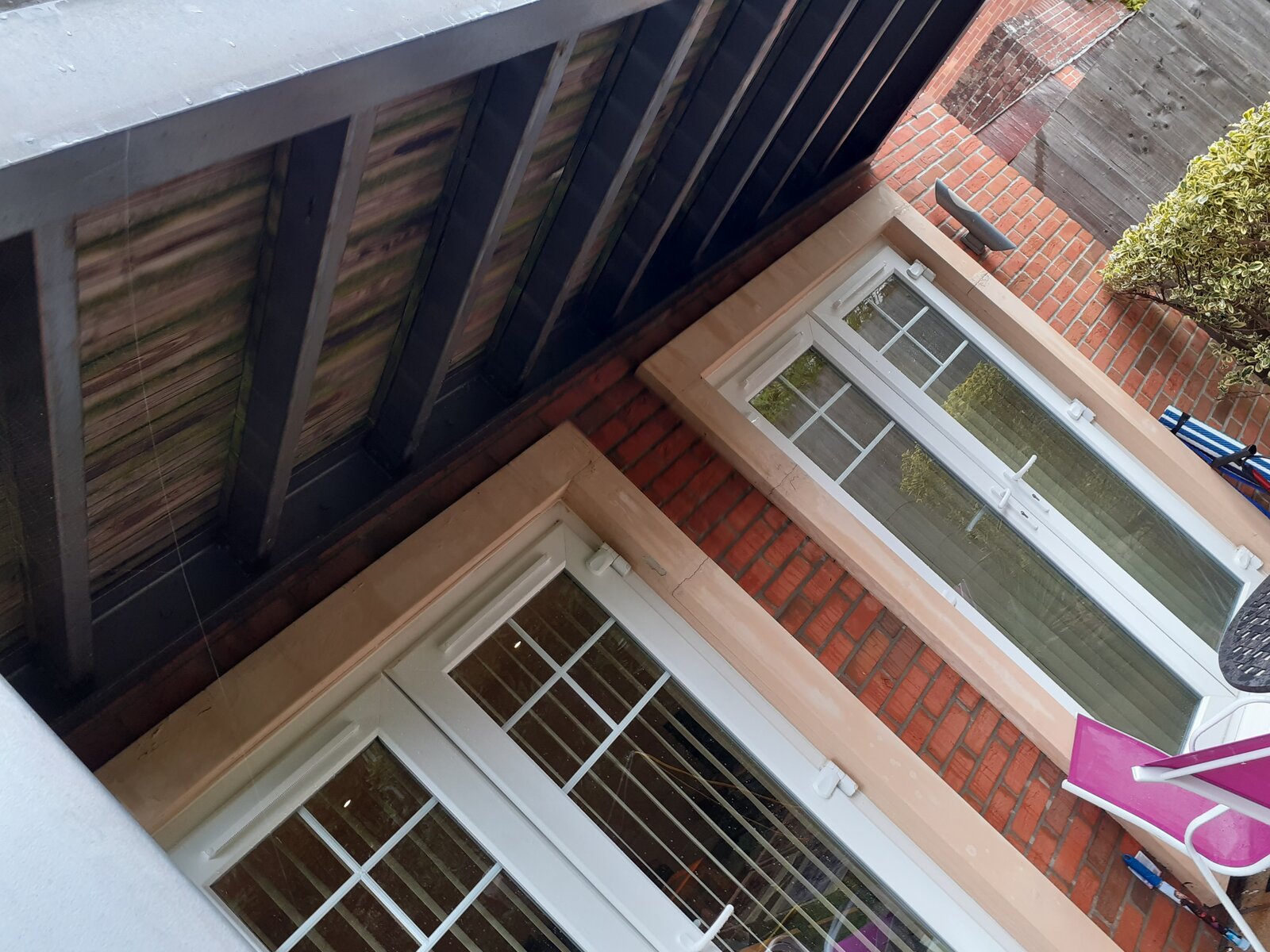

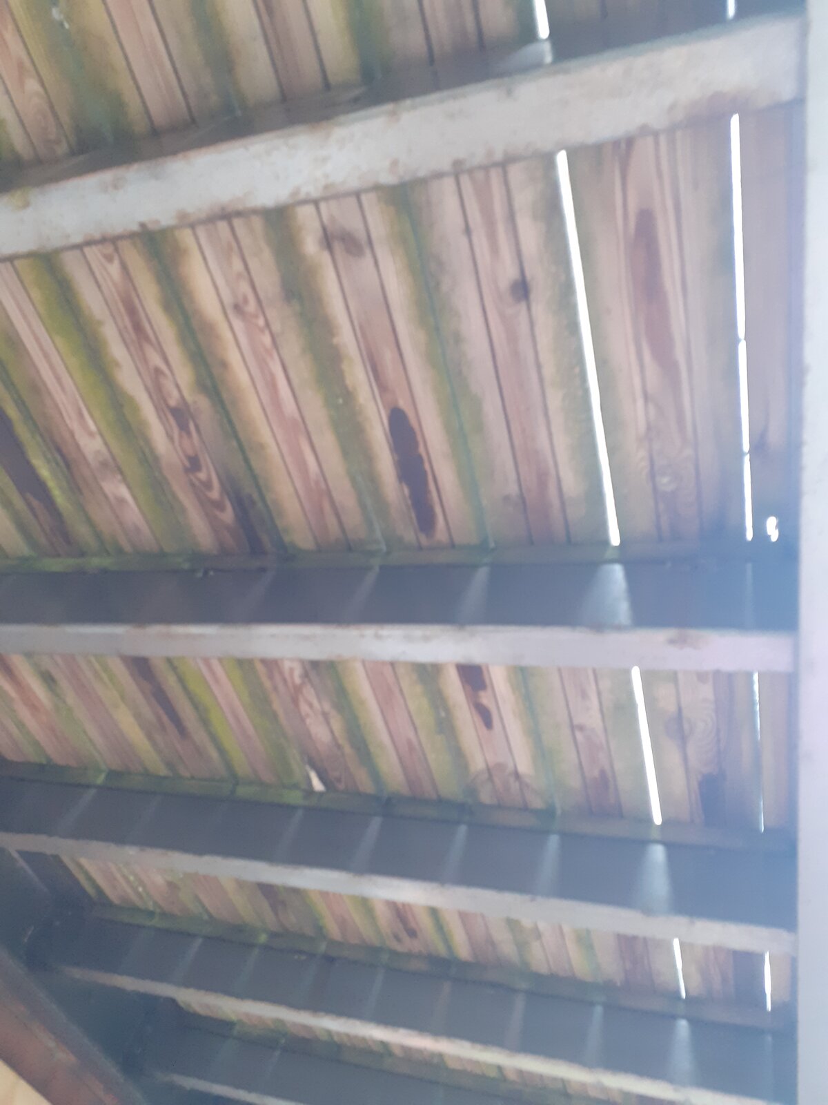

Got some rotten decking on a balcony that needs replacing. Is it best to smash it out and work off a small tower; sticking head through the metal joists to work? It's about 3 metres up.
There's baton attached to the top of the metal joists and decking running on top of it. I was going to exchange like for like.
Any fire regs to worry about about is it worth putting something between joists incase someone falls through decking between them? Or is that over worrying?

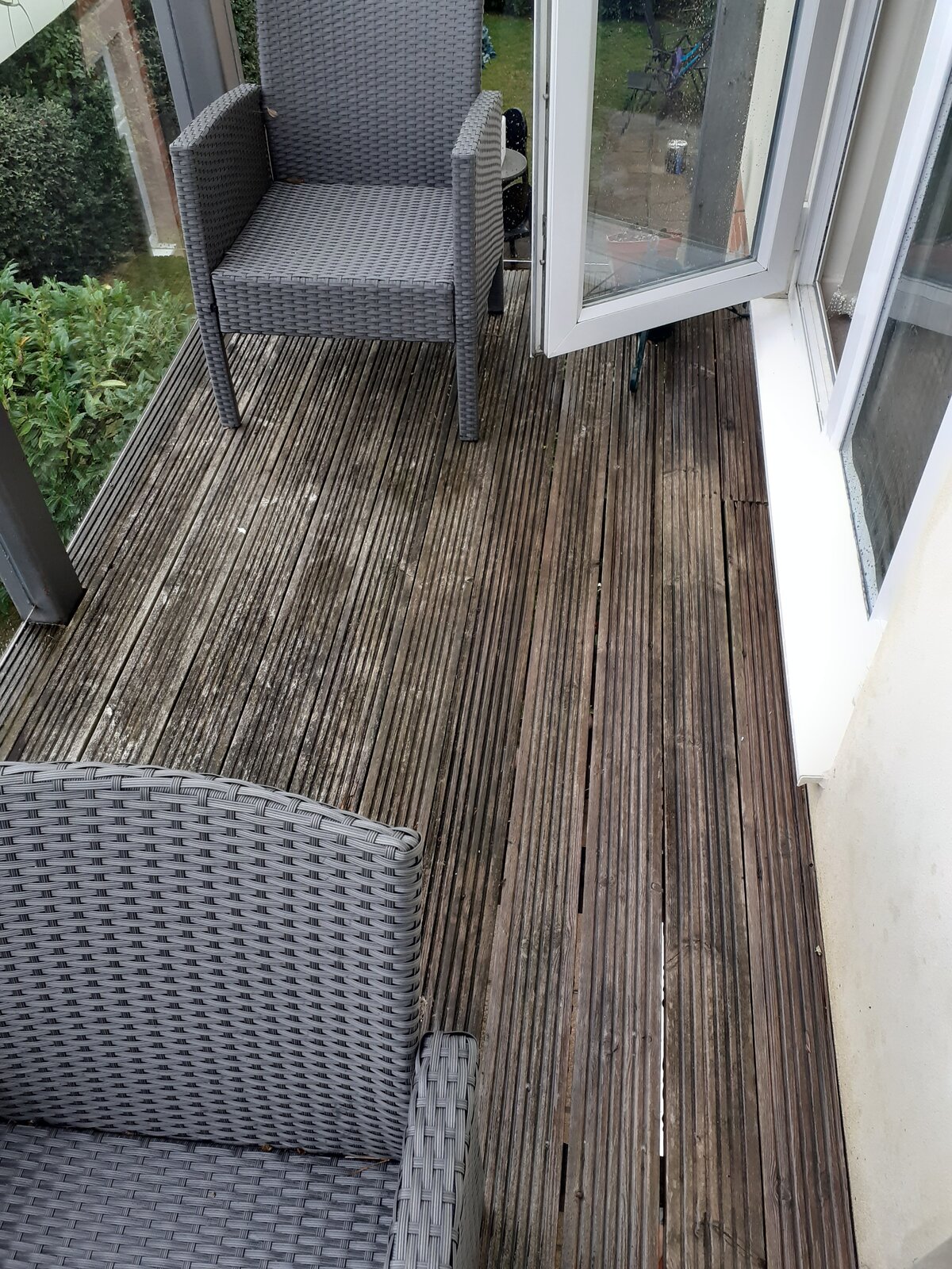

Doesn't look rotten just needs a good clean and clear wax treatment people think decking is maintance free when not
But if you want too replace do it with solid composite deck replace batterns with composite too then just clean once a month an tower fine if ya don't like heights

It's definitely rotten in one place. I could push my finger almost right through. I suppose could replace just that piece.
I guess composite would be ok with fire regs too.
Out of interest couldn't anyone actually fall through metal joists if the decking was totally rotten?
Yes they could- if the wood was totally rotten. However it would generally rot at different rates and feel unsafe before dropping someone right through.
Decking is pretty cheap so I would be tempted to replace it all if doing more than a tiny bit.
It will all look the same.
You could safely lift two and refit one, lift another and repeat.
Possibly give the new boards a bloody good treatment while still on the ground to help them last
One problem with lifting just two boards at a time. There's a piece of baton running along the top of all the metal joists so I would want to replace that as well . And to do so, I'd need to remove all the boards first
