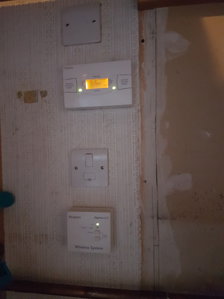

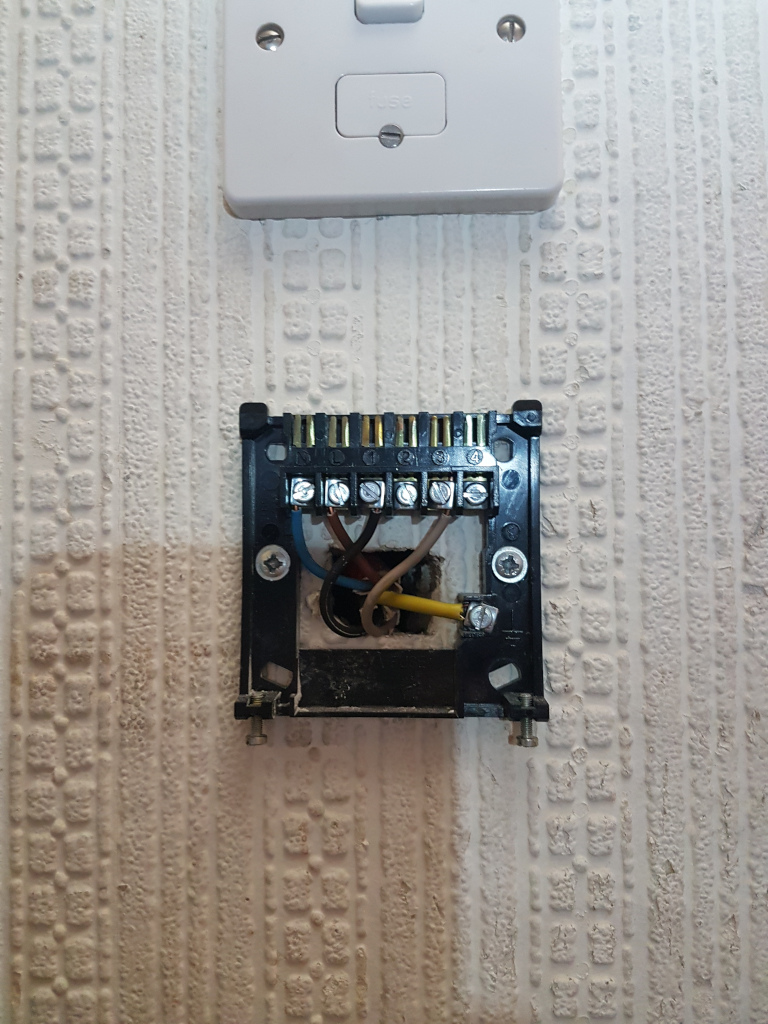

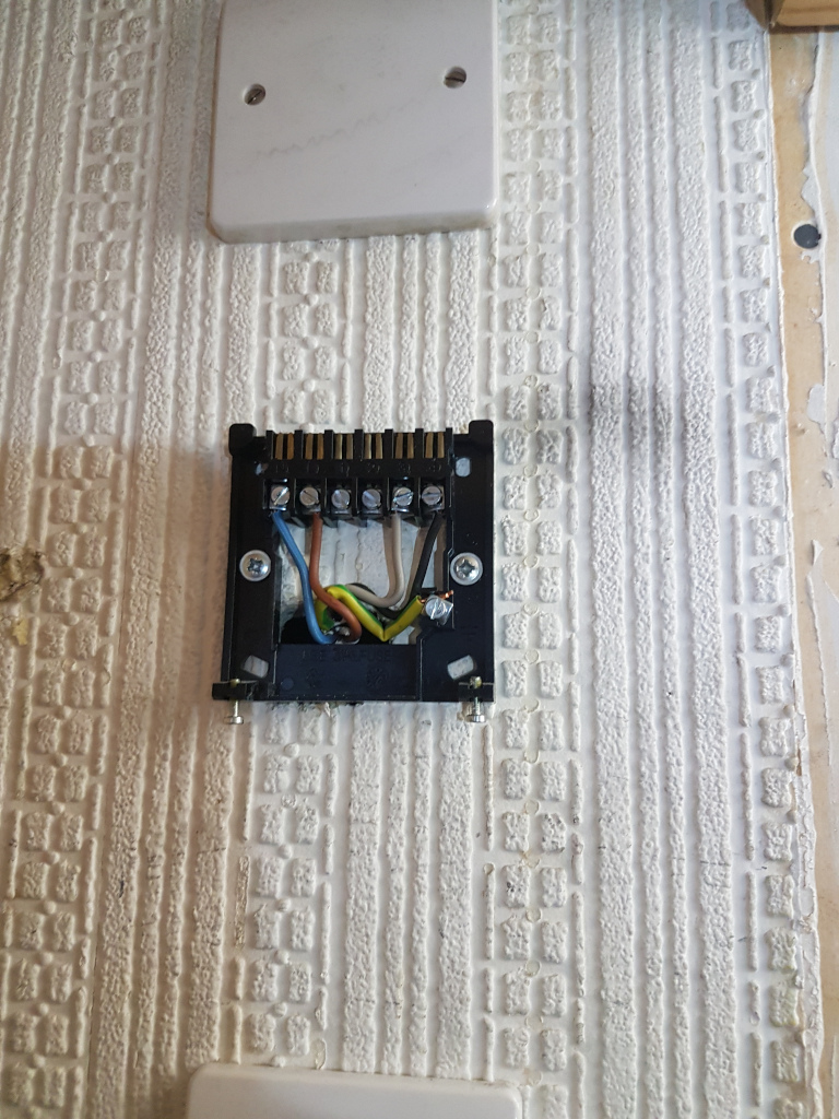

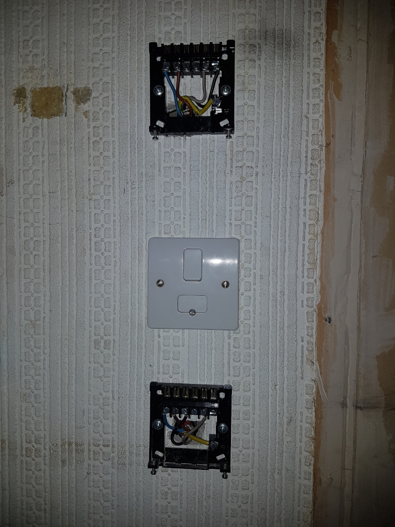

Hi people. Just wonder if anyone can help a bit with the task I'm about to do
main picture - my current set up
main wiring - wiring of current set up
lp522 - top wiring panel
scr - bottom wring panel
I want to replace that with HIVE
I know what to do with wires from lp522, they basically go in same order to hive.
What I don't know is what to do with Digistat SCR wiring. Can anyone help? Please

My wiring centre must be burred in the wall somewhere as cant find anything. By saying to install the link between them you mean connect them together ? Can I just connect them together where they are ?
Yes you can, just terminate them all into a block linking common and calling.
