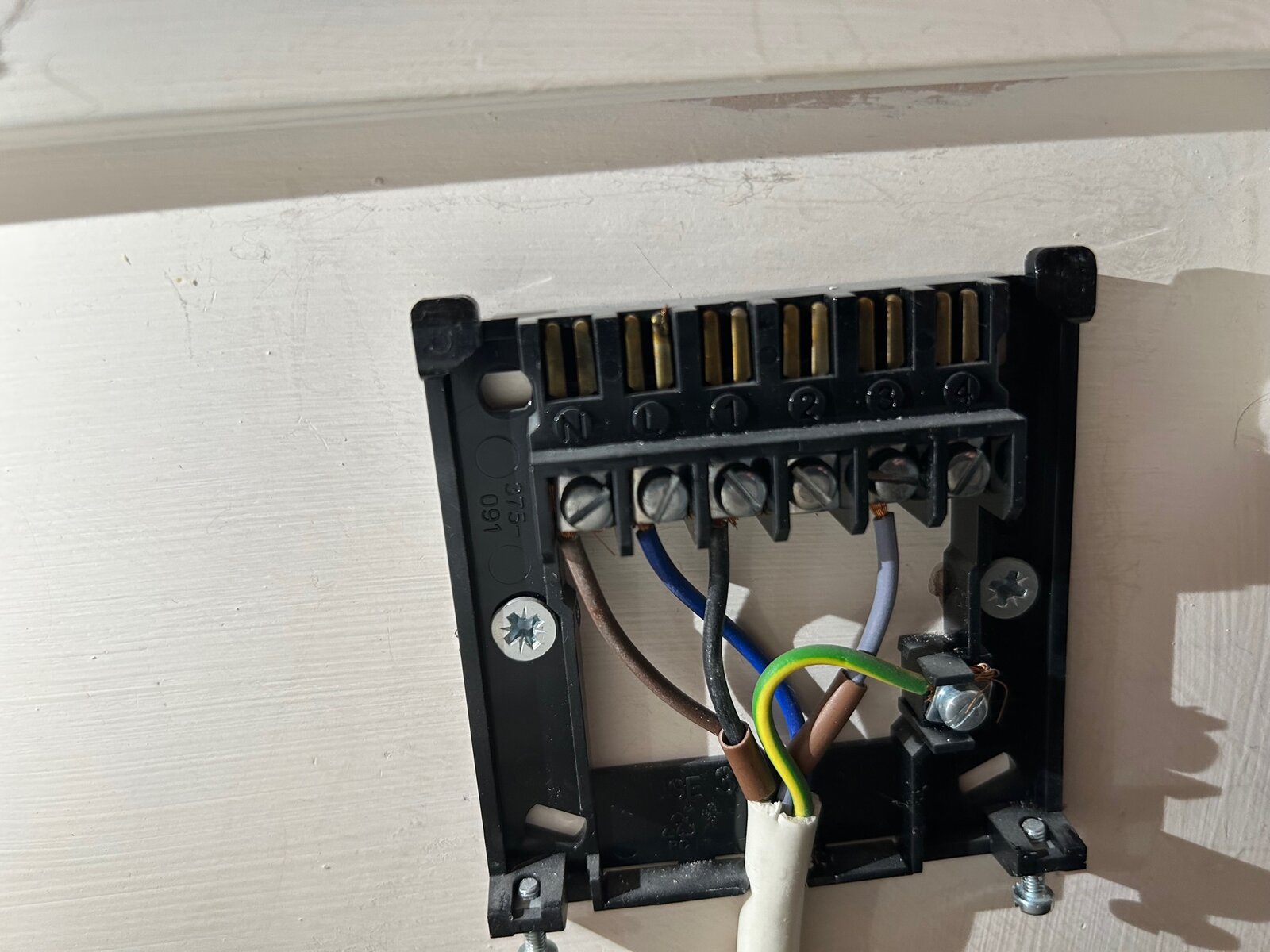

Moved into a new house which has a Worcester GreenStar Danesmoor 25/32 oil boiler which is controlled by a Drayton LP522 timer panel with separate controls for hot water and heating. A Drayton Digistat SCR is paired with an RF601 room thermostat.
My plan is to leave the LP522 to control the hot water as that's a pretty static task, but remove the Digistat SCR and RF601, replacing them with my Tado receiver for heating control.

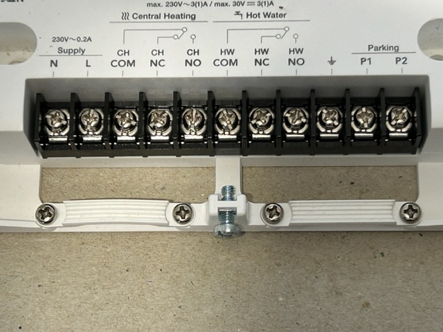

I have pulled the cover on the Digitstat SCR to see the wiring (photo attached). Can someone help me understand how to connect that same wiring to the Tado receiver (photo also attached) please?

Likely on the back of the room thermostat it will have a wiring diagram, where you can confirm that brown is live, blue is neutral, and black and grey and com and N/O but you need to confirm this by looking on the diagram on the back of the thermostat.
Also confirm before you start all is working as it should, often oil boilers work on C Plan and DHW can't be turned off, but before you start make sure all is working, as if not after you don't know if something you have done or not.
Thanks for the quick reply. I have checked the back of the existing receiver and it confirms:
N - Neutral
L - Live
1 - Common
2 - SAT (?)
3 - Call
In this case am I right in saying I could set the heating to be permanantly 'On' on the LP522 timer, then:
- connect the black from '1' on the existing controller to 'CH COM' on the new Tado receiver
- connect the grey from '3' on the existing controller to 'CH NO' on the new Tado receiver?
The desired behaviour is that the Tado receiver governs the call for heat.

...and for whoever wired up that stat, it's a good thing that it's volt-free switching, otherwise the results may have been interesting! :eek:

Yes.
And yes :)
Don't forget the earth connection as well.

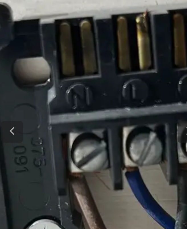

Oh wow I just noticed that! Presumably they've made the same mistake at the other end of that cable (i.e. brown where blue should be and vice versa)? Or is it possible that they've crossed them over at one end only but it's still working?!
It's probably just this end. But its worth checking the other end of the cable. It would work regardless.
Some thermostats internally link the common to the live, rather than having a separate terminal. In that case, the installer would have quickly noticed their mistake!
