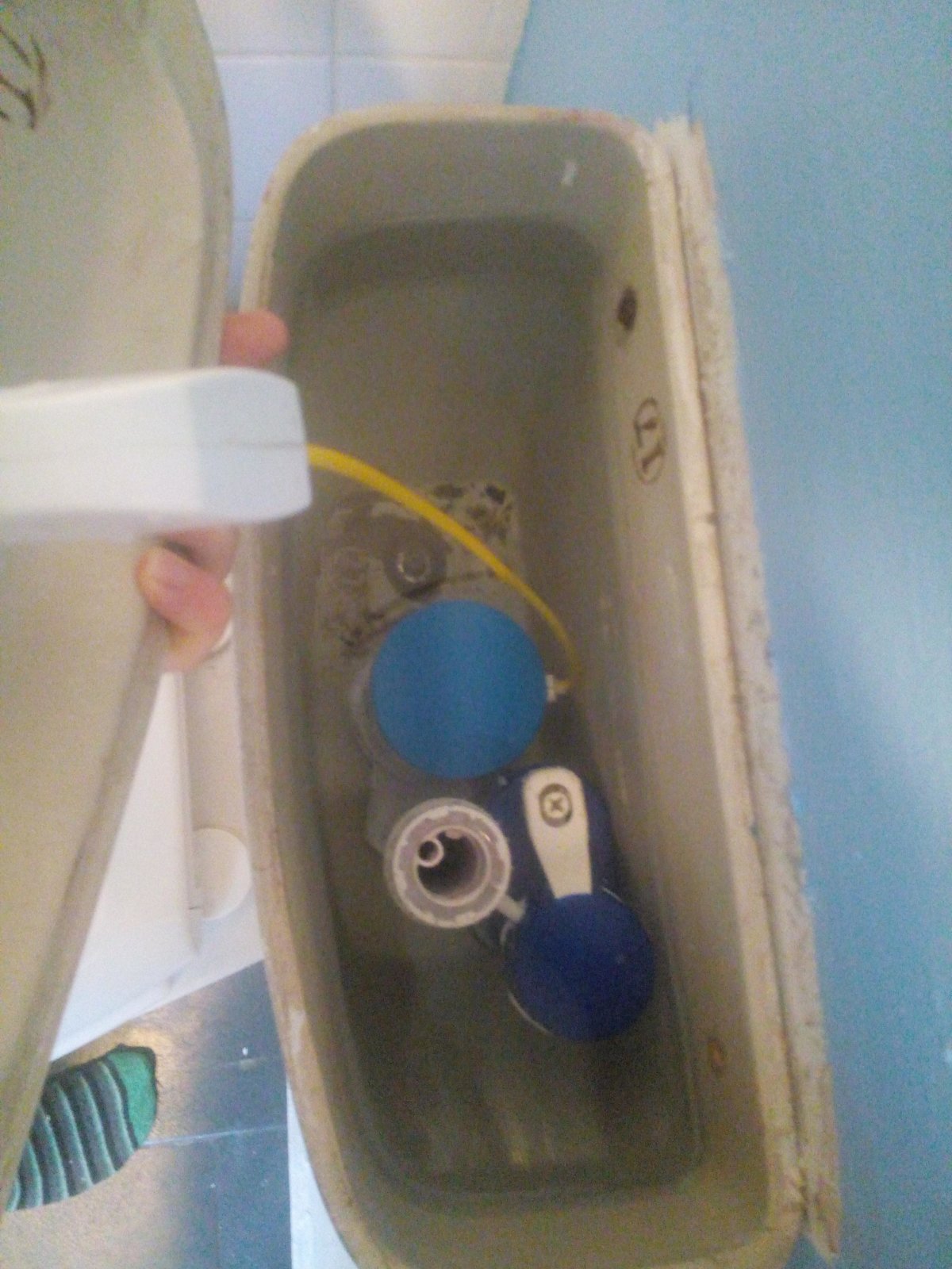

Hi everyone,
I have water slowly dripping into the bowl from the cistern. I've tried adjusting the level of the fill valve with the screwdriver and then when the water pours back into the cistern (after switching the water back on) the level looks correct once it stops filling, but after 30 mins or so, the water level gets higher and higher and then ends up going over the top of the fill valve and down the overflow tube and into the cistern.
I am guessing that the fill valve needs replacing (or perhaps even the washer at the bottom of the cistern where the fill valve enters?). It's a bottom entry fill valve. Please can someone point me towards the right product(s) to buy in B&Q at https://www.diy.com/search?Ntt=fill+valve ?
Thank you for your help! :)

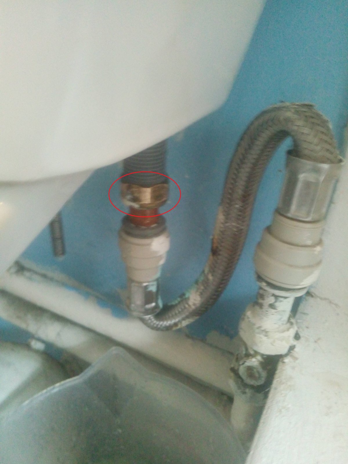

Thanks for your reply.
I bought this part, but at first I couldn't install it without water leaking from the washer used by the hole that this is inserted in. I have instead used the washer from the old one (which is slightly different in shape) and it seems to be holding.
However, a new problem has now occurred. When I switch the water back on, water starts coming out of the area where the water supply connects to the threaded part of the fill valve (the nut). I have attached a photo and circled the part I mean. Does anyone know how I rectify this? Thank you!

I would use a product like Fernox LSX. It is a silicone sealer and will stop any water passing through the joint.
There is a seal which needs replacing , sits in the fitting , loosen the nut off and you will see it. Be careful not to cross thread the nut onto the tail of the fill valve when re assembling.

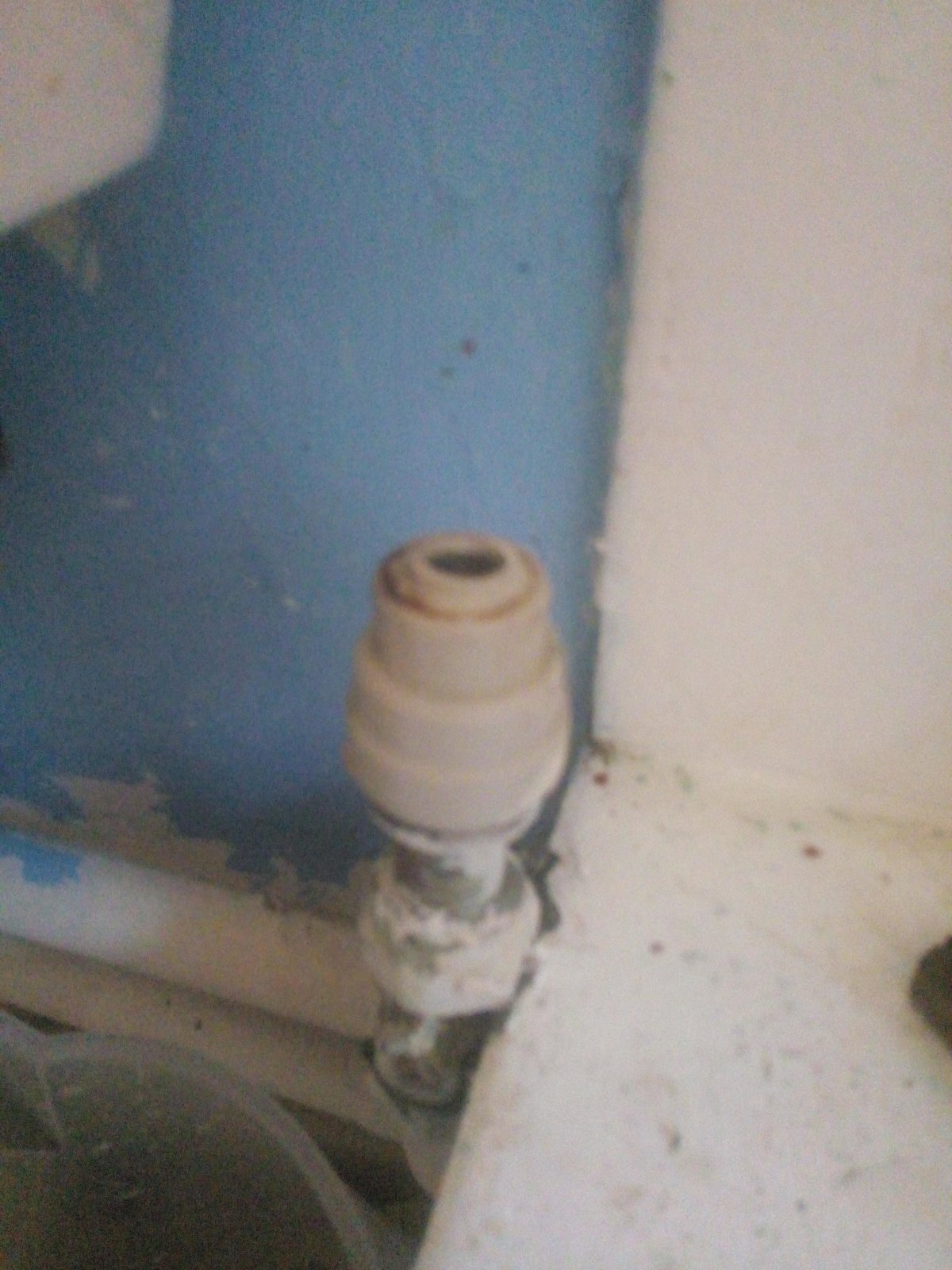

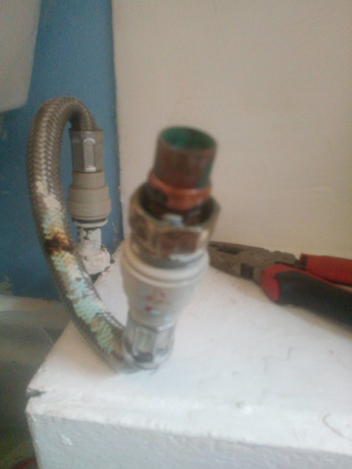

I've attached photos of what I can see once the water supply pipe nut is loosened. When you say about there being a seal, where do you mean?

The fitting you have is quite simply the wrong thing completely. It has an olive ,which is a compression fitting part. Its good fortune that it worked on the old valve. Ignore my previous post ,it looked like a tap connector on your pic ,i can see clearly now that it is not. If your plumbing skills are upto it ,you should re plumb from the isolation valve. If not, replace the flexi hose for a flexible tap connector hose 1/2 inch bsp to 15 mm length around 500 mm.

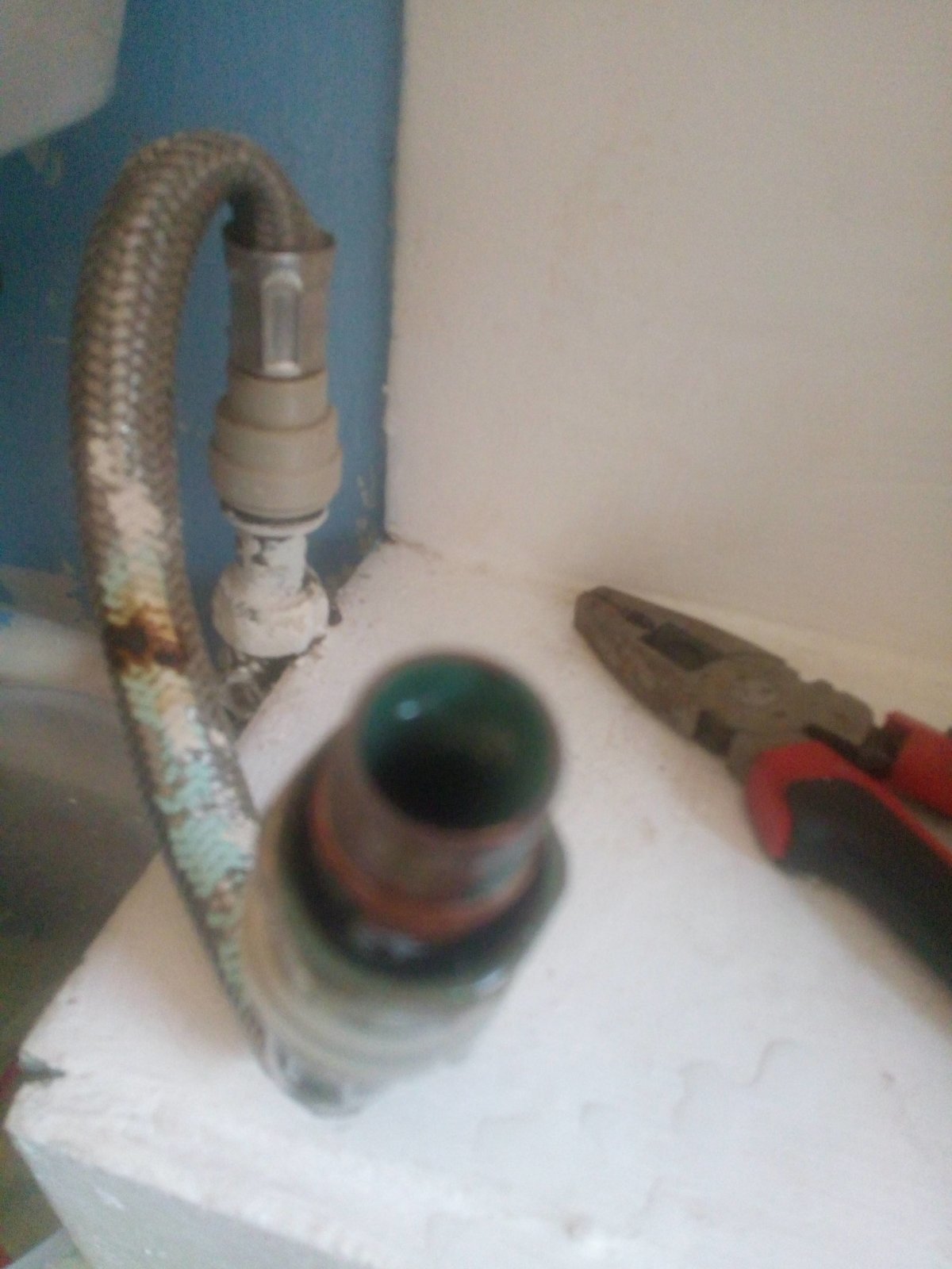

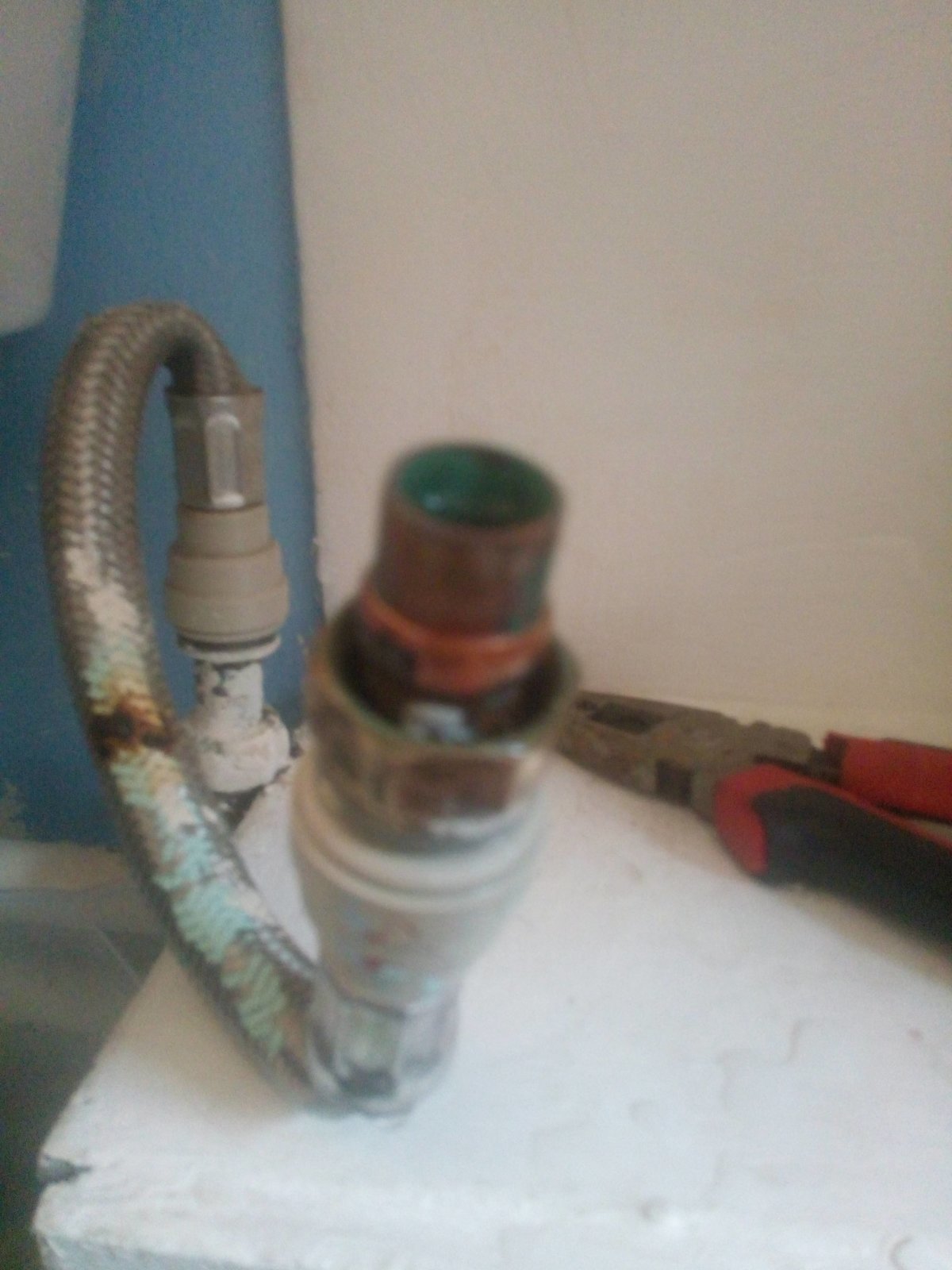

I've had a go at removing the old one, but when doing so, the flexi pipe came off, leaving just the push on part of it still on the pipe. This remaining bit doesn't seem to want to budge! Do you have any tips about how to remove it?
Blimey !! Anyway ,see the collar on the end of the plastic , at the copper pipe end. That has to be pulled up into the fitting to release an internal grab ring. The grab ring is what is keeping the fitting onto the pipe. Its a bit fidly !!
Press down on fitting ,pull up on collar
When you say about the collar/copper pipe end, do you mean the top of the plastic or the bottom of it? And when you say "pulled into the fitting" please can you elaborate on what you mean as I'm a bit confused!
The collar is the bottom bit of the plastic fitting ,where the pipe goes in. Its part of the fitting ,and it has to be brought inward into the fitting. So ,press the body of the fitting downward ,whilst using your other hands fingers to pull upward on the collar ,bear in mind the collar only moves a small amount.

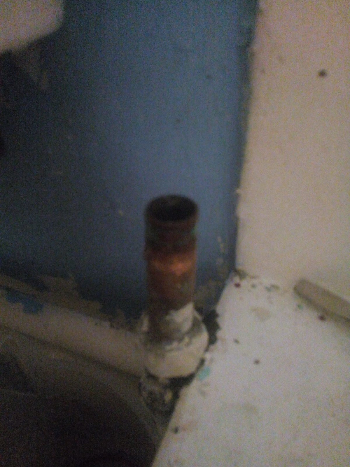

Hurrah! My hands are somewhat sore, but I got it off!

Ha ha ,is the copper pipe in good condition ? You don't have to buy wire wool ,brillo pad ,scouring pad those little sponge things that the wife uses to clean pans with will do .
