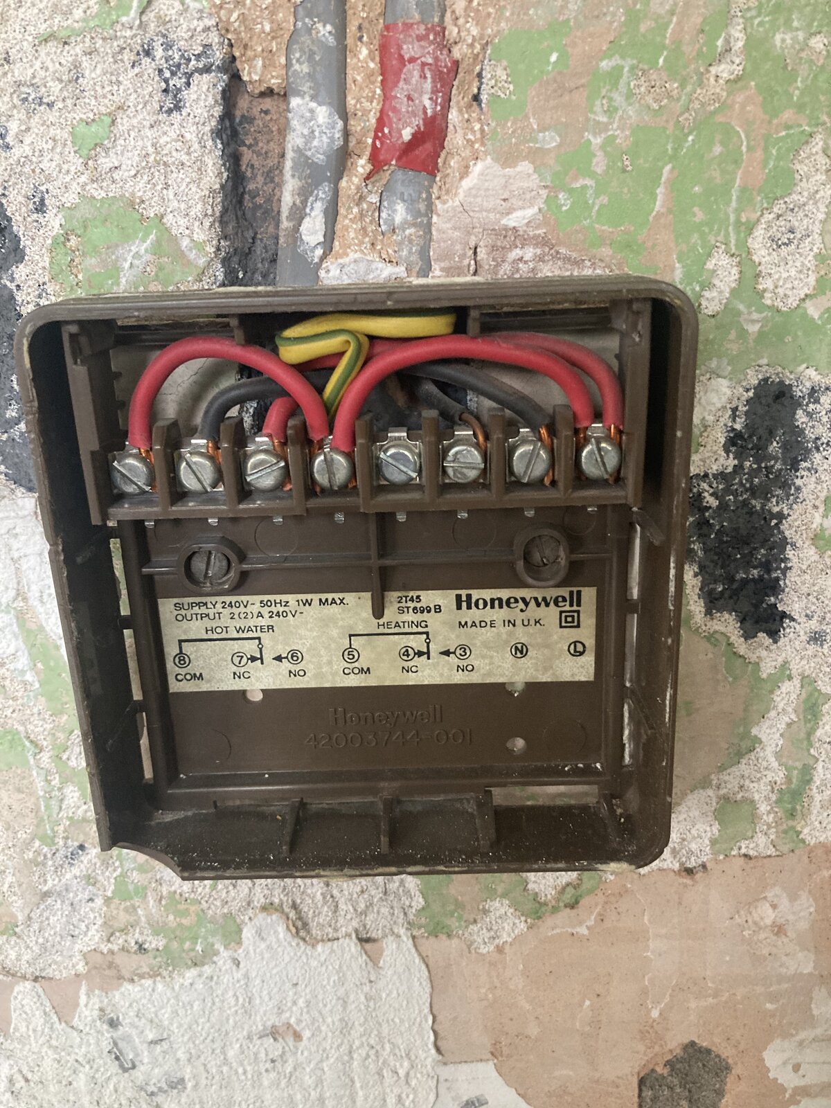

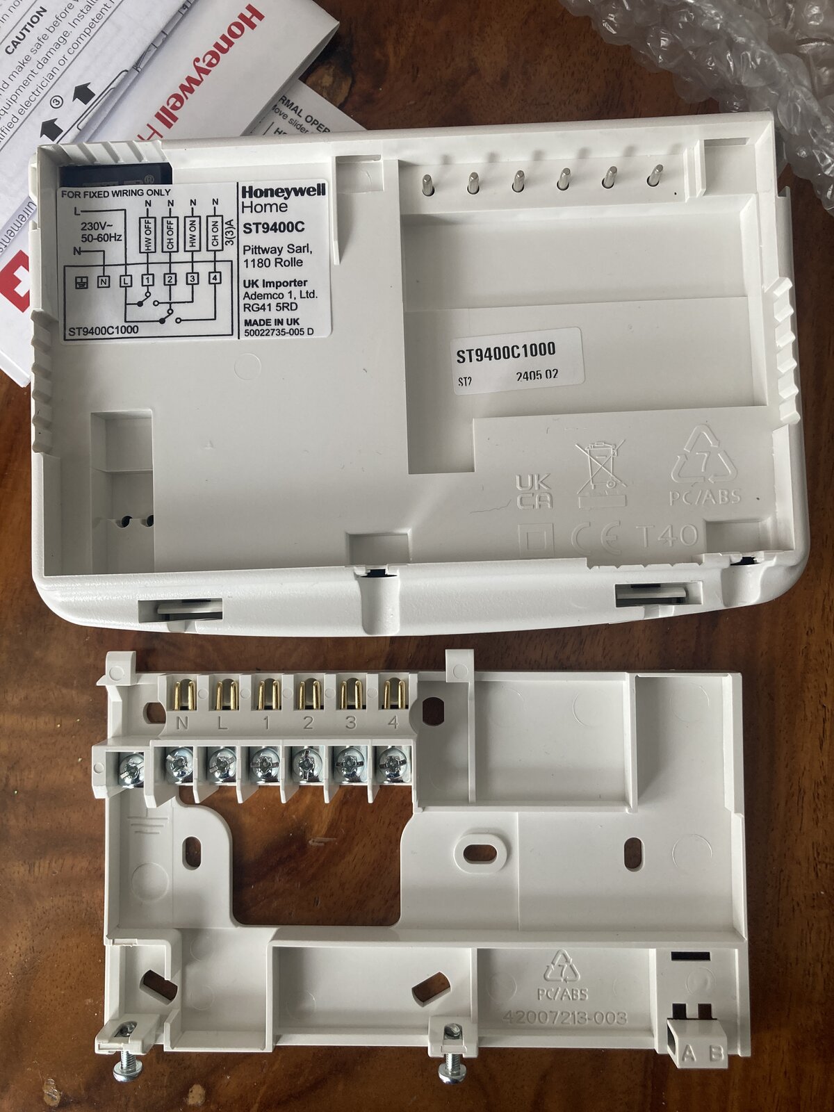

Help with wiring from Honeywell st699 to Honeywell st9400c
Hi all, can I get some help with the wiring from a st699 controller, trying to upgrade to Honeywell st9400c.
Any advice would be appreciated
ST699 L to ST9400C L
N to N
3 (Heating NO) to 4 (CH ON)
6 (Hot Water NO) to 3 (HW ON)
7 (Hot Water NC) to 1 (HW OFF)
Plus, Green/yellow wire to earth terminal.
The two red link wires currently connecting L to 5 and 8 on the ST699 are no longer required.
