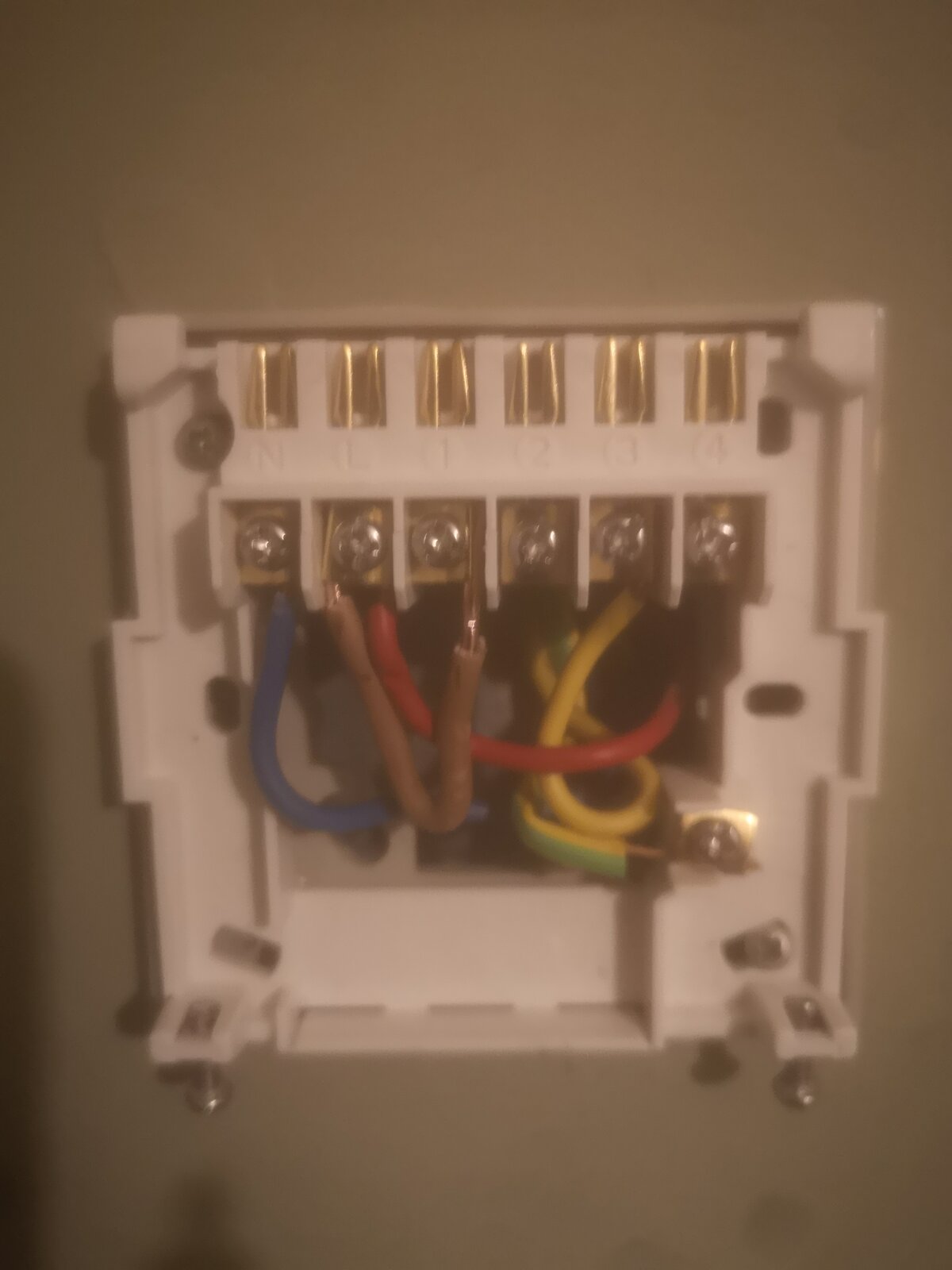

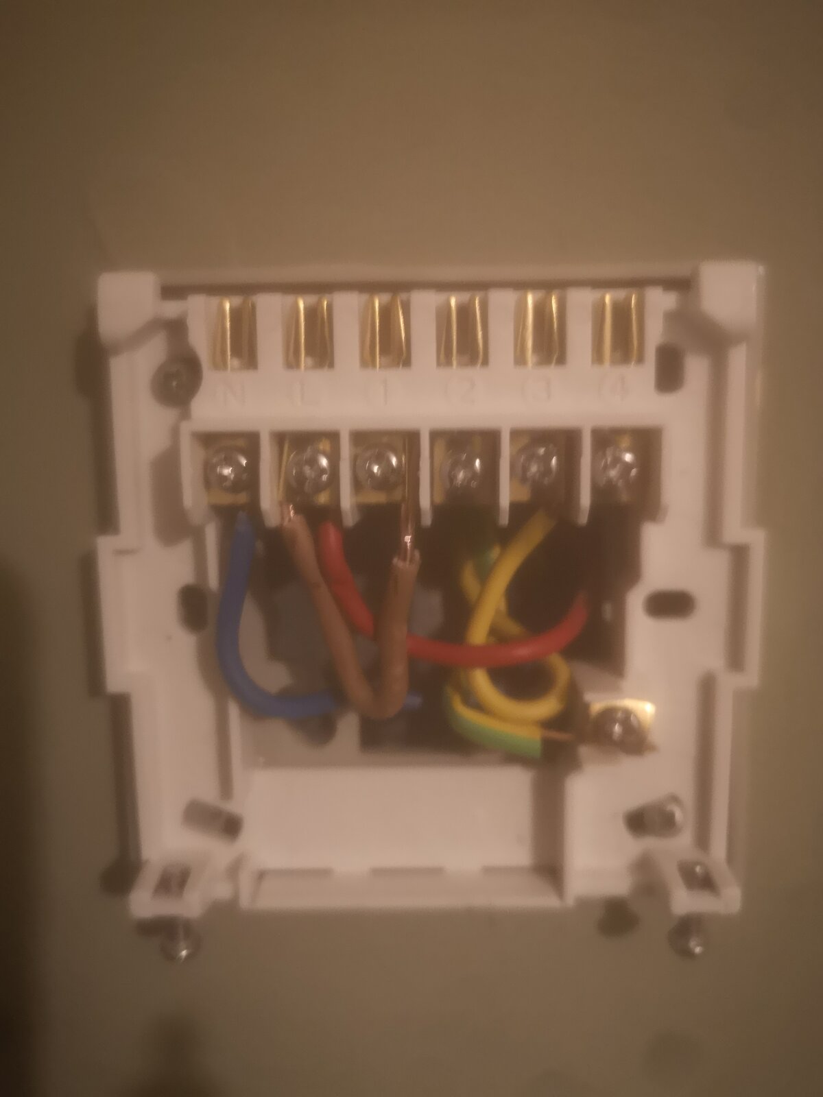

How I've currently wired the HIVE up with what I've found online.
Blue to N
Red to L
Yellow to 3
Earth connected
And I've put a link between L and 1
The issue I have is that the heating is permanently on once paired.
If you need anymore information feel free to ask, I've tried to give you all I know.
post a pic of what you are doing , NEVER go by colours of wires in a heating system they dont mean anything, first you say you have a live and a switched live, then you now have live and neutral, where did you get the neutral from
I put the unused blue wire to N. I've tried disconnected that, and once I done that the whole system was dead.
I've just traced the blue wire back and it does indeed go to Neutral

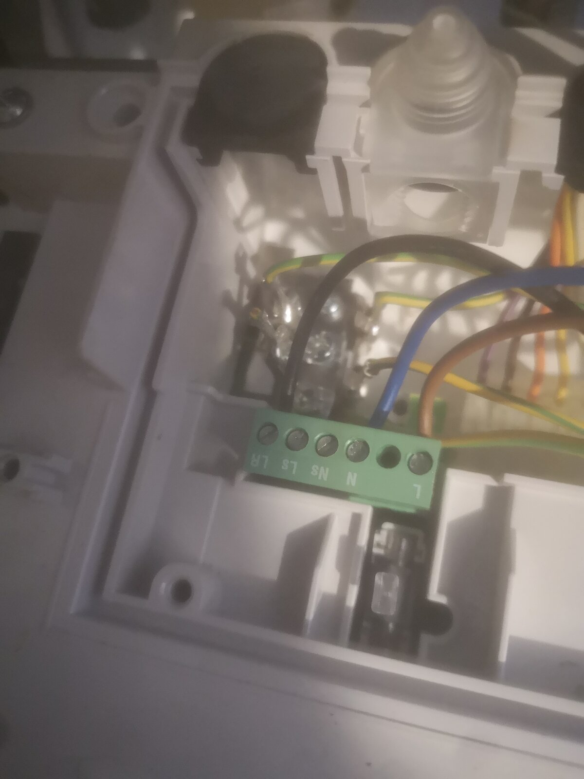

The Yellow wire that I have in 3 in the receiver goes to LR in the boiler.
Boiler locations are
L
N
Ls (empty)
Ns (empty)
LR
yes 3 goes to LR
Lto L
N to N and link 1 &L
no need for the earth just tether it

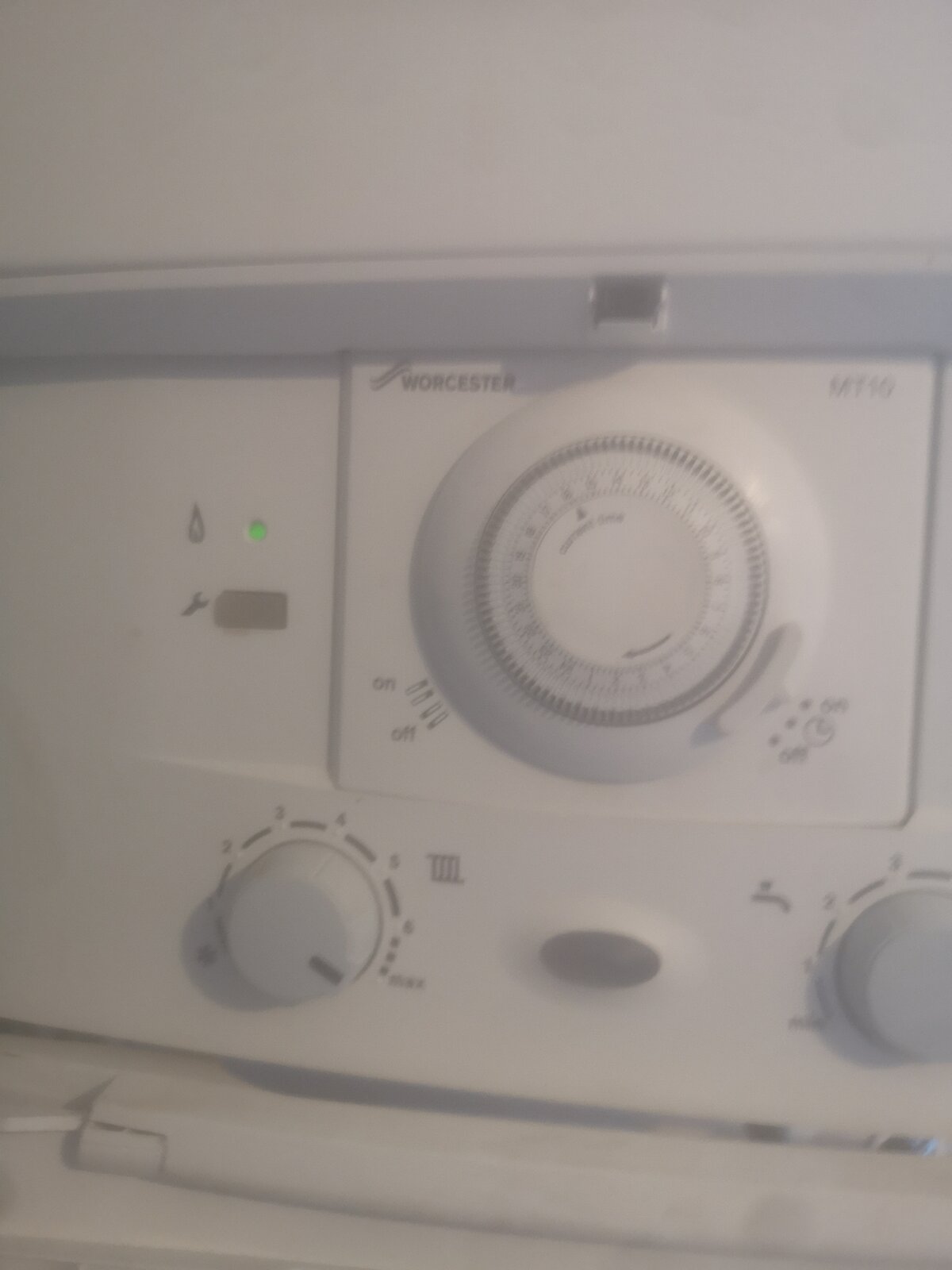

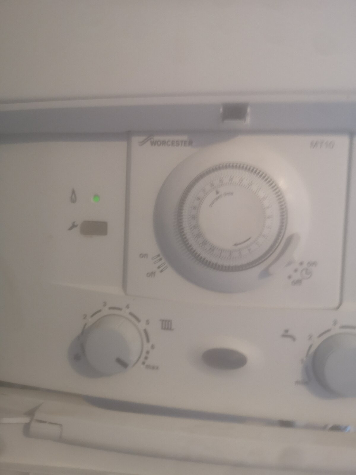

Timer will need to be set to constantly on
Right OK, that's what I've done and the central heating is on perm. Thanks for your help so far, but any other ideas?

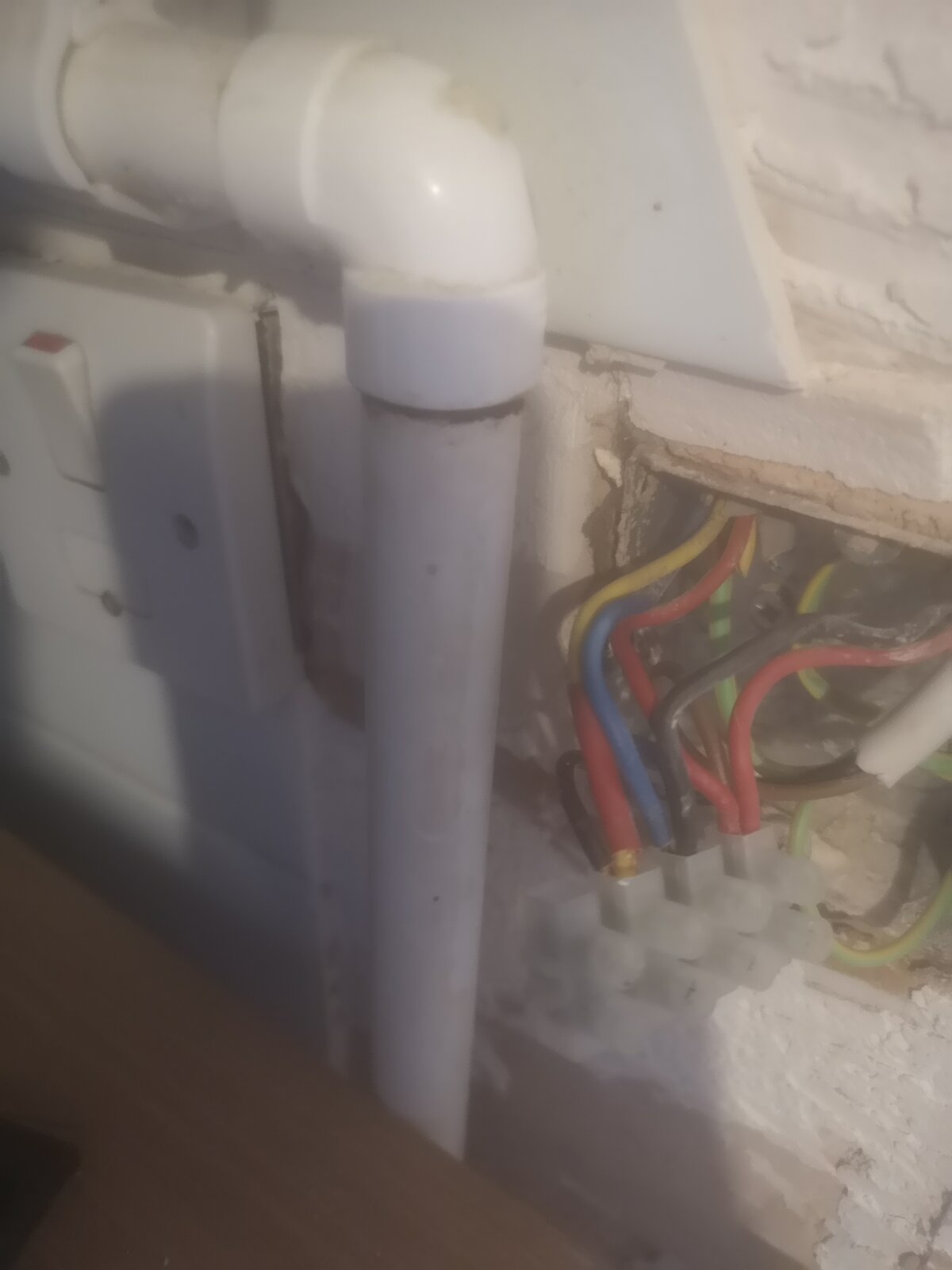

can you post a pic of the wiring at the boiler end and of the front control panel of the boiler
Sorry I meant the terminal strips in the above images. Theres no other thermostat. There was a gravity system in initially but that's long gone.
OK not being pedantic but have changed your post for you so others can see it properly

if you remove the link between LR and LS, do you have enough wires to make one of these to 1 on the hive and the other on 3 on the hive without any links ?
Sorry I'm a bit lost there. Where's the link between LR and LS?
