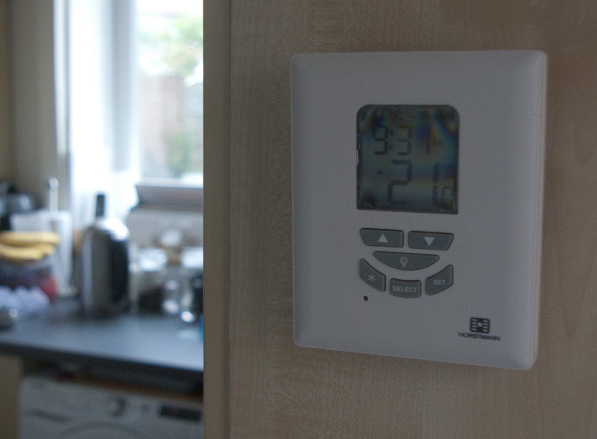

Hi all,
Long time since I've posted here! Just moved into a new home and it's got a Salus T105RF (Wireless thermostat) hooked up to a Glow Worm Easicom 24 boiler (combi). I'm looking at replacing this with a smart stat and looks like Tado is the most widely used and recommended over Hive or Nest these days. The boiler doesn't support opentherm or anything so it'll just be a standard setup to turn the combi on/off.
I've been through both the Tado manual and the Salus ones and it looks pretty straightforward but just wanted to run it by someone else to check I've got this all right.
The existing Salus has NO, COM, Live and Neutral. Am I right in thinking it really is as simple as wiring these to the NO, COM, Live and Neutral sockets in the Tado, or is there any bridging required? I assume I can also use the existing wires without needing to get someone in to open the boiler up and do it?
Cheers

But at end of the day the non modulating thermostat is simply a switch, there are basic two types, 230 volt and volt free contacts, the Salus you show IMGP8037.jpg is sold under many labels, they are known for loosing wireless link, and they do not fail safe, so when they loose the link the heating can stick on, reading the manuals both need a link wire if switching 230 volt, so basic what is in one will go in the other, but I don't know if you are switching 24 volt or 230 volt so don't know if either has a link wire.

Yep, you’ve got it correct with the wiring. The Glow worm would likely support eBus, which I believe Tado can do, but this would mean opening up the boiler, so likely an engineer required.
Thanks for sanity checking :)
I didn't realise the Glow worm supported ebus, think I'll see how it goes without it for now and look at getting a pro in to sort out adding the wiring for that at a later date.
