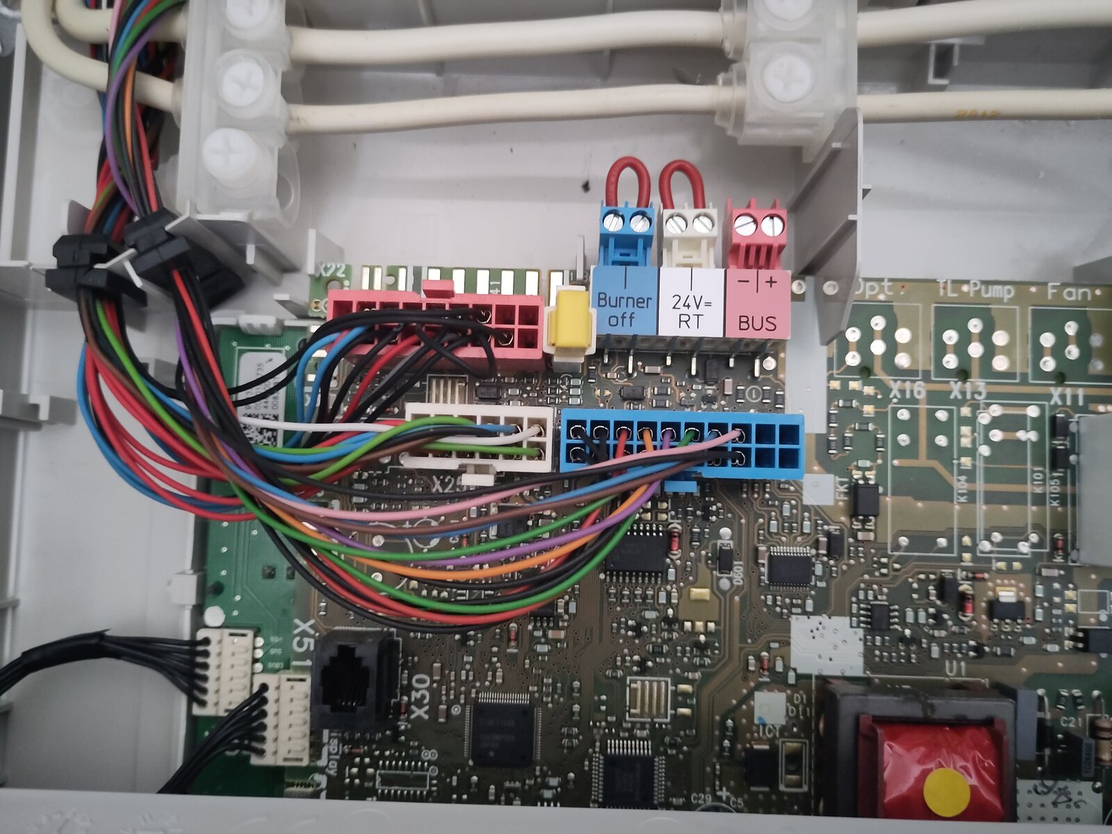

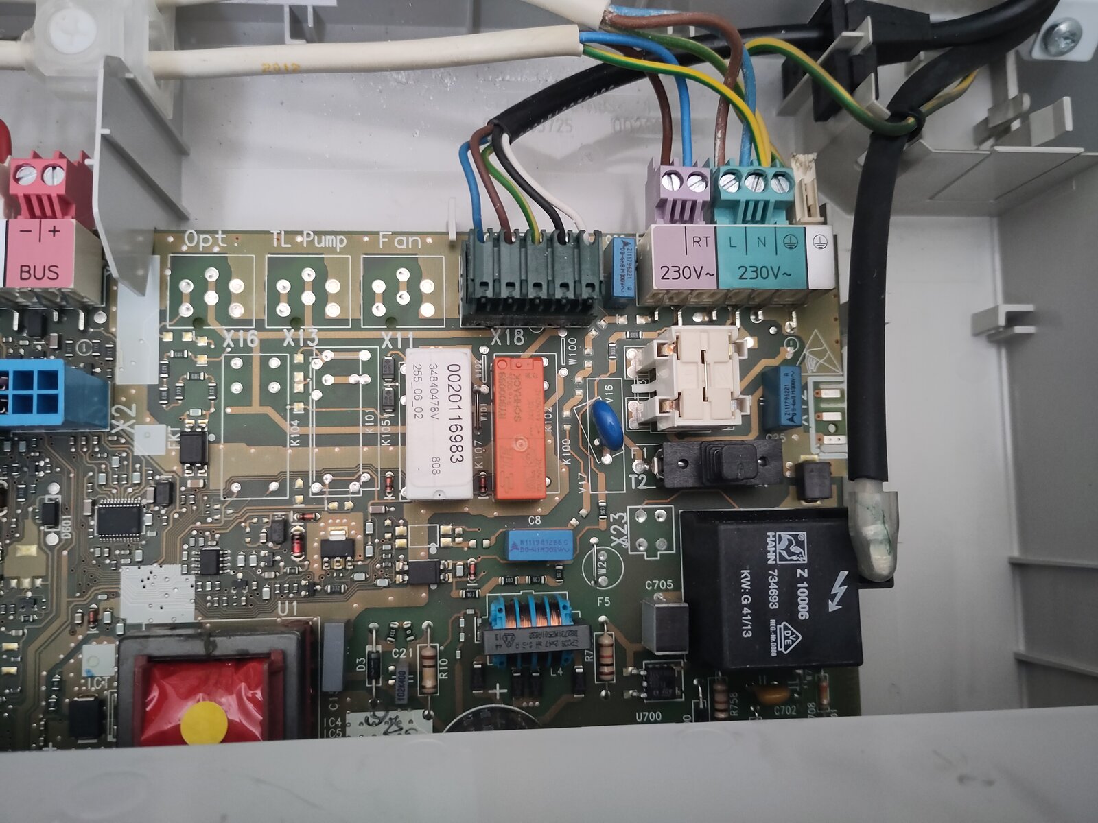

Hi,
I have bought a Tado wireless thermostat to replace my existing Salus that has broken and is EOL.
Following through the Tado instructions when I need to remove the previous receiver there aren't any instructions and it looks pretty complicated. I have attached the photos. Is this something I could complete myself with the correct instructions or best to get a professional to assist?
Thanks,
Fred
Usually, the Tado receiver would simply replaces the Salus receiver, no need to touch the boiler wiring. If you need any further assistance, post details of the new Tado Receiver and Salus receiver that you have already.
