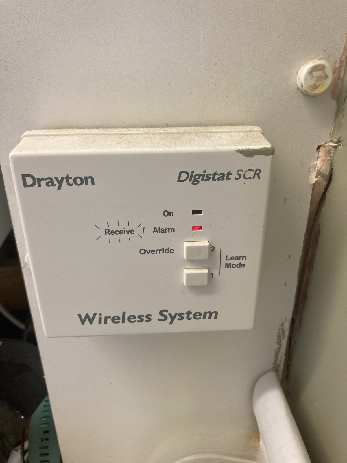

Hi. We have a Drayton Digistat wireless system. It barely works now because the thermostat part keeps cutting off, and has no timer on it. I want to replace it with one I can control from my phone. I'm not looking for anything super fancy like a Hive system, I just want to be able to log on from a phone and turn my heating up or down, set the timer etc.
I can do basic DIY, but I'm a little lost as to how the current Drayton system actually talks to the boiler, and if I need to replace the wall-mounted, hard-wired bit, or whether I can get a new wireless thermostat and connect that to the existing set up.
I was looking at something like this but have no idea if it's the right sort of thing: https://amzn.eu/d/hft5z31

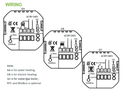

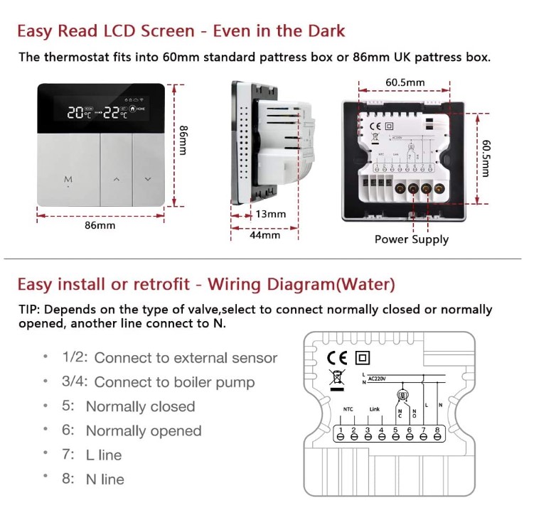

The thermostat you linked to is mains powered and has a call for heat link back to the boiler, so you need to pull a 5-core cable from where the thermostat is sited to the boiler.
Be careful with Moes to get the right one
